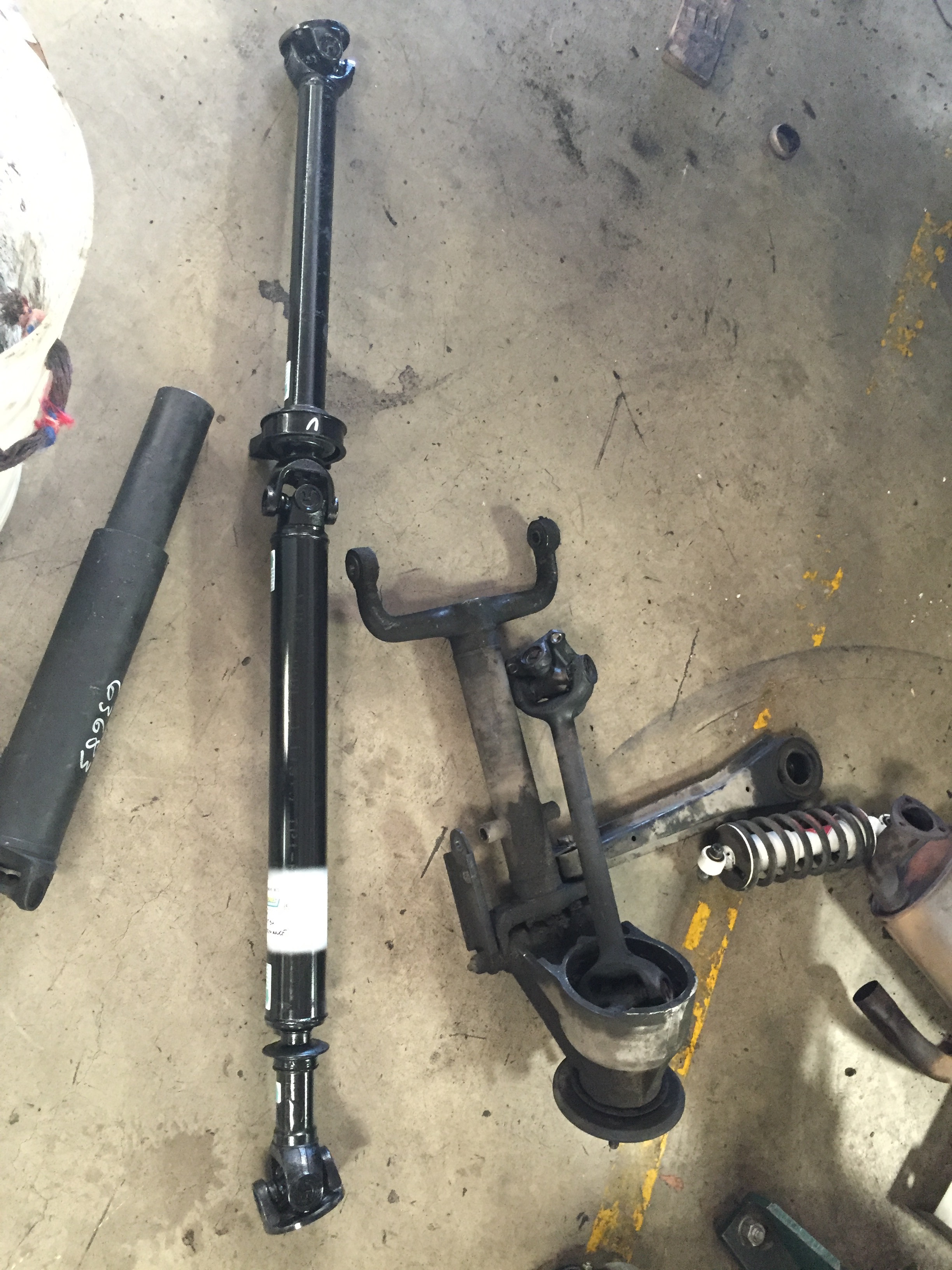

Lol, thought that may catch someone's eye. Yea, brought it in to Drivelines Inc. They are local and do nothing but driveshafts. Mostly do a lot of hot rod work here in so cal. I have used them quite a bit, they simplified, lightened and balanced a shaft on our 1975 Spitfire which will now run the freeway at 85mph with nary a vibration. Any Spitfire owners will attest how rare it is you can do that today.
I didn't get a chance to talk thru the final rebuild yet, but he gave me three options, first just rebuild the internals which he said were completely gone for about $350. Second, replace all the u joints, which it didn't really need which brought cost up to $425. Though he warned me that because of the design, he could only spin and balance unloaded. His 3rd option was if he redid one of the yoke tubes (guess it has two and he said we could run with one) he could much more accurately straighten and balance the unit, it would be smaller in many of tight clearance places and the whole unit would be significantly lighter. I should prob ask him what kind of weight savings we got.
I went with number 3 obviously. $533 including tax. Prob shave at least 2 sec on my 0-60... Lol j/k. Just hope the noise goes away! So far nothing else in rear is suspect. We already checked all the shields and exhaust movement which was my initial thought.

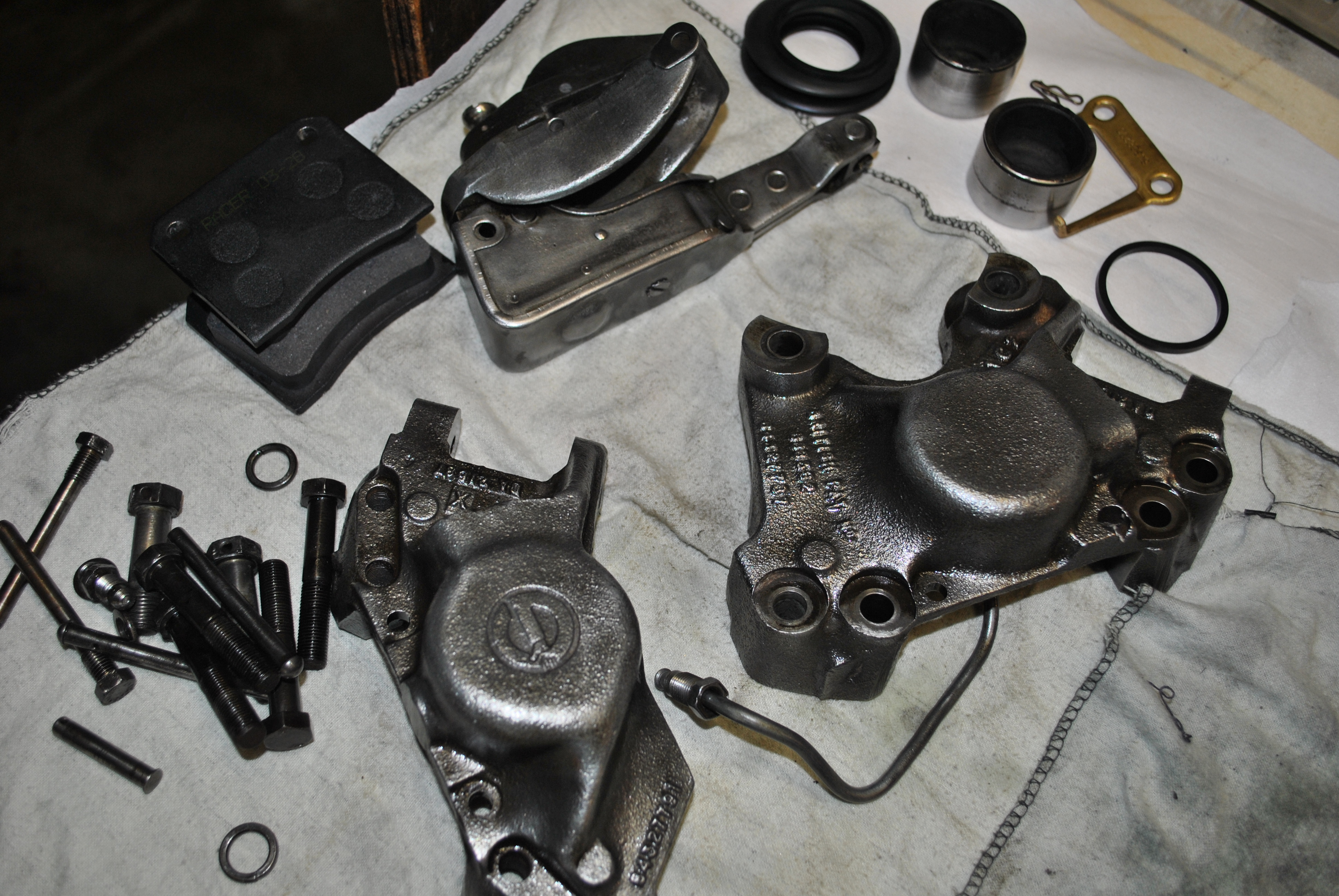

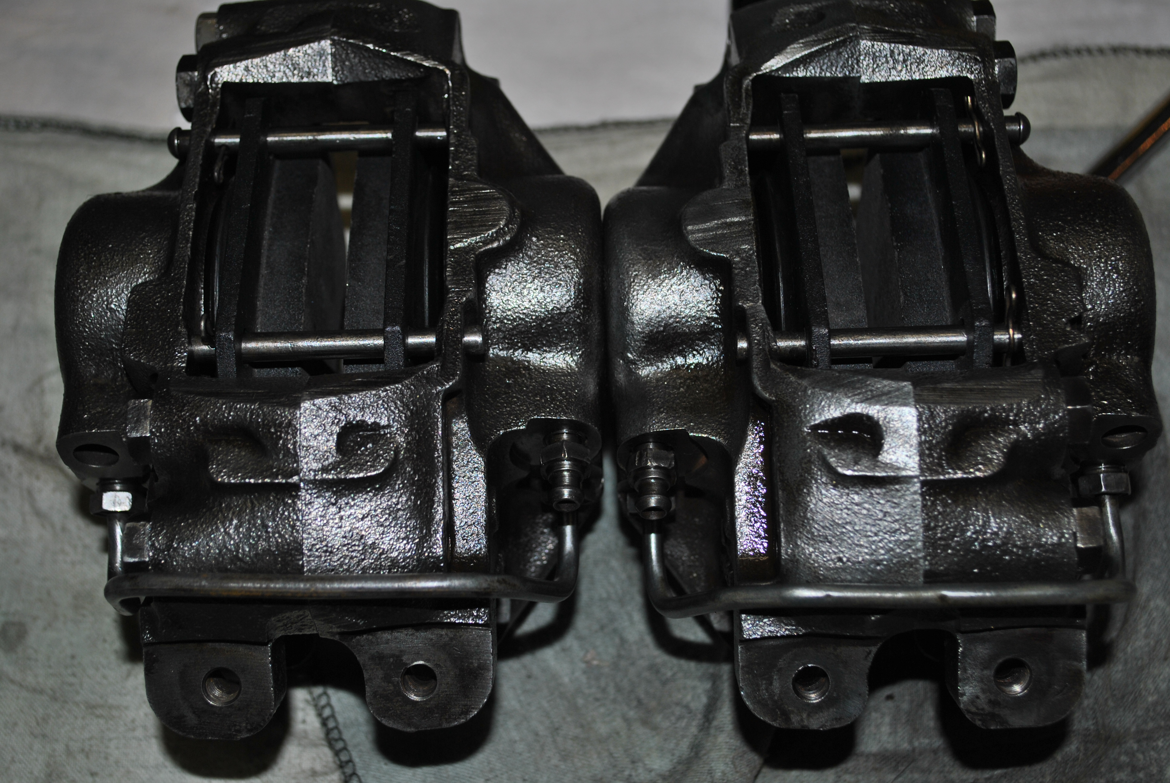

While we were at Other things, my rear calipers spontaneously leaked out all the fluid in the system! I was NOT pleased to find that. They had not given a Moment's trouble or warning to that point. Nothing in the rear end had been on the schedule, but obviously that all changed.
So, If your calipers are original with your car, I would Strongly recommend changing them for new, as rebuilding is said not to be an amateur friendly job.

I will say though, because of the work involved in changing rear calipers, I wouldn't use anything but New (not remanufactured), because so many rebuilders *in OUR experience at least* do less than stellar work and failure rate is high. I'm sure there are exceptions, but I don't know any.

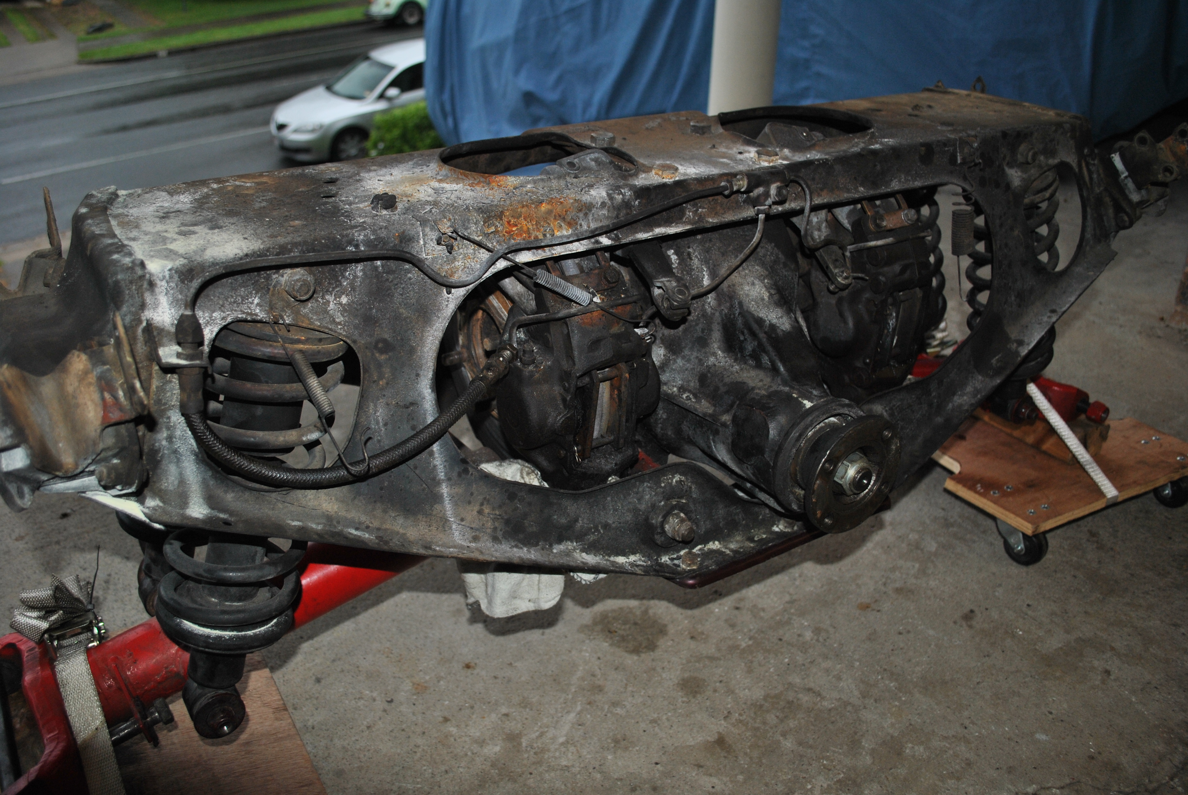

The location of these calipers is a big factor in making your decision, as they are so inaccessible, so once fitted, you don't want to have to get in there again, or, indeed, have to drop the subframe too soon after a rebuild. For the front calipers, being easy to get at, the decision will likely be different.
If it were me, I would go for quality rebuilt items, or even new if you can afford it. Make sure, especially, that the handbrake mechanism is mostly all-new and well lubricated. When I had a rear caliper piston seize up and heat the whole shebang up so hot I needed a new diff seal, I replaced with rebuilt calipers from a local supplier that were a good price. That was an unforgettable experience, with the pedal going to the floor and white smoke billowing out of the rear wheel arches !! Despite this, we manage to complete our journey after a cool-off period and finish our holiday. We just needed to top up the fluid reservoir every 100 miles !!

No, still has the joint. What the shop told me that did the work is that these cars have a tube in tube design. That was what was eliminated - guess it took about 5 lbs off the weight and makes it possible to more accurately balance it.

I have also read that every pound of weight saved in the rotating driveline = 10 lbs of carry weight. So shaving 5 lbs off the shaft should be same as if I lost 50lbs on a diet!! which aint going to happen!
