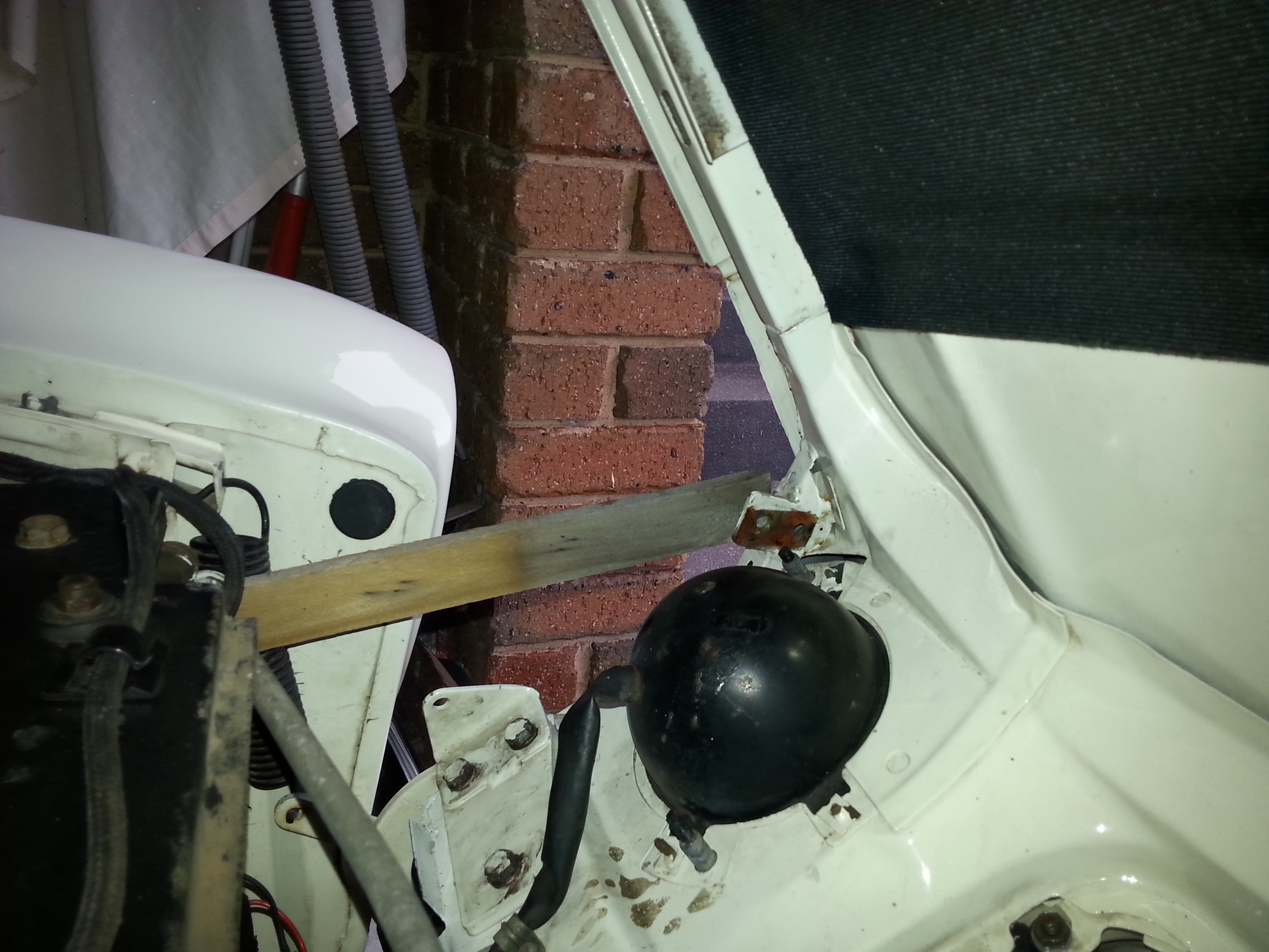

Having been frustrated many times by the bonnet's limited opening I saw a pic in another thread this week of one with much wider opening. Inadvertently I briefly hijacked the thread (which had nothing to do with the bonnet) by mentioning it!
Anyhow, I had long been aware of the idea that removing the safety linkage would allow the bonnet to open much wider, but had the impression the grille would foul on the bumper. I've now removed the linkage and find that opening up to just a bit under 90 degrees works brilliantly - no more stabs in the back by the catch pin!! There is still a tiny amount of space left between the grille and bumper trim, so no damage there either (not sure how this would be with Series 1 & 2?). If I open it up outside I will use a rod/stay as insurance against the wind having its wicked way, otherwise I'll confine any bonnet opening to the garage.
Thank you to Elinor and Carl for their encouragement to try this.

I had similar thoughts but along simpler lines: Something like a short rod that pivots from the linkage connecting bracket on the bonnet, the other end would manually hook to the rad support. The rod could fold back onto the bonnet when stowed. The stick in pic.1 gives a crude idea, but I'm thinking of a solid metal rod, about 10mm diameter with an offset dog leg at the bonnet end allowing it to fold into the existing channel on the bonnet's inner skin.
With the bonnet open as in pic 2 the gap between grille and bumper is about 7mm.
