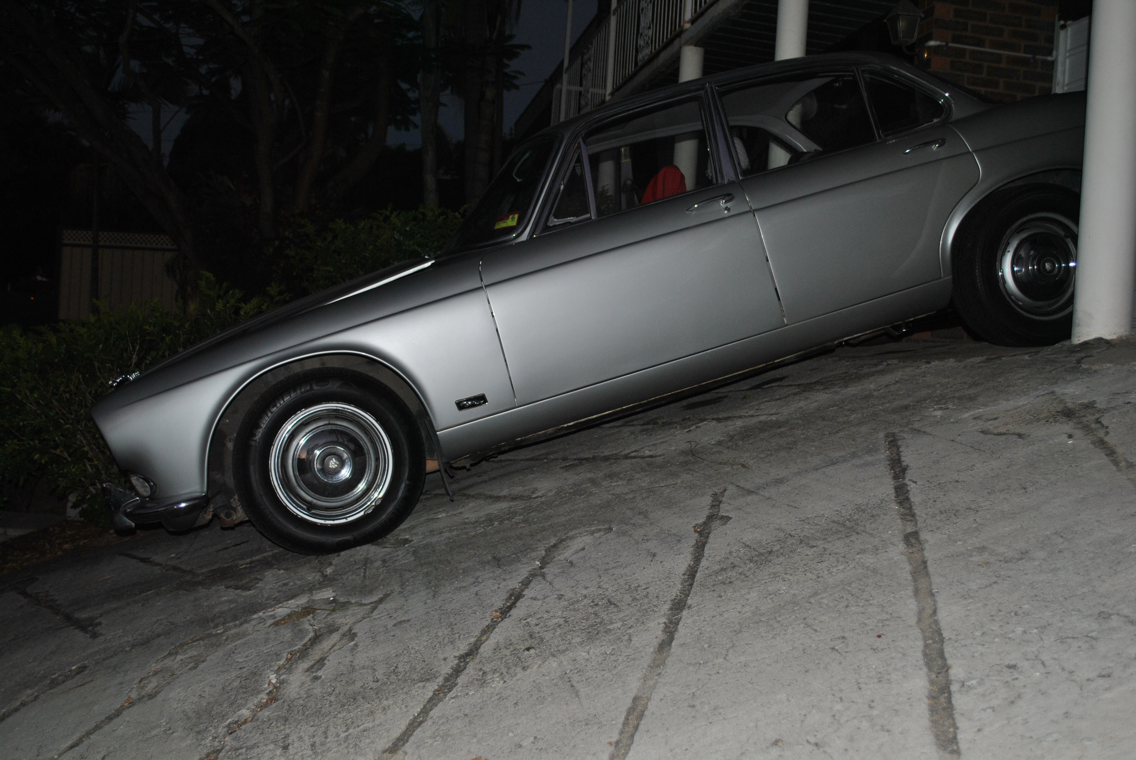

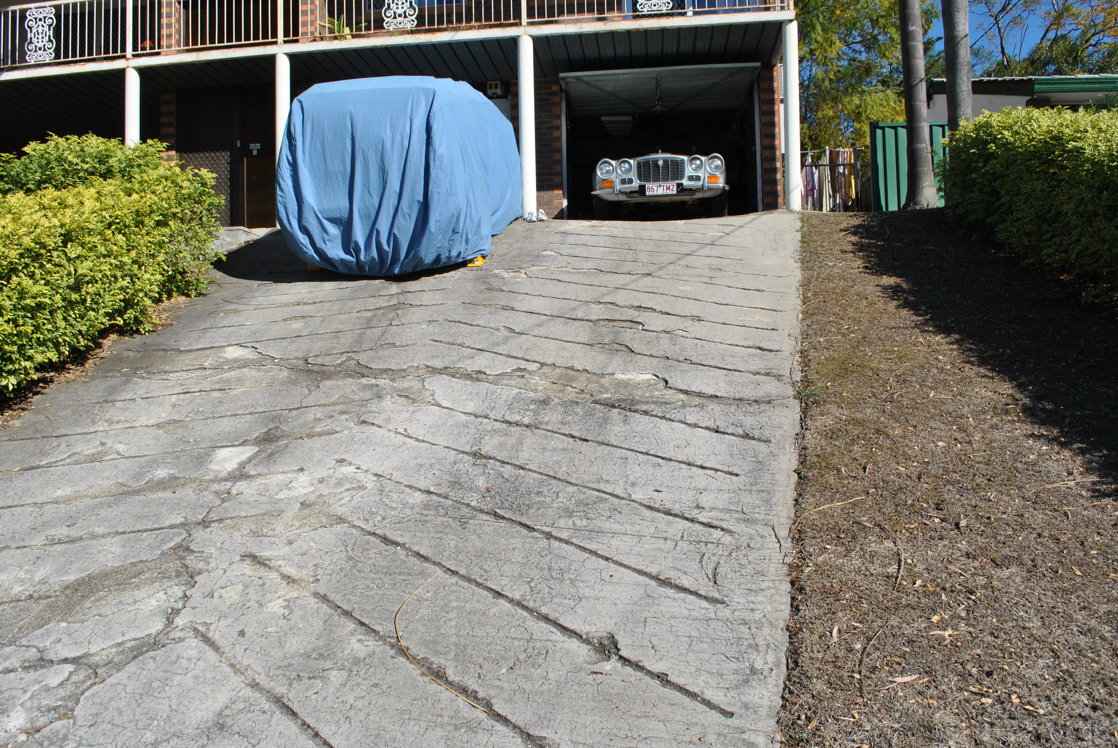

I do a fairly rigorous brake test every time I leave the house before I get to the road. Hasn't failed me yet ,thank god.
Not really sure what I would do if my test failed. Been lucky the last 18 years with this driveway.
Attachment 125691Attachment 125692
Hi, looks like u must live in San Francisco! It was the seals in the master cylinder. I fitted the spare me and it was fine so have ordered a repair kit as the m/c I fitted has done more miles and is approx. the same age as the one that failed
