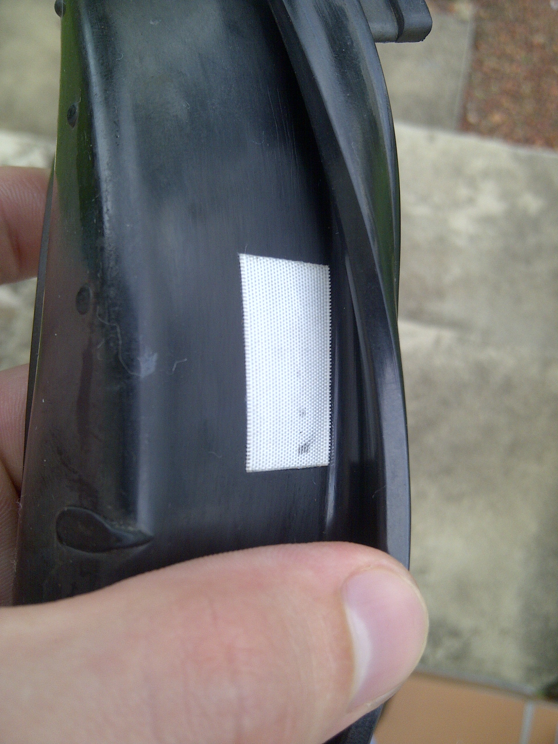

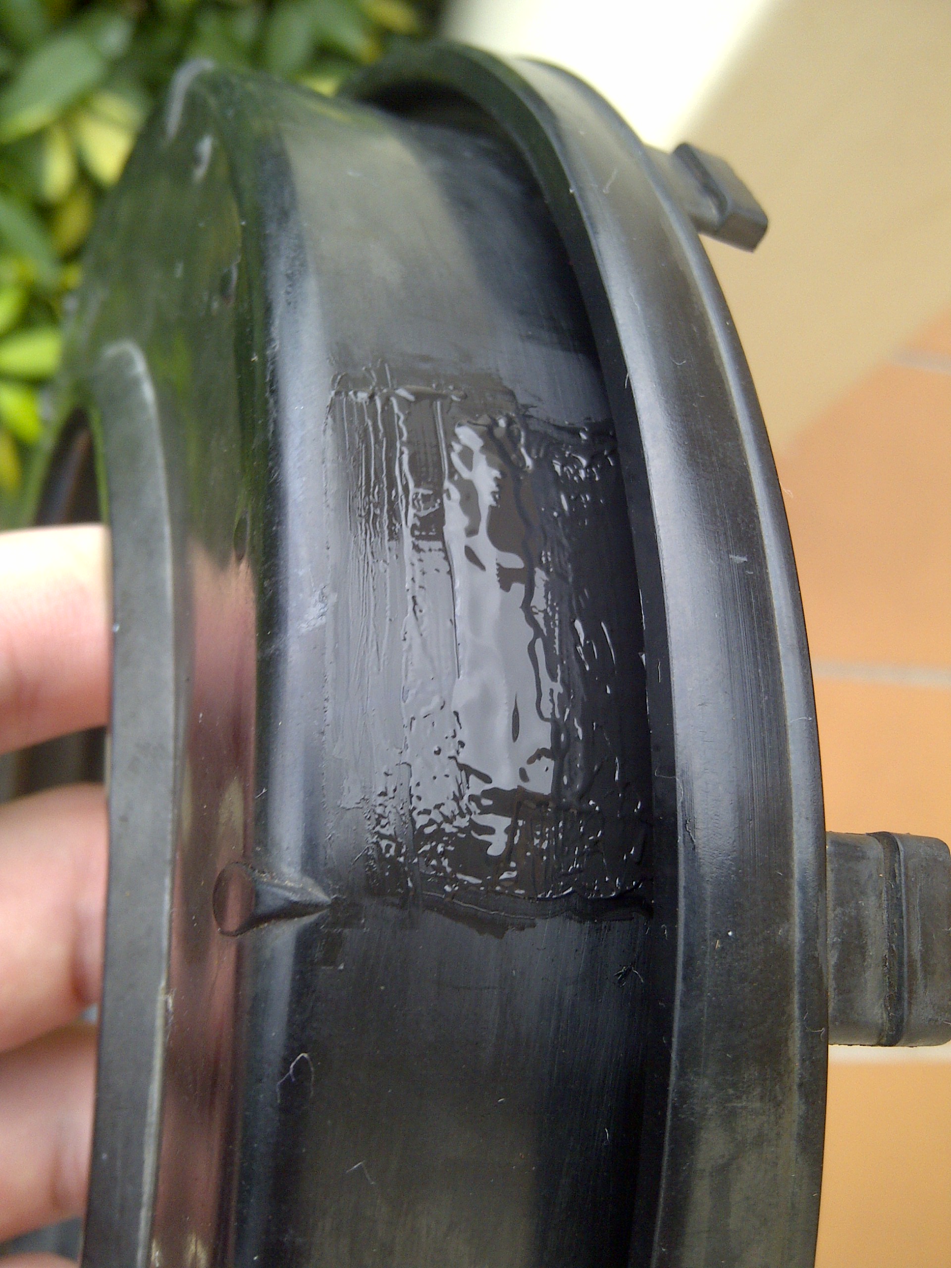

Right so I tackled the job myself, took the booster apart, fixed the problem (slit in the second diaphragm, unknown cause) and put everything back together. Learnt a lot too.
If anyone wants to attempt stripping one of these boosters themselves, feel free to send me a message, email or whatever. Not as hard as it looked.
Cheers.

Old Feb 22, 2016 | 07:31 AM
NathanDD6's Avatar
Joined: Aug 2015
Posts: 646
Likes: 52
From: Durban
As per your request Lagonia.

OK I think I'm going to try tackling this today or tomorrow due to the rain.. I'm not quite sure about what you mean when you say to use a piece of wood to twist it off but maybe once I actually get it back in my hands I'll understand a little better.. And what type of sealant did you use when repairing the slit in the rubber.. Will a plain ol innertube repair kit suffice..?

I used a sealant from Liqui Moly, don't know what you have in your part of the world. Yes it should work, depends if it has to flex or not.
