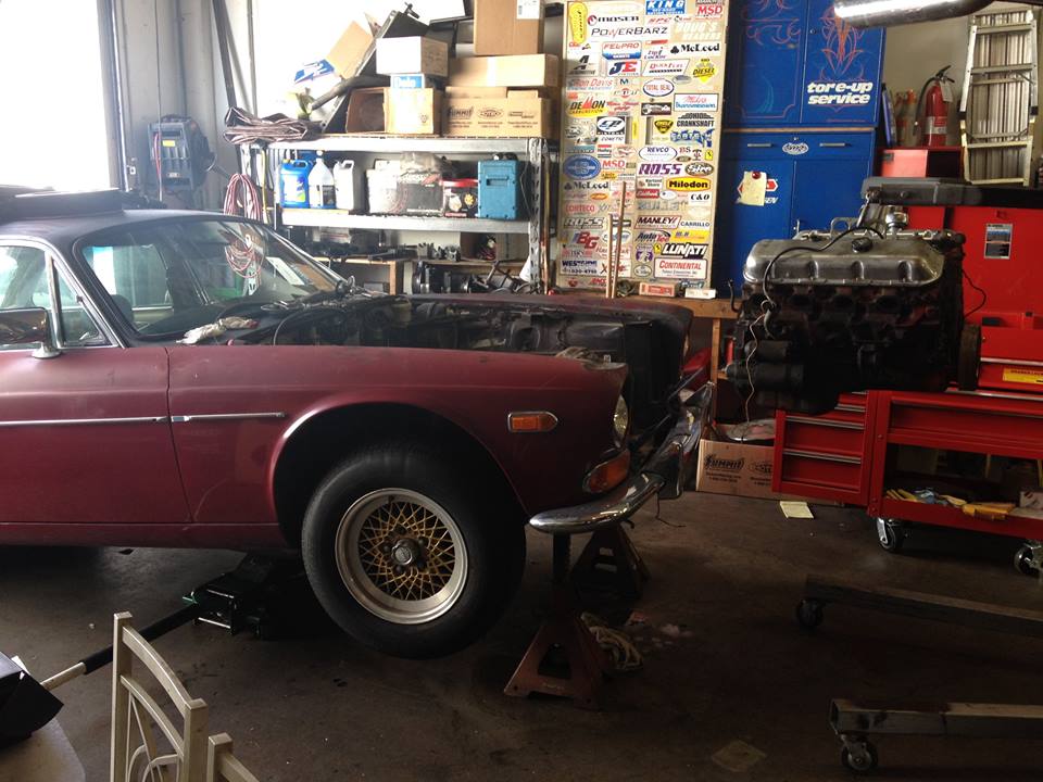

Pic of the old 454 coming out, rock hit pan while driving through canyons, pickup fell out of oil pump. lost oil pressure. added 4 extra quarts of oil, regained pressure, was able to putt it home and eventually to the Shop. Substitute motor going in while this one is worked over.

I hope it all works out for you, you certainly have the shop space to do the work.
BBC worked over. That should be special...stop teasing, what cha' planning.

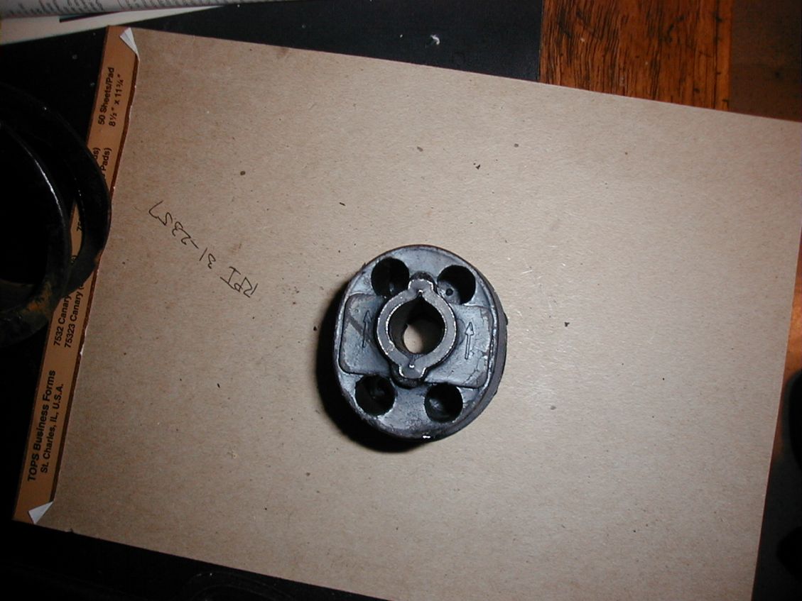

Here are photos of the new rubber pieces from a Dodge Van...easily sourced. Very soft mounts and barely do the job intended... R&R them and then peen the edges over to hold them in place.
Having had Lumps with Suncoast, Mundorf and John's parts... the best choice is the Suncoast mounts and using the stock GM rubber pieces... especially with any engine with power as your big block...

Sorry, but I will not be back home until the 17th to check my records
for the motor mount specific model...
My "memory" says a Dodge Van, but.... they are crappy mounts to start
with and the original rubber is not great. The replacement rubber I used
is still working/looking great.
You are correct though, John mounts are farther forward compared to the
Suncoast mounts, had to cut off my driveshaft and adjust the trans mount.
But, the rearward change worked well as it made the balance better...

I paid $8.49 each in 2009, today they are even less (they know what they are worth!). Was at the bottom of the receipt box for this particular car...
I updated my Excel sheet with the part number for future reference.
According to the Napa chart they fit various Plymouths/Dodges...from 1963-1975.
The mounts are still working in the 1972 XJ that is almost finished --- only some upholstery work is left...hurray...yes I sold it but have stupidly
helped the new owner finish it up... it is actually going to the upholstery guy on Monday!
