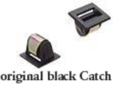

to remove the tray's Lid Catch, you need to pry it out very carefully, otherwise you can easily crack the tray. Also you can try to wrap thin fishing wire around it, to pull it out. Or try to push it out from below, but I've cut myself trying to do that, there are razor thin edges in the console's metal frame.
if you break the original Catch, go to any Maytag Appliance store and buy a Dryer Door Catch Kit, same part except for color.
