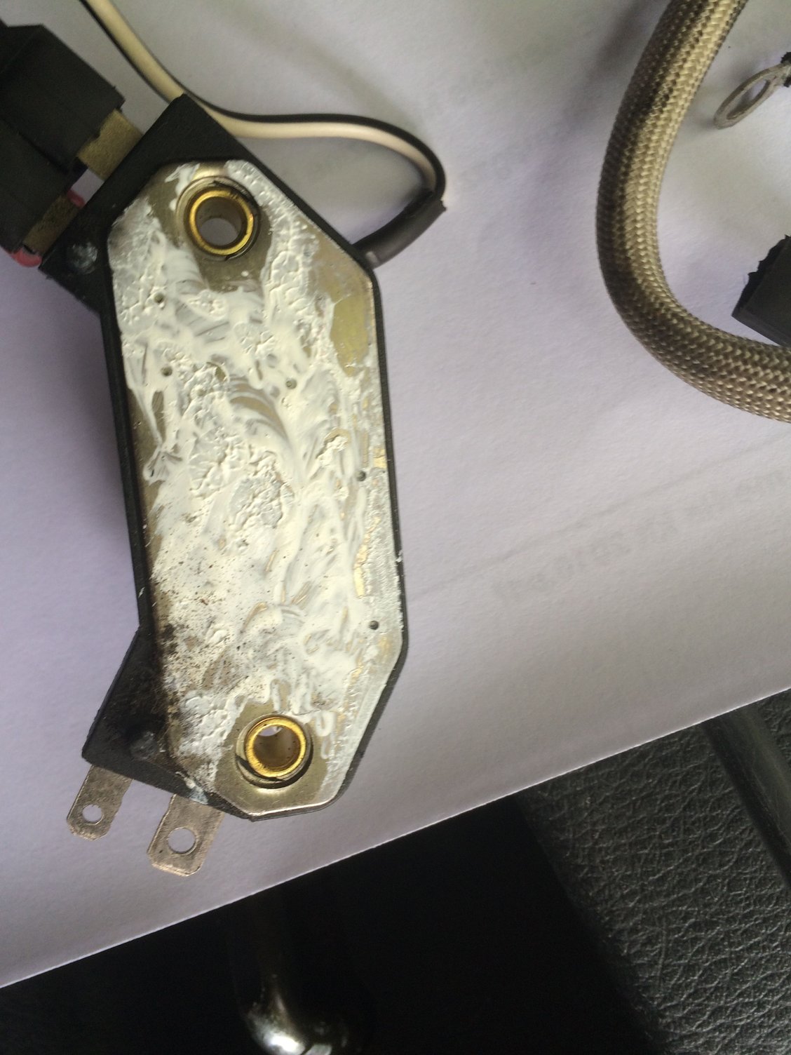

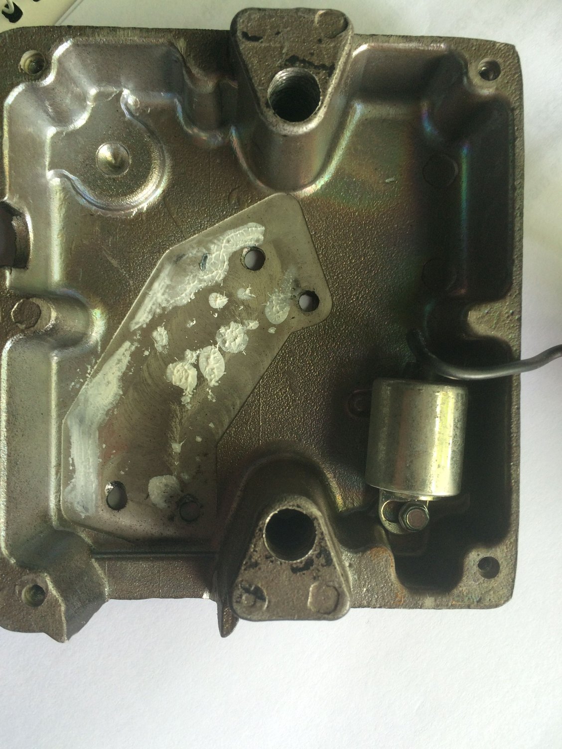

If resistance with ohms meter is OK then I would look at the ignition amplifier.
This is located on the front of the inlet manifold.
Two long bolts secure it to the forward face of the manifold.
Amplifiers are not cheap, however, if you unscrew the four locating screws (easy if fiddly job), you can replace the module which is pretty cheap.
