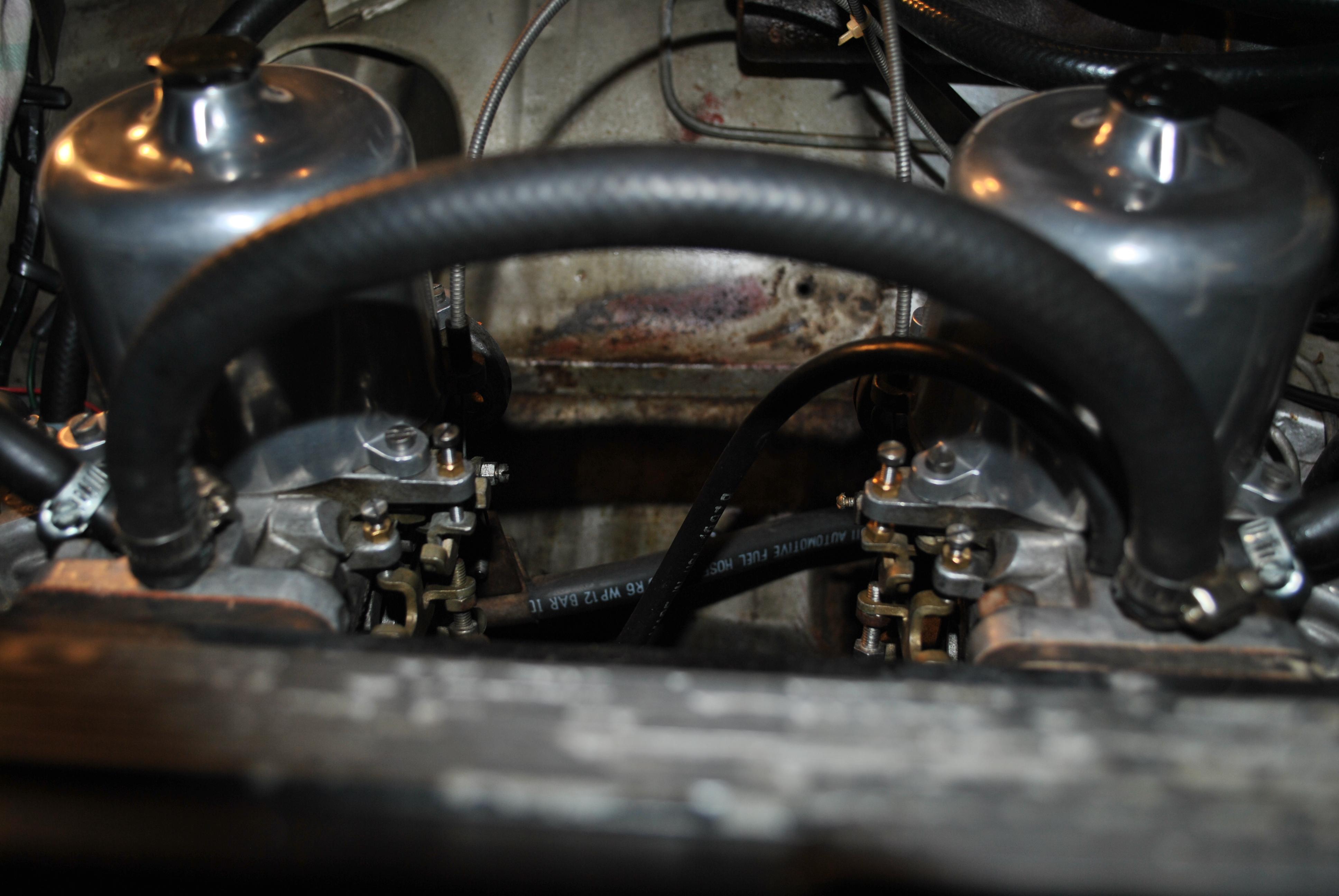

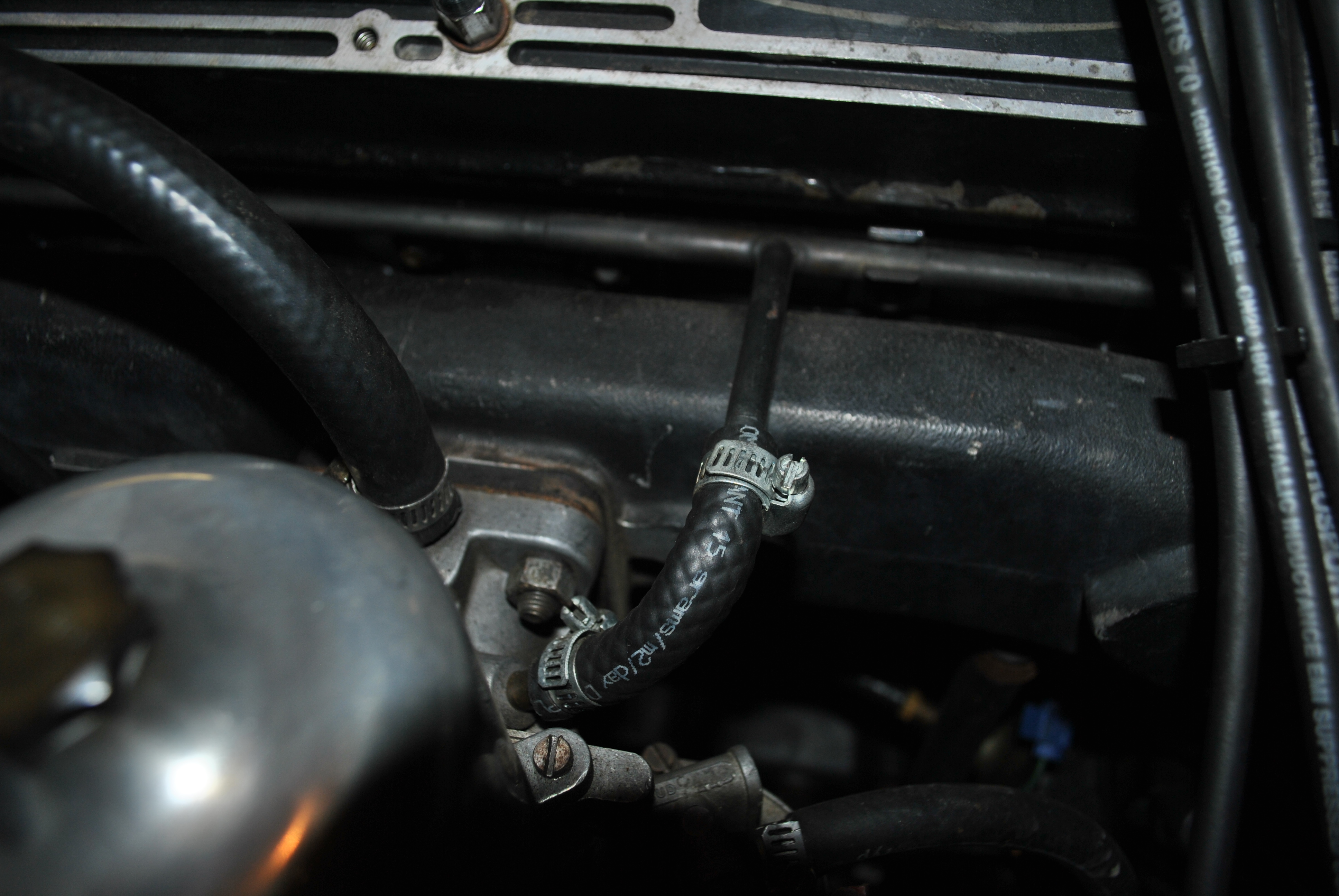

Here is a couple of pics with the balance pipe, your carbys look like a different model to mine(maybe HD8) but hose work should be fairly much the same. The two smaller hoses to the outside of the balance pipe go to the crankcase breather at the front of the engine.
