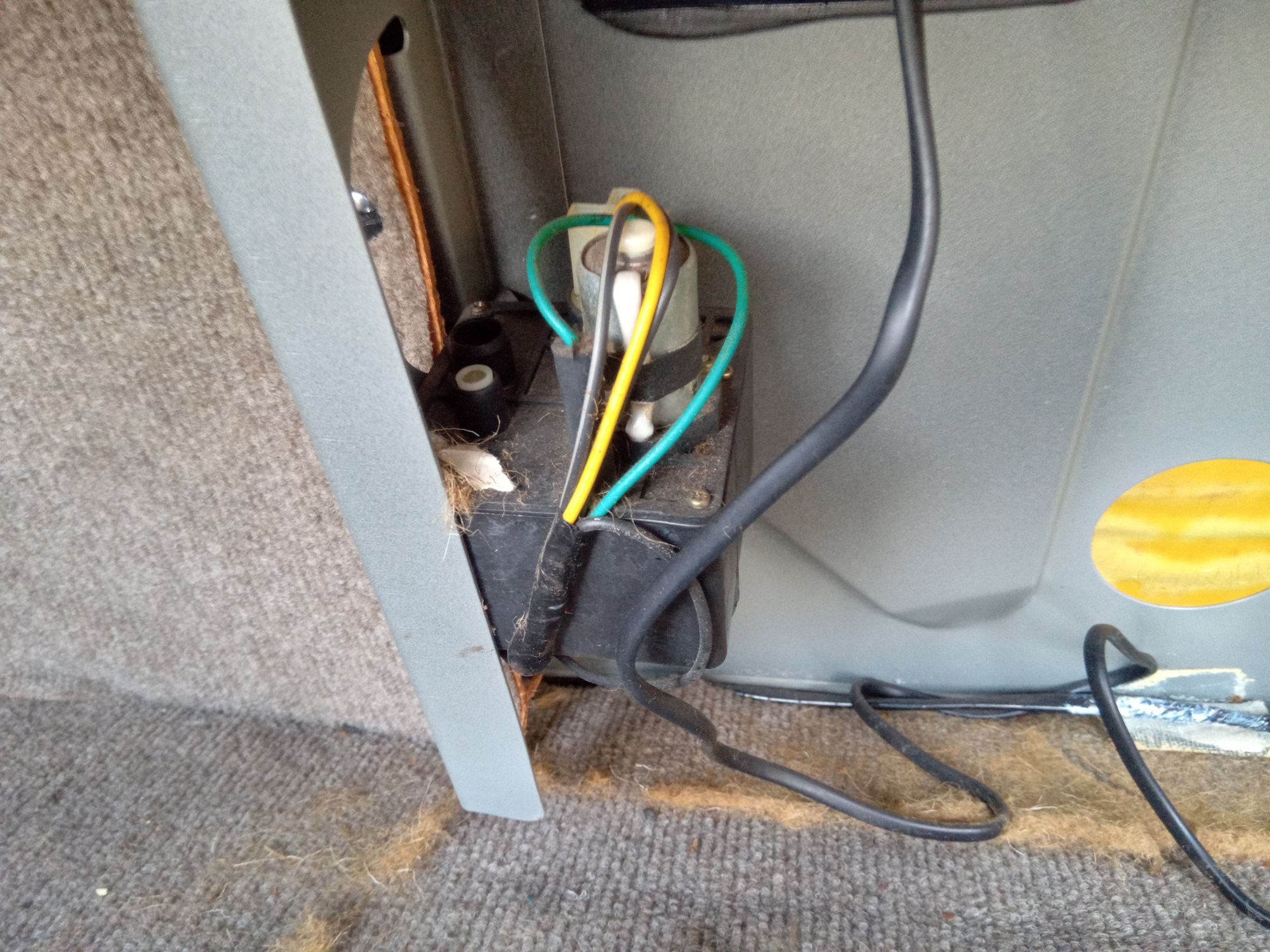

Hi Doug
I have changed the ECU, air filter element, sampapered the temperature sensor to clean the dirt from it.
Please which of these in the photo is the trigger unit?
Old Nov 3, 2021 | 07:08 AM
Doug's Avatar
Posts: 25,529
Likes: 11,724
From: Pacific Northwest USA
It's the box-like unit shown clearly in pic #3. In pic #1 it's the unit all the way over to the left. There's a little button. Use a pointy tool (like a nail or ball point pen) to push the button. You'll hear a click.
This will extinguish the warning light but has no effect whatsoever on how the engine runs.
DD
DD
Hi Doug,
Per your instructions and procedures, I have been able to reset the oxygen sensor and the light is off now
