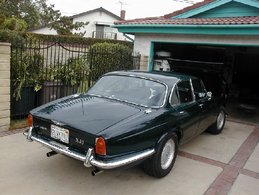

I notice less fumes and it is quieter... of course the Jag tips are smaller OD. PO had even welded up the exhaust holes... I put on a new rear valance panel and the muffler shop modified the exhaust to allow the tips to fit.
My next exhaust change will be to run the rear section under IRS like a Corvette.. did it to my old '72 XJ. Only this time instead of flanges I will use stainless V clamps.
But, I like the looks and sound!
