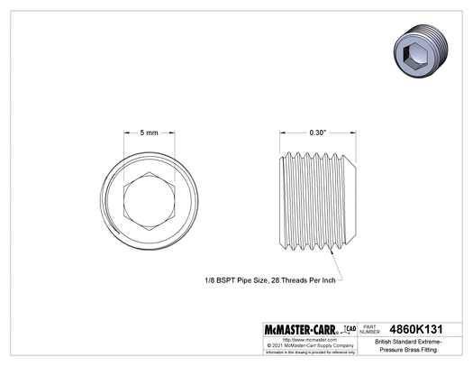

But the intent would be to keep all of the working parts so everything could be put back to stock if required. The only thing I have to research, and I am sure others have already done this, is what to use to plug the air rail holes in the head. I believe I read somewhere brass plugs could be used.
Just found this on Jag Lovers.
https://www.mcmaster.com/4860K131/

I used those mcmaster carr hex drive screws on an '84 and they were the perfect fit. I think the benefit of removing the smog equipment and de-cluttering the engine far outweighs any speculative impact on resale value.

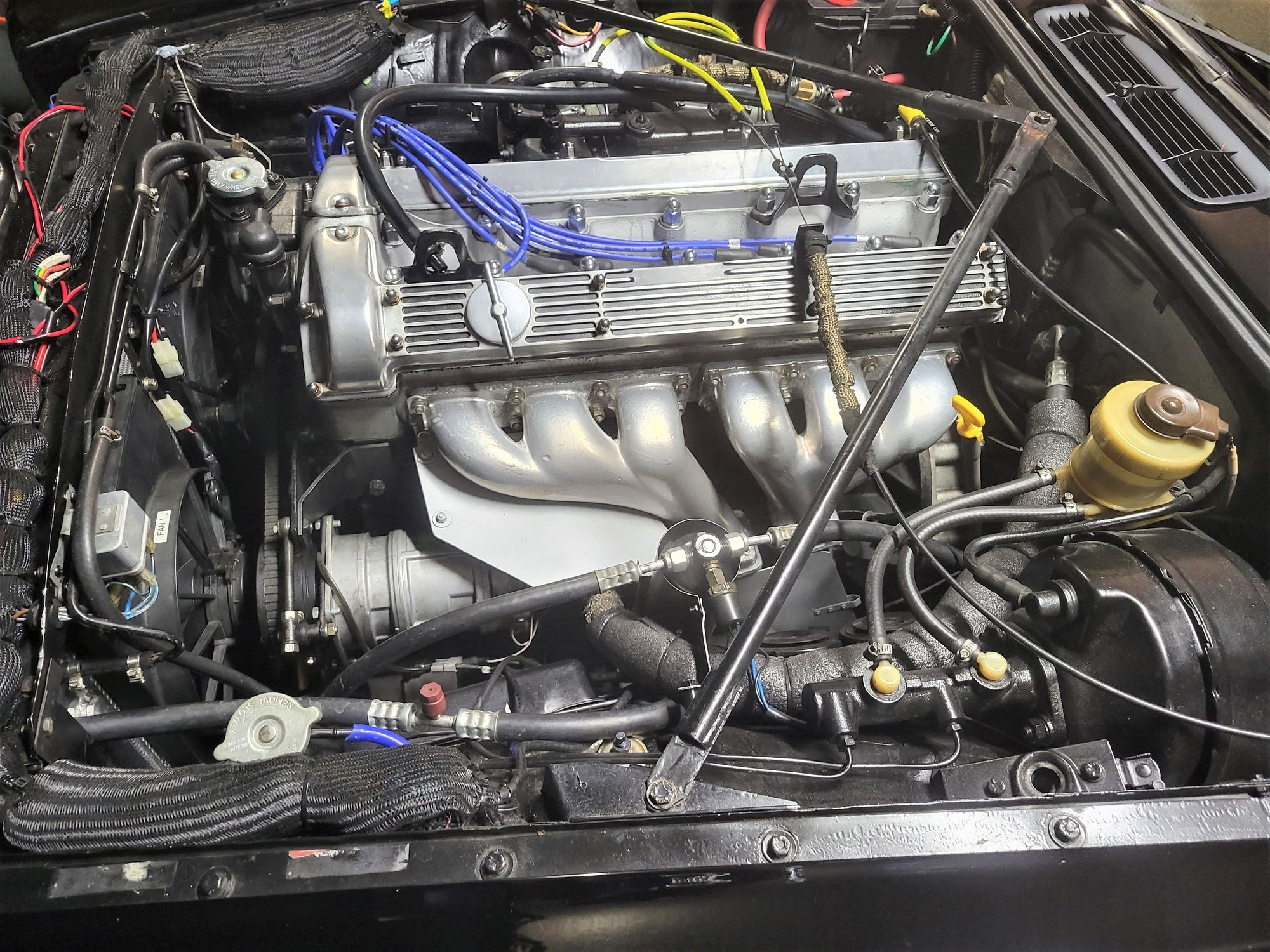

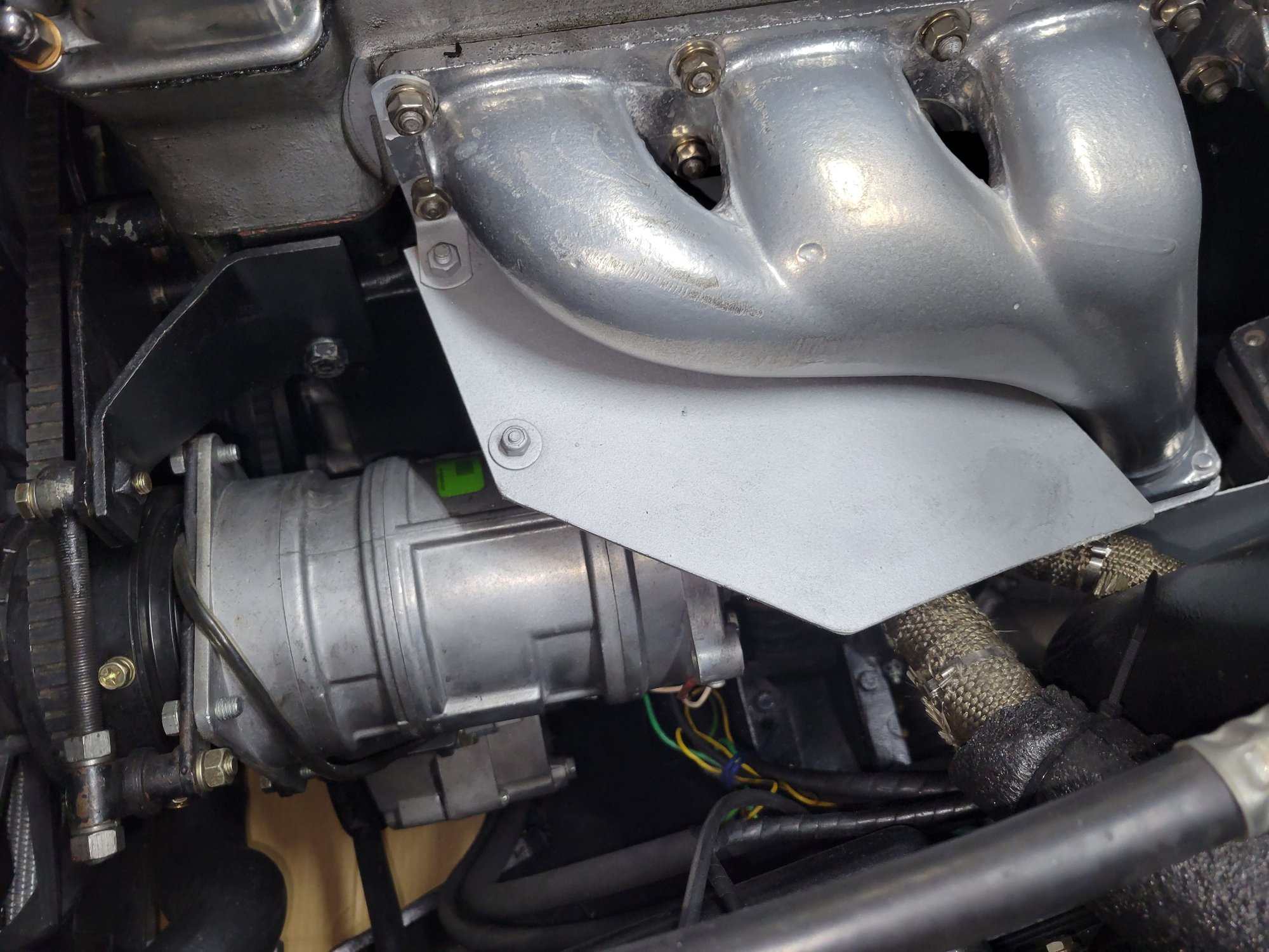

This is what de-cluttered looks like:
Hot side
Cold side
Old Dec 7, 2022 | 09:31 AM
Hot side
Cold side
Ive been considering removal exhaust manifold heat shield. Any issues that I could encounter considering my manifolds are bare iron and not coated like yours?

PS, the plugs from McMaster Carr fit perfectly.

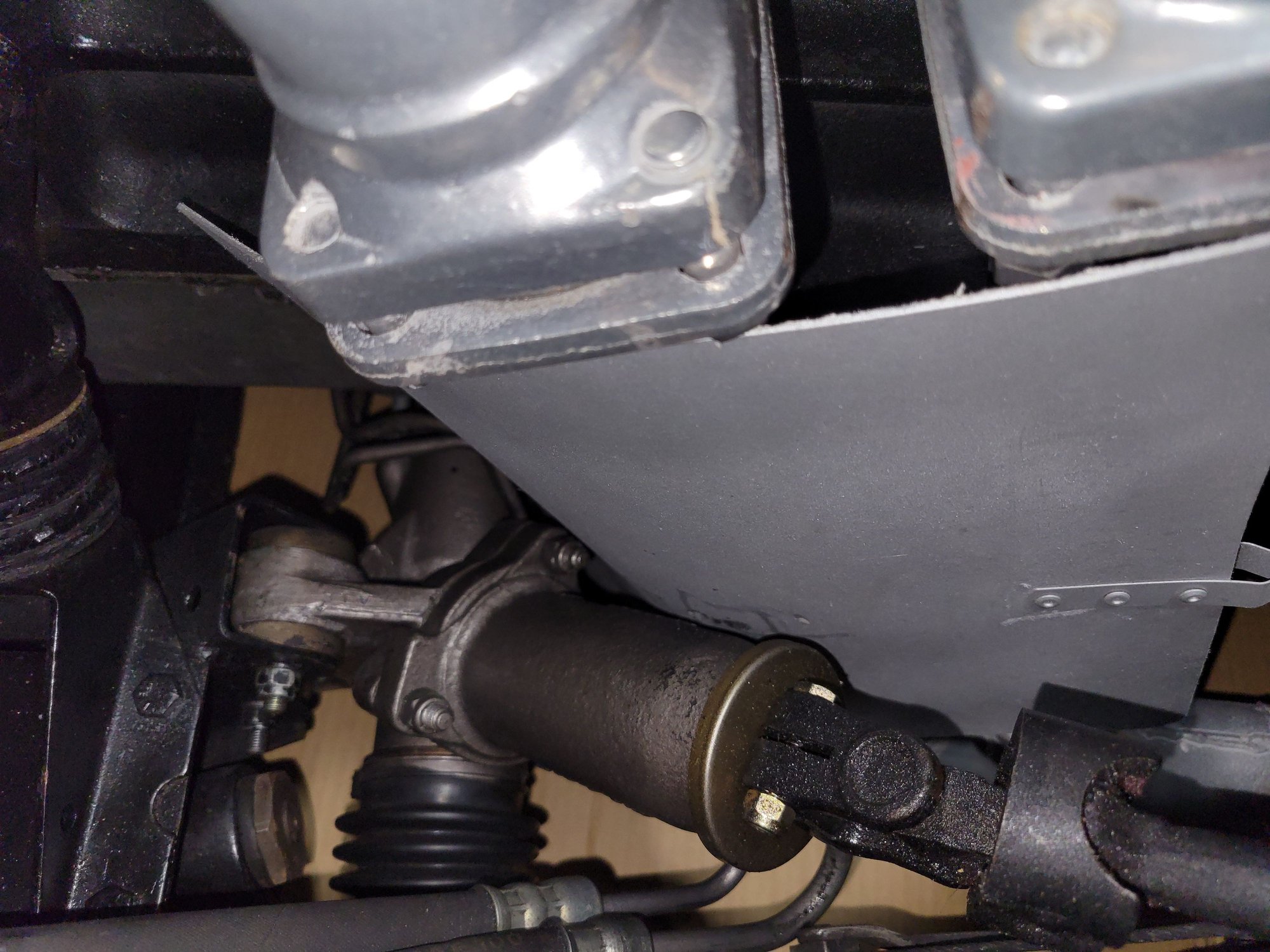

Yes, I removed the heat shield, but note that I fabricated a two heat shields out of Mr Gasket. A sheet of exhaust gasket material available on EBay. One is protecting the A/C Compressor and the other the Steering Tower. And I wrapped a couple of the A/C hoses with heat shield wrap. I have no issues.
