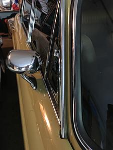

Originally Posted by Daf11e
It's interesting I would find it difficult to drive with only one mirror today........"the things we did without in the past!"
I don't really notice it around town, being a motorcyclist I shoulder check every move left or right when in town so from habbit I do it in cars as well. But on the highway you know you are well clear on a bike so the last two days I have been looking for that left mirror constantly driving the XJ6 in overtaking lanes.
I am condidering trying to source a matching LH mirror from the US. But the size of the series 1 mirror is so small you have to move your head around to get a good view even from the right mirror.

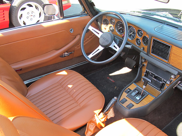

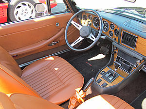

Saw this old post and I note that these non electric remote mirrors with the toggle seem to have been standard British Leyland issue across several of their brands as well as for several other makes.
The USA spec Triumph Stag had these as Factory issue on the drivers (LH) door as standard spec around the same time as they were fitted on the XJ6 early c1970's.
A USA Triumph Stag of course is a LH drive vehicle and I would say you could have orderd one for the passanger RH door also if you wanted to in the USA at the time; perhaps the same option if you had bought an XJ6 in the USA at the time. No such choice here in Australia as Leyland Australia made us do with the ordinary fixed mirrors for the Stags.
I noticed the Daimler Double-Six Vanden Plas Series 1 came out standard with these mirrors - one on each door.
I would love to know any mounting instructions as I would think I could adapt a pair I have secured to install on my Stag.
I have filled in the old holes on the drivers door where the old fixed mirror sat; they have different mounting position.
I am missing the black plastic gasket as well on one of the mirrors as well and unfortunately seems hard to find..
Attached Thumbnails Door (wing) mirrors-mirrorusa.jpg   Door (wing) mirrors-mirrorusatoggle.jpg

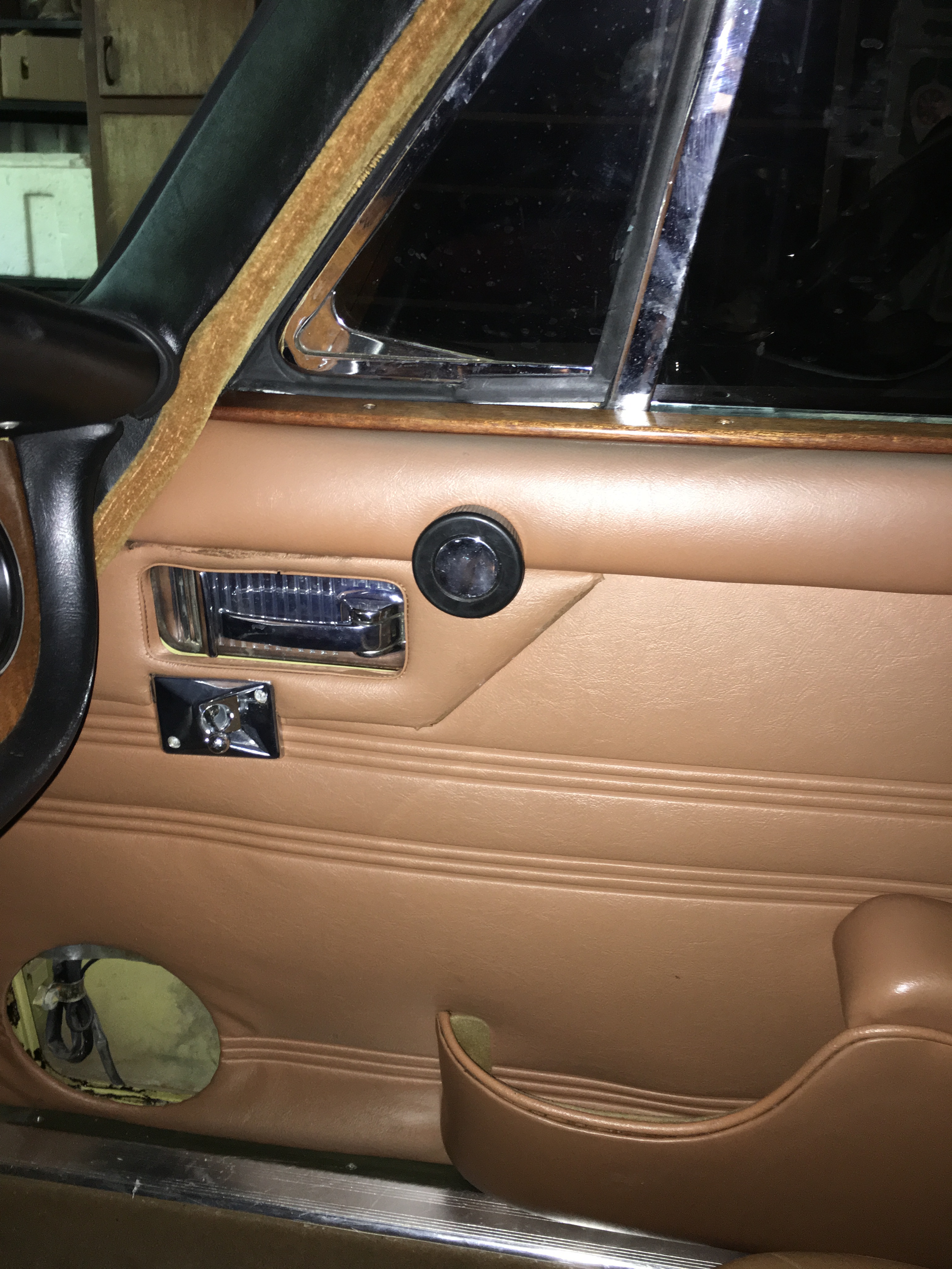

This thread interested me because only last week I added a RH mirror obtained from SMG Barrett for $200.00.
I wasn't sure about correct location, but in the end decided for symmetry and mounted it with exactly the same positioning of LH mirror. It looks great and functions well and I'm very happy with it.
I had to make a few modifications to Gasket to get it to sit with the same angle as LH side. To start with, the Gasket included with mirror was for a LH side mirror and thus upside down. The difference was small enough that I decided to go ahead and mount it anyway. I used a dremmel tool to cut a groove in the top edge so the mirror would sit down in the gasket to get the correct angle needed to match LH side.
I was surprised after removing the door card that there were no pre drilled holes for the adjustment cable. I had to cut hole with Dremmel wheel to adapt.
Cutting the door card trim was a little scary but it came out good.
I originally tried using sheet metal type screws to mount but decided to put in bolts with nuts on the back side for better stability.
Ideally It would have been nice to have the right gasket but I couldn't wait and It looks good enough that nobody will ever notice.
Attached Thumbnails Door (wing) mirrors-img_0408.jpg   Door (wing) mirrors-img_0409.jpg   Door (wing) mirrors-img_0410.jpg   Door (wing) mirrors-img_0411.jpg   Door (wing) mirrors-img_0412.jpg

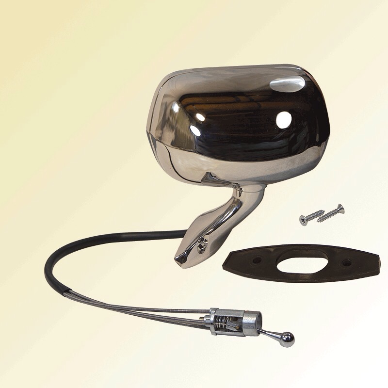

Hard to find a factory instruction for either LH or RH mounting instructions or exact location. I think its a case of studying some old photos and one sitting in the drivers seat and one holding the mirror.
They are not cheap mirrors but they do have a great classic look on these vehicles. Handy with an remote cabin adjustment as well.
As per photos one of the ones I managed to pick up came with a 2mm metal plate which sits in the door cavity. This makes great sense rather than screwing directly to the door skin.
Unfortunately I only have one of the black plastic gaskets in the photo. I cant seem to find another of which I will need for the other side..
Attached Thumbnails Door (wing) mirrors-dsc_1216.jpg   Door (wing) mirrors-dsc_1217.jpg
