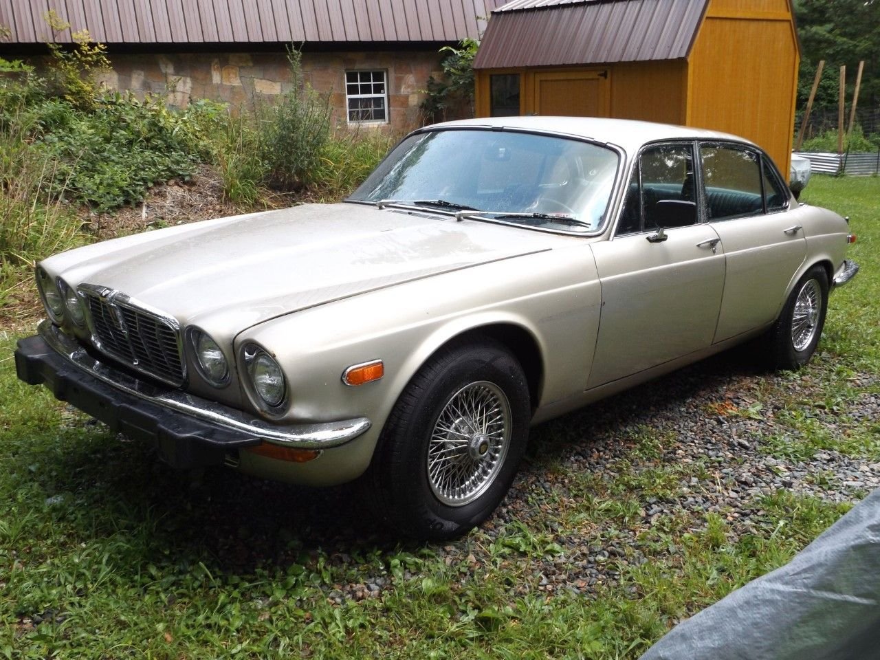

Okay, after reading several postings about how to lower the front end on a Jaguar, I am more confused that I was to start.. LOL I have a 1974 XJ12L and the engine has been changed to a 350ci TIP out of a 87 Corvette and the nose of the car sits high compared to the rear. If I change out the front springs to XJ6 springs and with out the upper spacers, do you think it will put the nose back to stock appearance? I am not looking to drop the car I just would like to have the stock look back. Please any input would be great.

Jose, I am not looking to just lower the Jag but to correct the height of the front end after the Chevy conversion was done. The PO never lowered the front to its original height but just left it sitting up in the air.. Thanks you for the advise though.

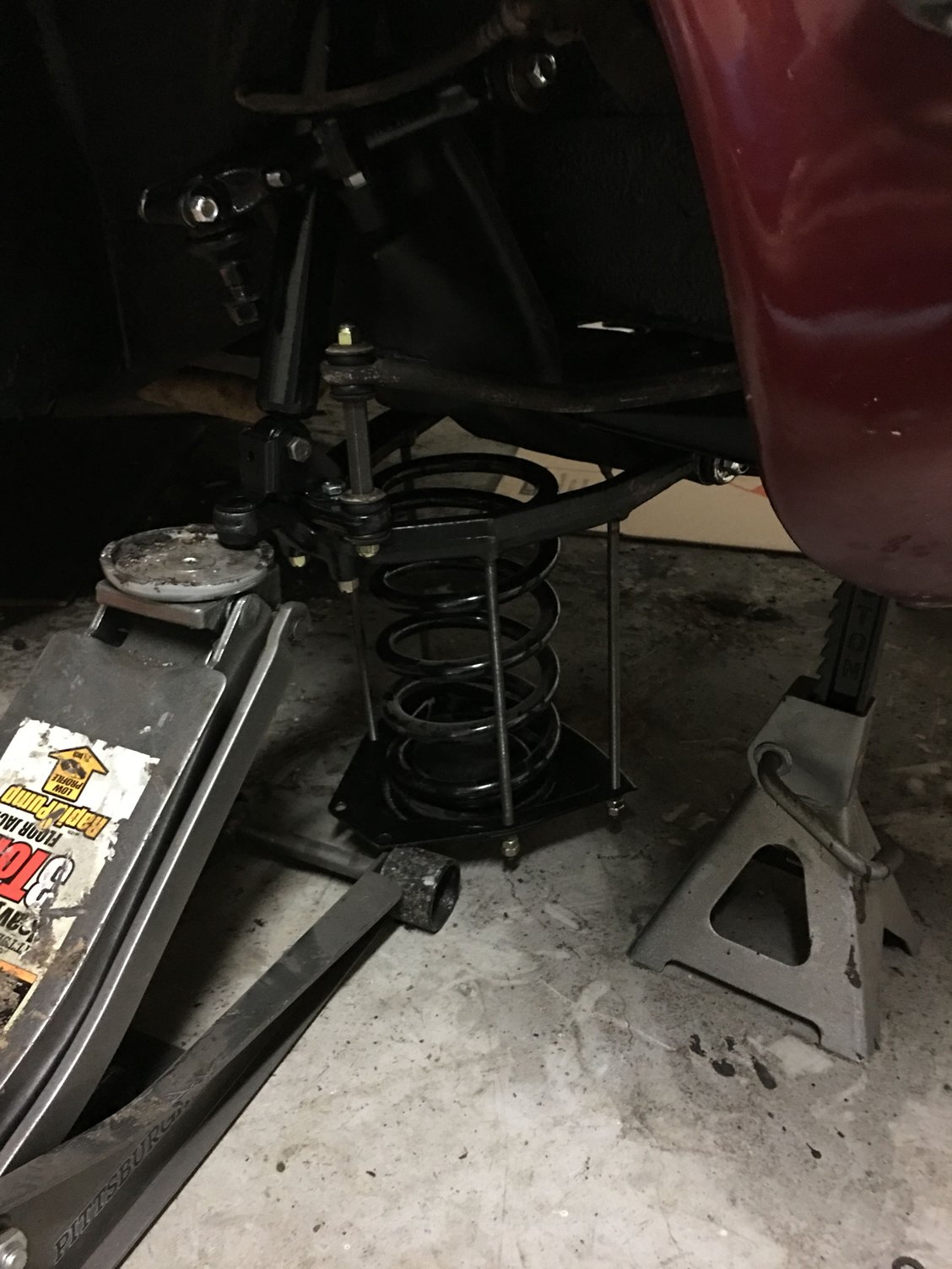

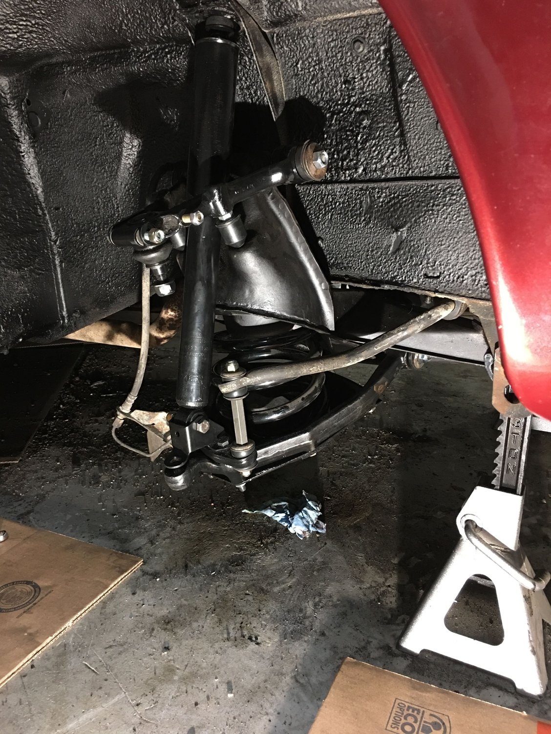

Hey, 350 chevy converted 1974 XJ6 here.
I also had to install conversion springs and spacers to get the nose down to stock ride height.
Make sure if you follow one of the guides on how to remove the springs that you get the proper tool for the job.
I have done the job twice with 6 sticks of threaded rod and the strength of the springs was enough to almost snap the threaded rods and it did on more than one occasion render the threads unusable

Hey Chillin, the thread that you landed on was for cars that are much older than yours. Our cars have a different suspension setup than yours does and we were abusing that difference to adjust our ride heights as needed.
On your newer Jag I have to presume that the most common correct solution to your desire to adjust the ride height is going to be resolved with adjusting the springs and shocks on the car if they are adjustable, or installing springs and shocks that are adjustable into the range that you desire.
Side note, why in the world did I not add these pictures when I responded to this thread the first time!?
Last edited by Mad Hatter; May 28, 2021 at 07:07 PM. Reason: Added pictures for the original thread

The springs that you see going into my car in the above pictures are those same springs JagCad.
I found that they did not raise nor lower the front suspension whenever I put them in, so I also added spacers to the pan to get it down to the correct ride height.
Then I found out months later that I made a horrible mistake. It has now sagged far below the stock ride height and I am hoping I can take all of the spacers out and return it back up to stock. It moved a long ways after install.
