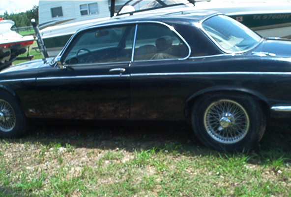

factory wire wheel ,knock off types ?
with spline drive?
can be done but a lot of money!
Attached Thumbnails e type wheels fit xj series 2-1975-jag-xj12c-007.jpg   e type wheels fit xj series 2-1975-jag-xj12c-018.jpg

show pic of wheel, is it a Jaguar xke car series 3? or an XJ

Ser II and Ser III E-types had a chrome wheel that looks virtually the same as the "Chrome Turbo" wheel seen on Ser I and Ser II XJ6/12 sedans. If they're different (appearance-wise) it would a subtle thing.
AFAIK the XJ sedans and Ser III E-type were 15x6". I think the Ser II E-type used a 15 x 5.5" version
The bolt pattern and center hole size should be the same for all
DD

thanks doug, what are the wheels on this 75 XJ12C coupe, had them off they are spline drive, use a copper& raw hide hammer to change them?
they are bigger and wider than some XKEs i looked at, more spokes also!
buyer sure was in hurry to get the car.

I dunno. Look like E-type wheels to me
