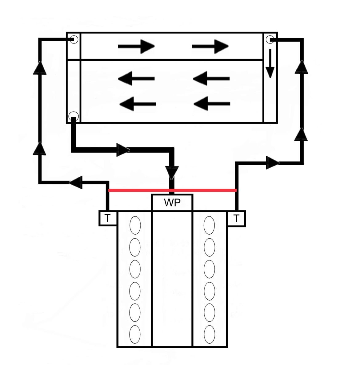

Thanks for the input. I posted it on the other thread. But this is the idea. Red line is a 1/2in or 5/8 hose. Between the B bank thermostat outlet and A bank thermostat outlet.

You have that already with that steel tuube, with a suction value to the water pump.
As I have also said many times, that stat disc is NOT a 100% seal with teh alloy face, so there is bleed from there to the pipe at all times.
I dont understand what is supposed to be achieved with the Re line, the thing works well as is, until lack of maintenance kicks in.
The B Bank hose will need more oomph than the A side. Otherwise the A Side liquid will flow to the B side. Again, its a balance thing, and works well as designed.

Yes, I forgot about the thermostat not 100% but open. Car is fine as is. I’ll leave it alone.
I’ll swap out the cross pipe with a stainless xjs pipe and angle the car to get rid of all the air.
I’ll monitor the temp differential and go from there.
