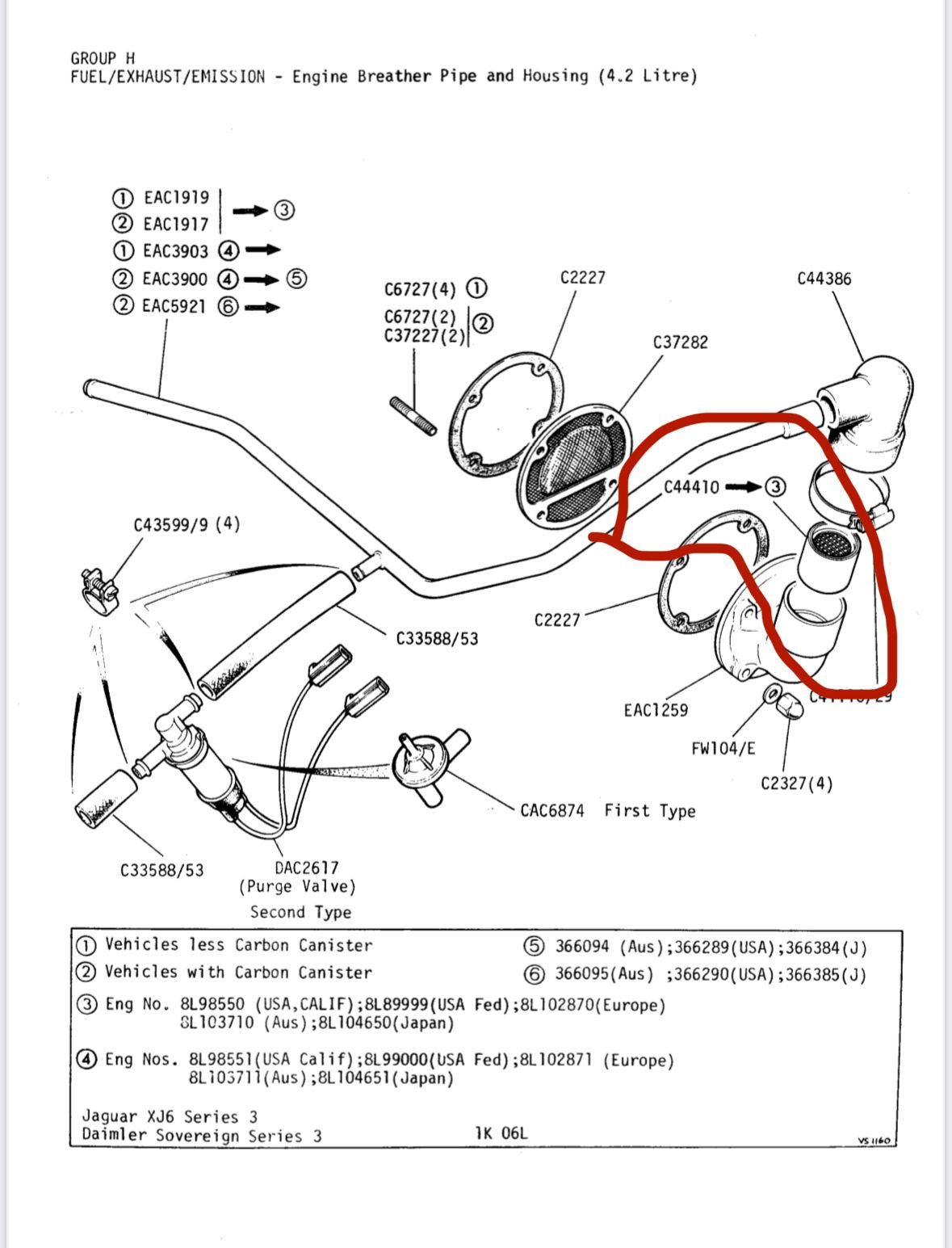

I’m curious as to what purpose filter C44410 serves. This is filter located under the breather cap. Is it something that routinely needs to be replaced? As shown below in diagram
Breather filter
Breather filter

I believe it's an oil coalescing filter, causes any fumes to condense and drain back into the crankcase. It's a metal piece, never needs replacing. Maybe cleaning occasionally, but that's not generally a routine thing.

I can't quote a reference, but thought it was a flame arrestor to prevent lean backfires in intake system from going into the crank case???
The vertical screen coalesces the oil fumes into oil that drains back to block.???

I've not heard the flame arrestor thing, but that doesn't prove anything.
Anyhow, anyone without it shouldn't be too surprised. Jaguar eventually stopped installing them on the Series III cars. I can't remember when, offhand. 1985? I'm sure there's a TSB for it but it would take a lot of slogging to find it.
Cleaning both screens....which is seldom ever done....isn't a bad idea. If clogged the resulting increased crankcase pressure will worsen any oil leaks.

P/N 603330
Genuine OEM 603330 - Land Rover Flame trap-crankcase breather (603330) part for Discovery 1 1989 - 1998 (from Fa393361 To Wa799999) Classic, Range Rover Classic 1986 - 1991 (to Ha610293) Classic, Defender 1987 - 2006. Authentic Land Rover Part.
Not a direct replacement, just showing some one thought this was a good idea at some time.
