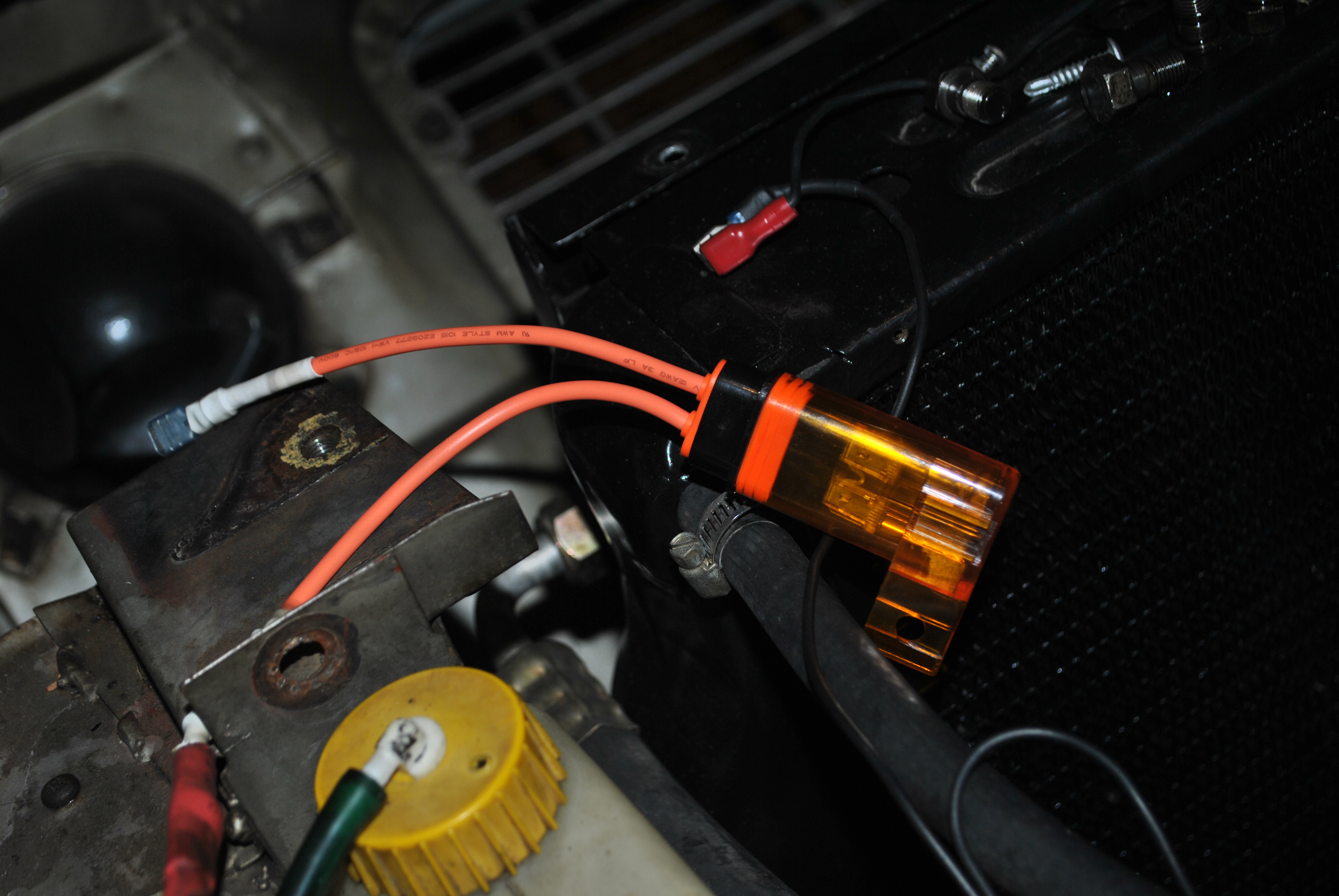

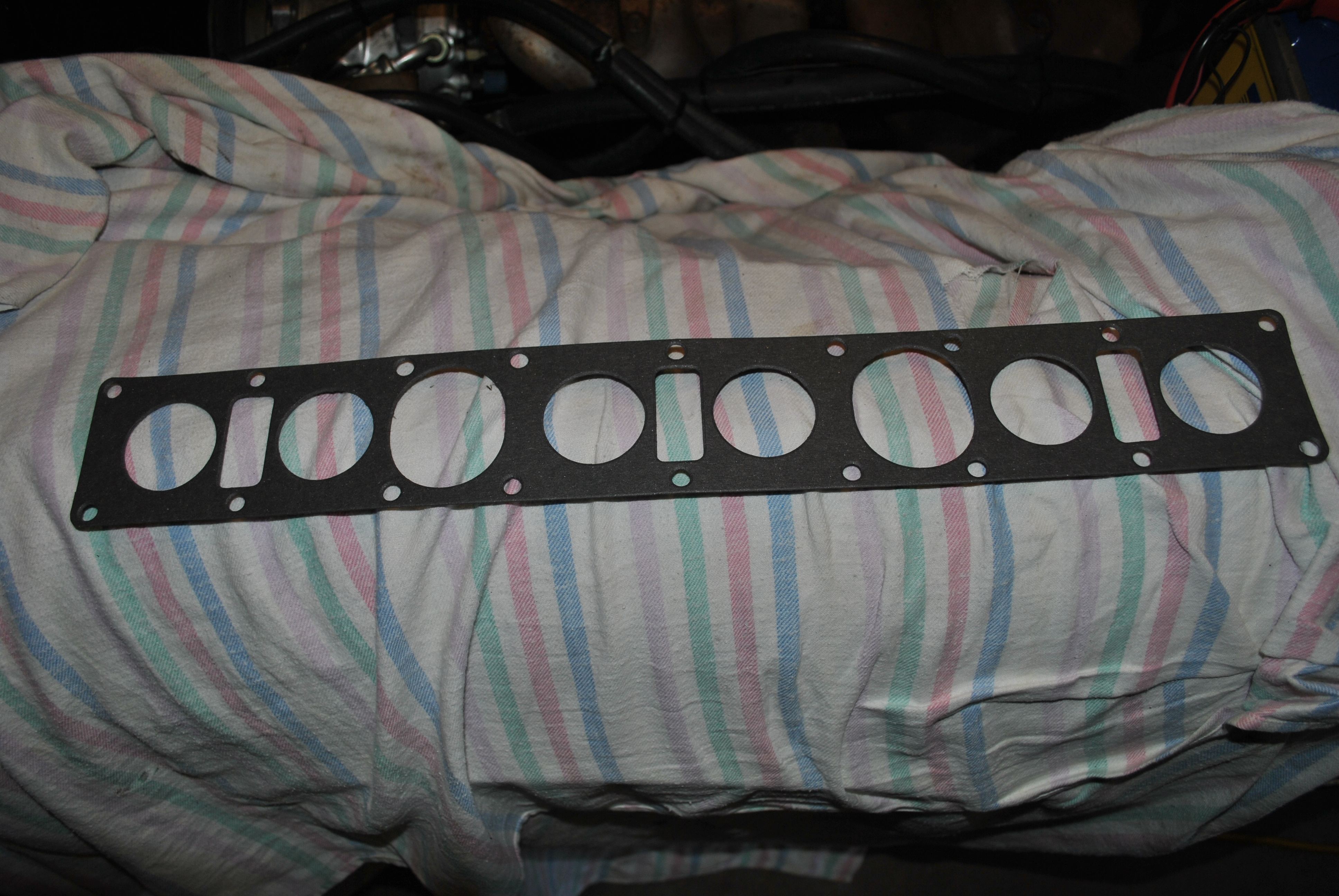

Sorted the gaskets in the VRS kit just now, no intake manifold gasket. So I will have to try and source one in Brisbane tomorrow. I assumed it would have one in it. If I can't get one I will have to make one.
Got a few small wiring issues sorted today, as well as butcher the throttle cable bracket to allow the heater hose to pass through it. The old one was twisted over it and nearly worn through.
Must have something to do with the S3 block with SU's on it.

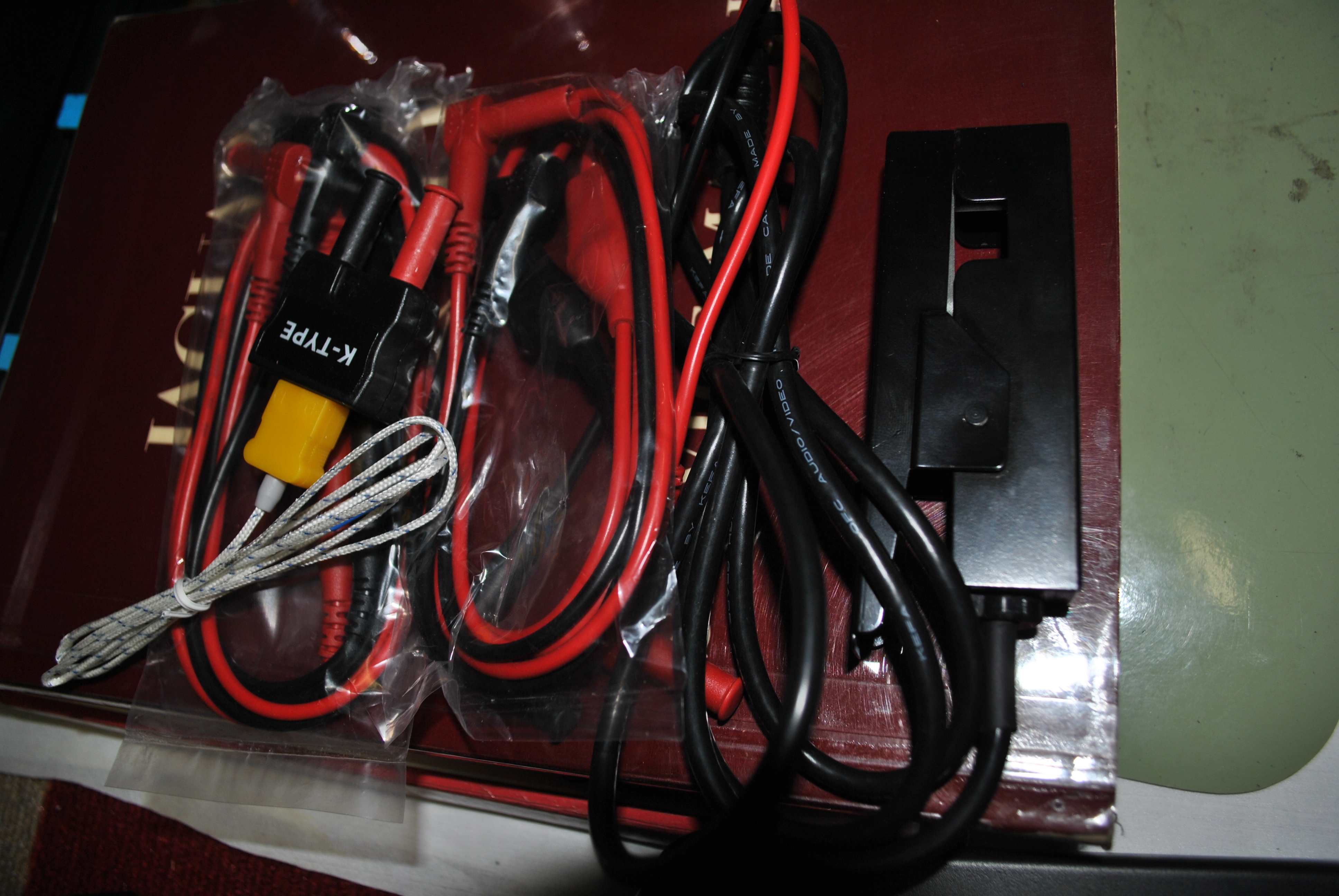

Bought a new multi meter today too, Phill used mine last weekend and binned it. It was only $15 from Dick Smith, it was giving false readings all over the place. No wonder I have been chasing wiring issues and getting nowhere.(not on the Jag,on a bike) Just thought I would add that.
Now just got to work out what all the cables are for, came with no instructions.

You are looking for a JA793 for that Inlet Gasket.
I would be informing the mob that supplied you the VRS they have short changed you.
Good luck.

I've three meters. Each came via Harbor Freight. Fluke quality, not so.
But, seem to work quite well. I keep them in the boxes they came in.
Each had a paper with directions for use. As, I forget, I leave the directions in the box for ready reference.
1. Reads Volts by inductance. More useful in home circuits.
2. Analog. Best at some tasks.
3. Digital, Used the most.
I'm quite proud of the patch cord I made for the digital unit.
An accessory plug for the cigar lighter. cords from my "odd box" with probes that fit the meters. Volts in real time under various load and rpm's.
Flop: I was chasing an electrical issue in the Jaguar. None found where it should be!!! Why oh, why? then, duh, the car's battery had gone tango up!!! Bye, bye, Slick older Optima Yellow top.
In with a fresh battery and things began to make sense....

I sourced an intake gasket, none of the usual parts places had one. But I found a Jag parts place I have never even heard of, only 15 minutes away.
One of those old tin shed type of places with so much stuff around there wasn't a clear path to get around and not enough space on the counter to put your wallet down. Plenty of series 1 parts, 3 gaskets on the shelf.

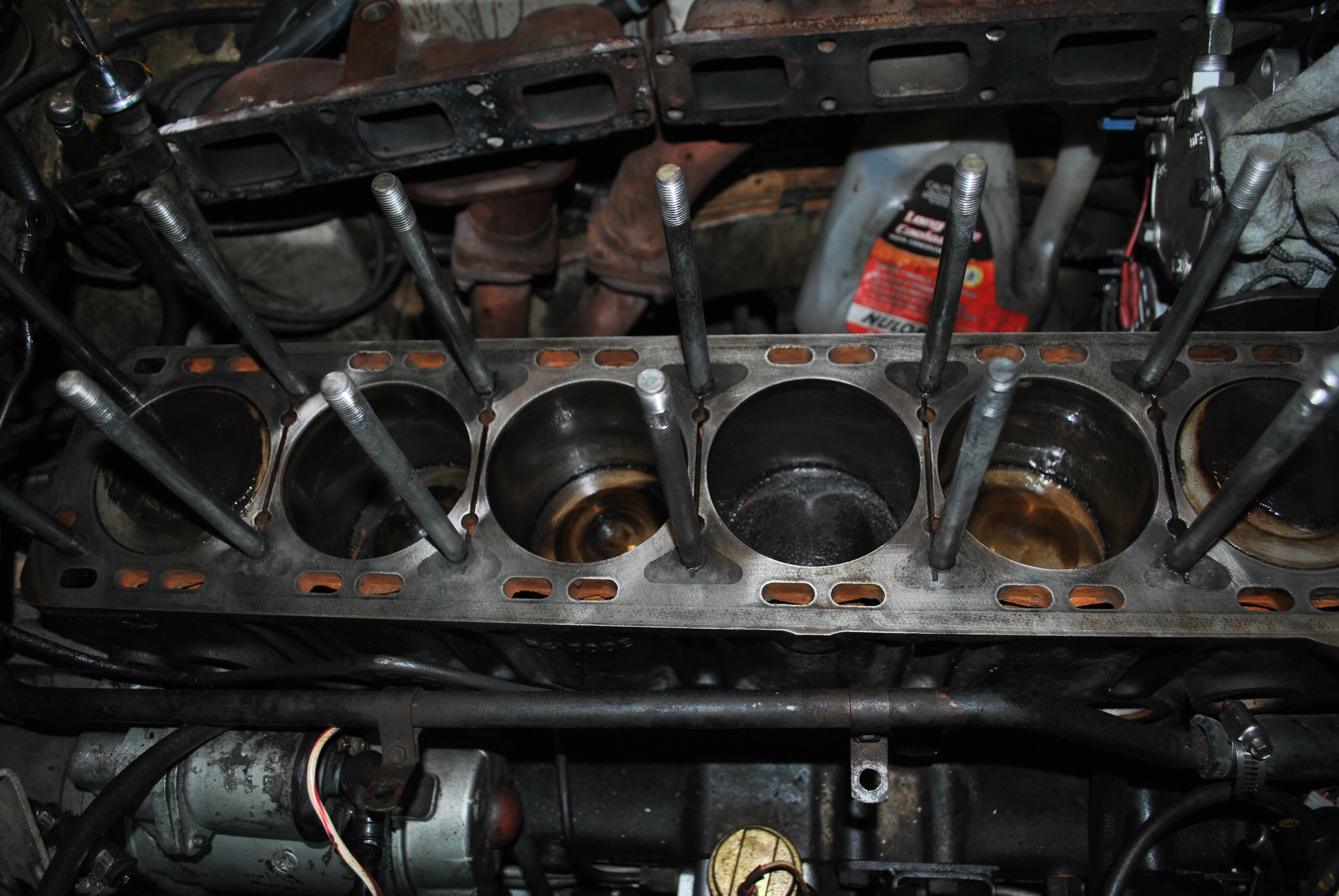

Come to a grinding halt with the head, cam bearings didn't arrive when they should. So off the road for at least another week. 1 pm Friday and still waiting, the rebuilder shuts at 3.

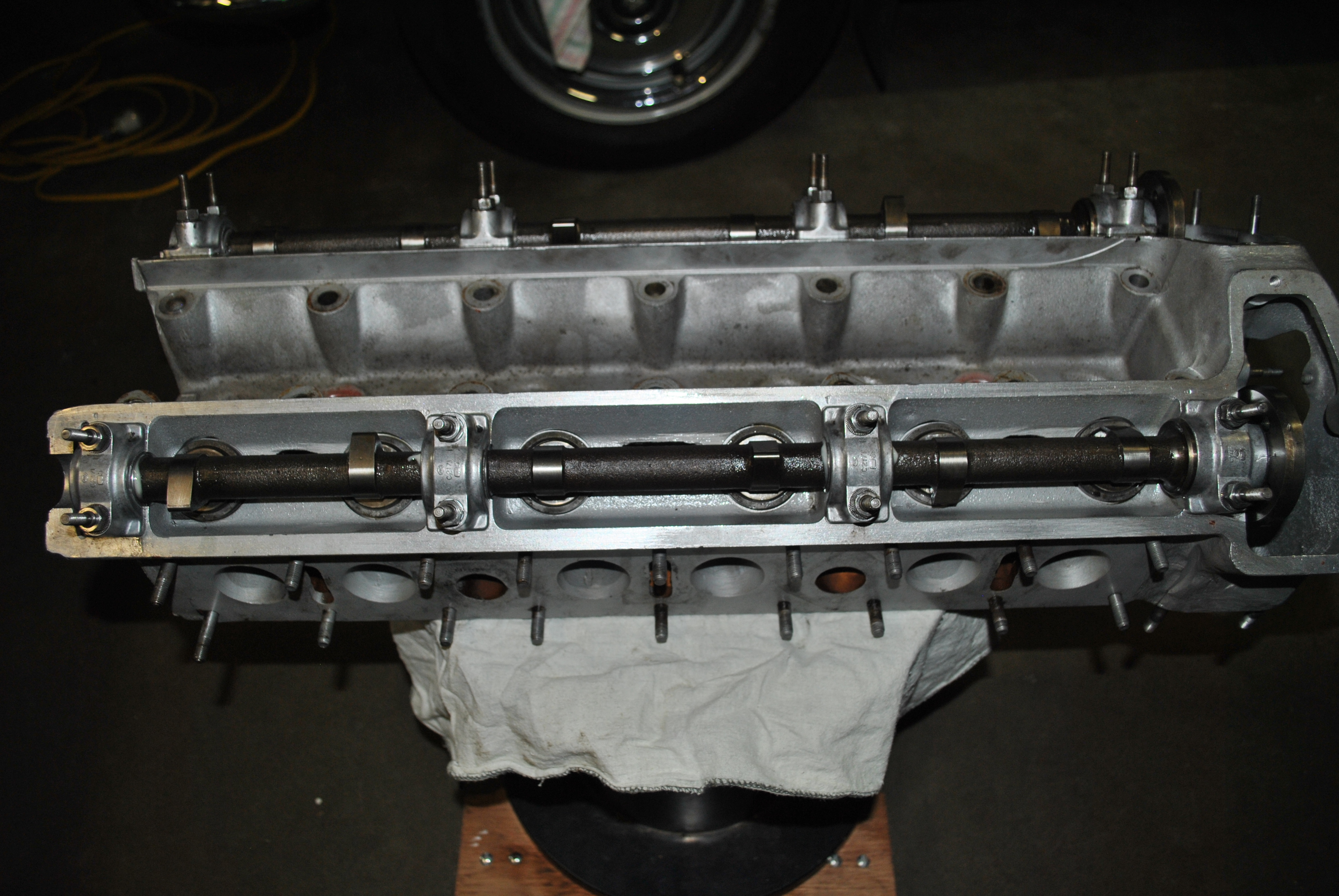

Great pics once again Cecil B de Mille. I have zoomed them up as far as I can to look at bores and there are no huge combustion ridges above top rings; no ugly holes in piston crowns and really, after all earlier fears, the block face and water galleries look in good shape. It appears you have been busy on the block face - the area between 5-6 looks good, perhaps even better than 1-2. Nearly ready for head - but not quite. Bugga that bearing supply will cause that delay. Let's see if we can use that time for some related investigation.
Neat that you have not yet cleaned the tops on the thingies that go up-bang-down (narrowly avoiding the thingies that go down-bang-up). Can I suggest that crowns on 2 and 4 look like they have been running a bit leaner than 1,3,5,6. Perhaps, the latter are just more coked from inlet valve guides leaking oil into the combustion chambers during induction, but I look closely whenever I see whitish brown ash. What did the spark plugs tell us about each cylinder?
Great news that your t/c and camshaft sprocket gears show so little wear - but do check again in another 500,000 miles!
Last issue for me really focuses on block rather than top end - and specifically those Welsh Plugs. Did you replace them? I was sure we addressed the need while the engine is sitting, waiting, but I can't readily find your response (was it perhaps PM?). Not sure from your pics here.
For all others following Clarke's work here, now with all manifolds and accessories off is the ideal time to pop out all the old ("Bring out yer dead"), clean the seats, apply new sealant, and hammer in replacements. So cheap; so quick . . . but so frustrating to get back on the road for a month or two only to have one let go! Ask me how I know . . .

Scrape piston tops or not? I used to do that in each and every case.
In situ, has differing thoughts. Do it, but use a strong vacuum to get the "swarf' away. Hard carbon bits into the bore can scratch the walls and/or the pistons. Don't, unless it is really bad, cleaning last only a short time, and the carbon will be redeposited, not worth the risk.
That head surface does look good. I've used a framing square and a feeler guage to verify "flatness". Somewhere, I picked on .04 inch as a max defection.
Hard to deal with with studs in place, but removal has perils.
I've read material on a four fastener per bore system vs a five fastener system. Fours in other specie have been known to have gasket issues.
I just can't wrap my mind around a filling of the slot with Pliobond or anything else in a street engine. Jaguar engineers were/are pretty smart.
