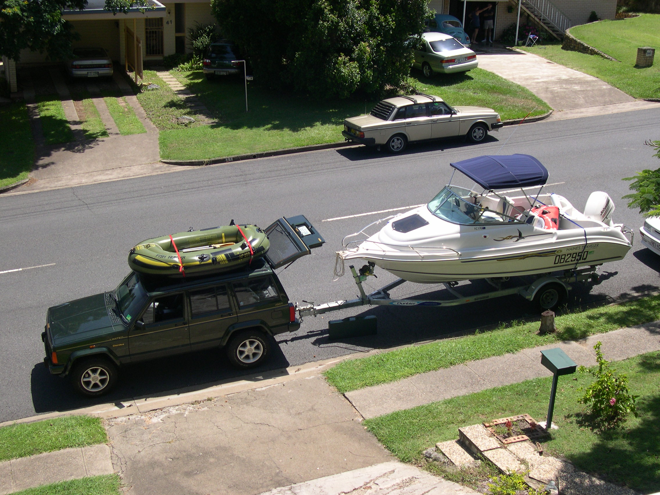

I have attached a couple of pics that give an indication of the hill I'm trying to park it on,one from the road,and one from the top.

Parked on drive for 48 hours,nose down.(raining so didn't smell the fuel),no oil leaks,but lost 20 odd liters of fuel out the rear carby as gravity does strange ****. Float must stick or something on that angle(40 degrees+). Steepest legally allowed drive way in Queensland.
Have ordered fuel shut off valve for it today. I WILL PARK ON THIS DRIVE ONE WAY OR THE OTHER.
Took me 2 years with the Jeep to park it successfully without it sliding down the hill or leaking internal fluids. This Jaguar will comply eventually.

Yep, many a morning I found my jeep with front the wheels in the gutter when we first moved here. They only slide when front is facing down. Front seems to drag the rest of the car with it,park it nose up it will never slide. Front wd cars,they stay put? (could be the weight,girls car hatch backs)
On a hot day you can stand there and watch it creep down the hill. Other days you can think all is ok then go inside and grab a beer before you hear the scrape sound that means your car is on the move.
They only slide slowly so the pedestrians are safe(lol).
It took my wife 2 years before she would reverse out of the garage. All you see is the roof tops across the street.
Its the mother of all driveways,try it on a motorcycle........wet can be entertaining.
