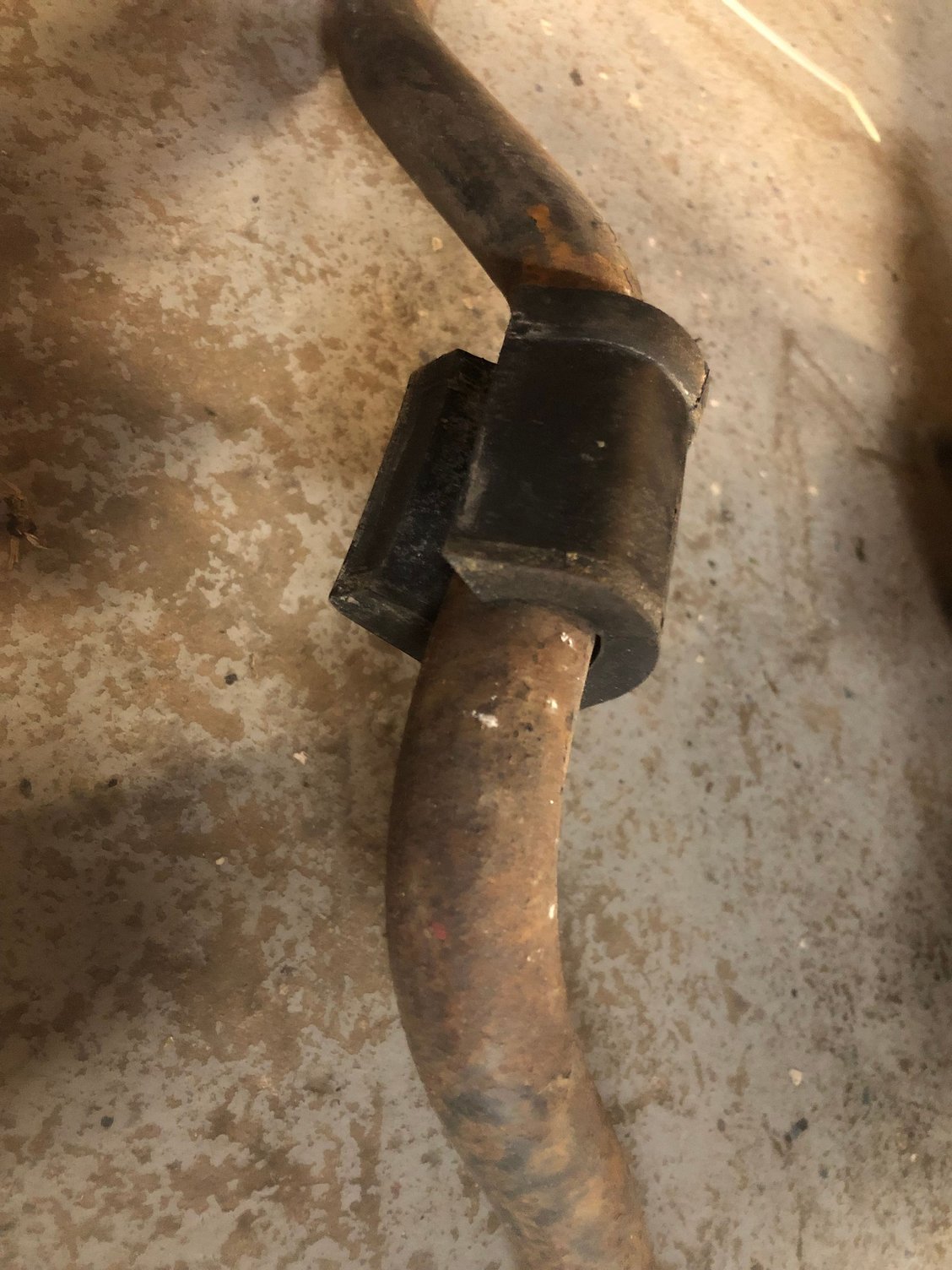

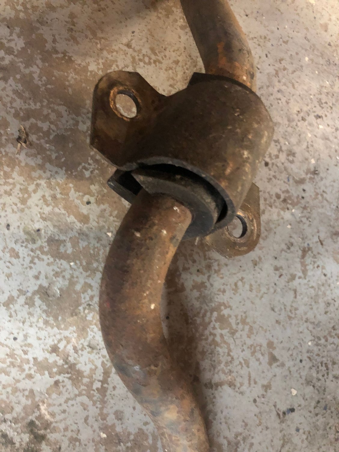

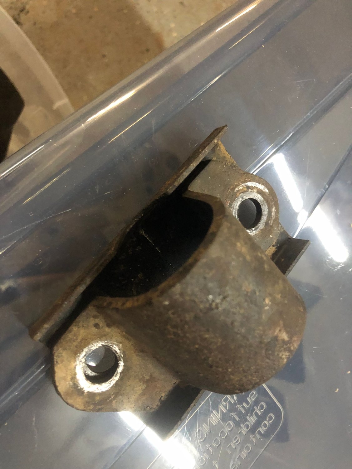

I'm changing my standard 3/4" front bar (ser2 xjc) to a 7/8" xjs bar and I'm not seeing different part numbers for the frame mounts. The bar is considerably larger in diameter and my question is does the larger xjs bar use the same retainer with the two bolt holes and the same rubber or poly bushing as the smaller bar? Sure doesn't seem right, looks like the retainer wouldn't pull all the way up tight against the car? Any help would be appreciated.

I have the 7/8" front bar and used the original u-brackets/clamps/whatever.
There are a couple different styles of bushings being sold; they're shaped and sized differently. I'm having a brain fade as to which works right with the existing brackets. Gah !

That helps Doug, maybe they're the same outer dimensions with larger holes. Thanks.

I installed a 1" aftermarket bar with poly bushings and used the stock retainer. Don't remember having any issues.

I too did this mod, using a thicker bar that I believe came from an XJ-12. I can confirm that the mounting brackets and backing plates are different as are the bushings (I used Poly from Moss Motors).
https://mossmotors.com/37-6011-polyu...fault_products
I sourced both the bar and the brackets from Robert Laughton (a fellow poster) here in Niagara on the Lake, Canada. You may wish to check with him, as he remains my go-too for used parts. He has tons of parts cars and containers of spares.
