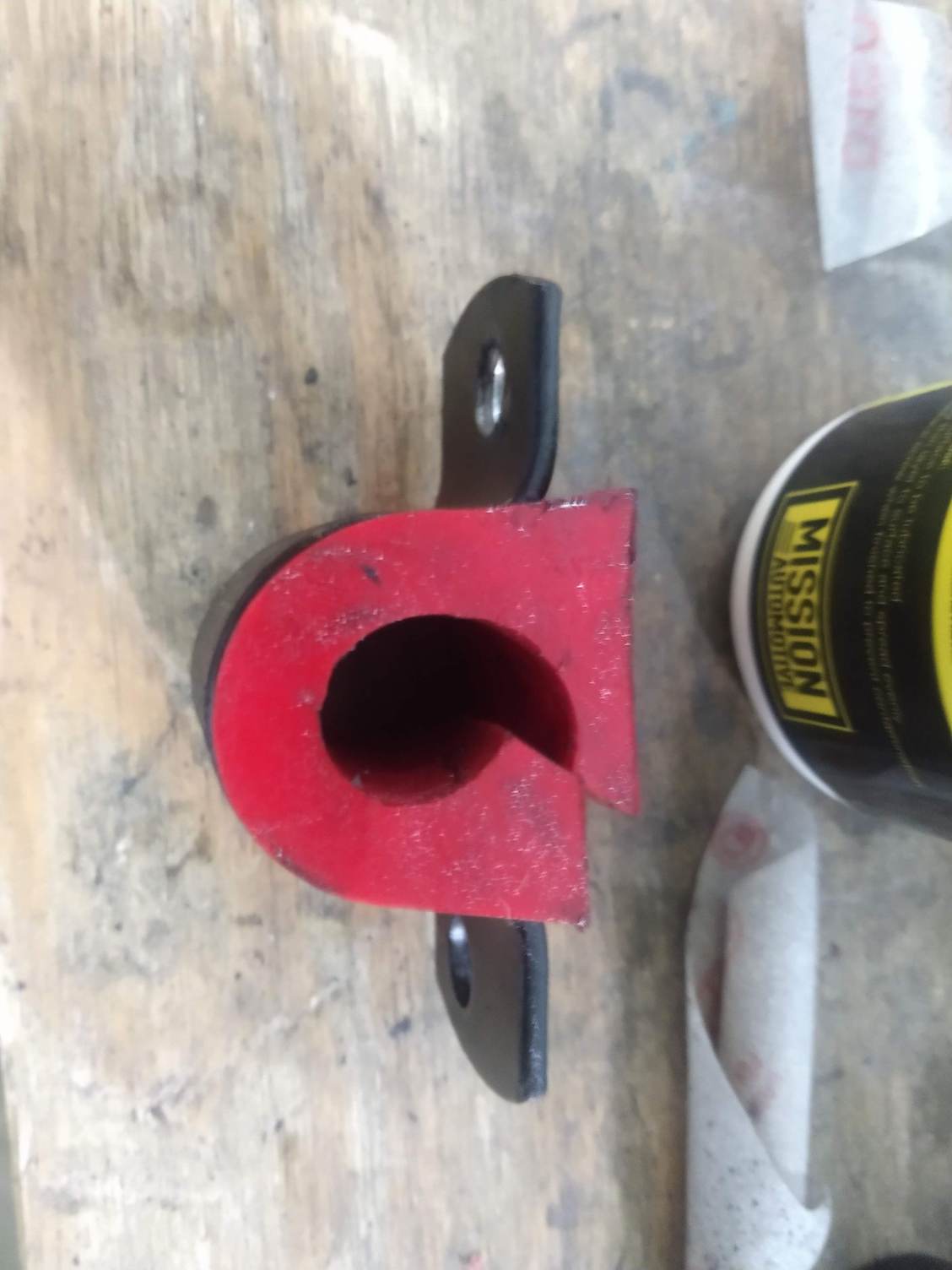

A couple of months ago, ordered sway bar bushings. All was well, went to install, they were too small. Hummm... ID measured 19mm, but my sway bar measured around 21/22mm (OD). Ok, so went online, order some that were a different part number, but purportedly had a 21mm ID. Again, a bit too small and also the 90 degree angles of the D were flared out and thicker (picture below).

1989 XJS v12 Convertible - left is the original sway bar bushing, right is the Prothane sway bar bushing (yes, yes, red is bad, polys are bad, but I'm vane (the car is signal red, so the red bushes really look nice, but only when the wheels or off) and I personally like to feel the road a bit while driving
1989 XJS V12 Convertible - Prothane sway bar bushing that obviously don't quite work

I usually out this in the "played with" section. Meaning, someone, maybe the factory fitted a 22mm front sway bar, not uncommon in some markets.
BUT
Memory (oh boy) from my time as Parts Manager at Jaguar, the Ragtops got different things, and the front sway bar rings a very dim bell, but I could be wrong.
Memory again, my pre facelifts all had 19mm fronts, and a 16mm rear on one, but none were the Sportspack. All the series cars had 17 front, and no rears, except the V12's, which were 19 front.
Simply get some 22mm "D" rubbers, and I used Poly here without issues.
