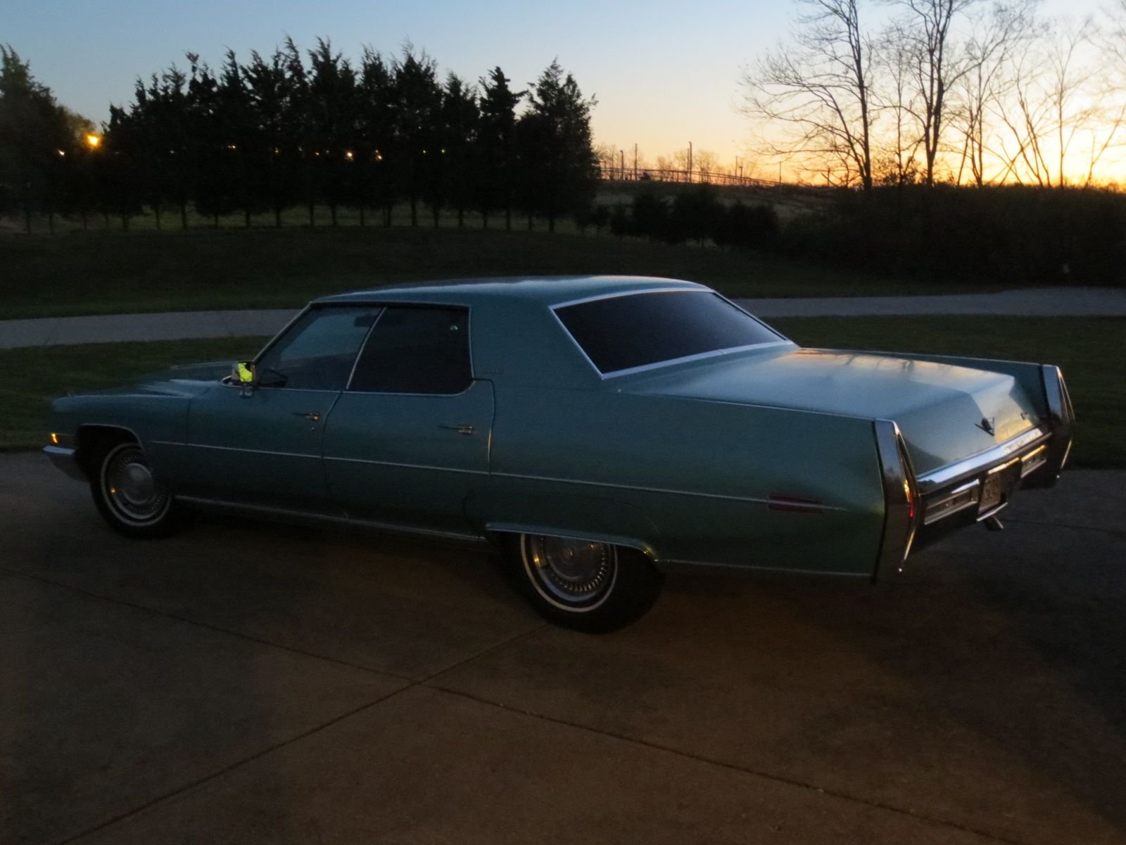

I always wondered about the phrase "the XJ6 is a heavy car". I just figured it out - I think people are comparing to other comon cars of the era in Europe. Here in America they were definitely mid-sized. A few years ago I bought a beautiful 1972 Cadillac sedan de Ville. It weighed 4900 pounds, had a 7.7 litre engine. As for gas milage, on the open highway at constant speed I got 13 mpg if there was a tail wind. We drove it across America and back and had a blast. So I guess "heavy" and "poor gas milage" are relative.

Beautiful Cadillac. Those were marvelous cars, along with the many other big American 'land yachts'. People often speak of them disparagingly because the suspension was so loosey-goosey. True enough, but they're a dream to drive. Soft, comfy, quiet. And room to s-t-r-e-t-c-h out! And back in those days the Cadillacs, Lincolns, etc really were a cut above ordinary cars in terms of quality of materials, workmanship, etc. These biggies deserve their place in automotive history.
Agreed on the 'very heavy' Jaguars. It's all relative. Here in the 'States a 4000 pound car is merely 'heavy-ish'
And when talking about miles per gallon remember that, while American cars are big, American gallons are small...compared to the Imperial measurement used in other parts of the world. That 13 mpg from the Caddy would be about 15.6 mpg in the UK or down under.
