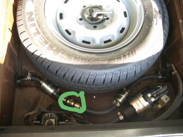

ALSO What is this?? And could this be causing the odd sound??? Does it need cleaning out or replacing ever??
That's the air bleed for the fuel lines....plus one of the nipples is a one-way check valve to help keep pressure in the fuel line. As far as I know it won't cause any odd noises

I got a fuel filter and changed that over 3 days ago. I also changed the 5/16?? Hose leading from the pump to the little hollow metal rail leading to the main filter. Not sure what called???
But I still get a sound that's like "put put putty put" almost like the fuel is not regular.
the only hose I havent changed yet is the one from the t junction leading to the pump itself. The 1/2 one.
Could the little fuel gate thing be an issue?? In picture attached.
although my gut feeling is that it may be the last hose to the pump
any ideas very welcome and appreciated!

Originally Posted by chrisleg
So i received ONE of the prefilters today. No idea why they decided to send the in separate mail outs.
Anyhoo. I am guessing that the arrow should point to the fuel tank OUT line??
I've recently added these wix pre-pump fuel filters to my SIII after replacing all the fuel hoses in the trunk/boot. I came across this thread and photo and had a question. I assumed the arrow on these wix filters indicate the direction of the fuel flow and therefore should point away from the tanks and towards the crossover valve. However, no one chimed in on chrisleg's question. Am I correct? Thanks.

You are correct, the arrow on any fuel filter I've ever seen is the direction of flow ( from tanks to crossover valve in this case ).
