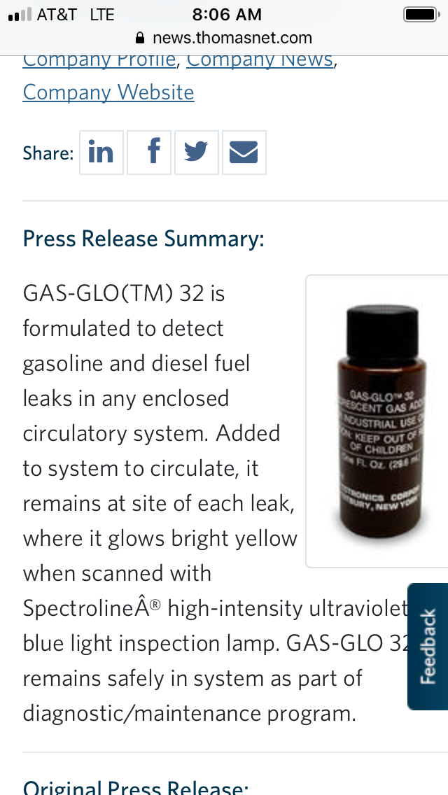

Maybe try this. Similar products/schemes work for AC freon leaks
