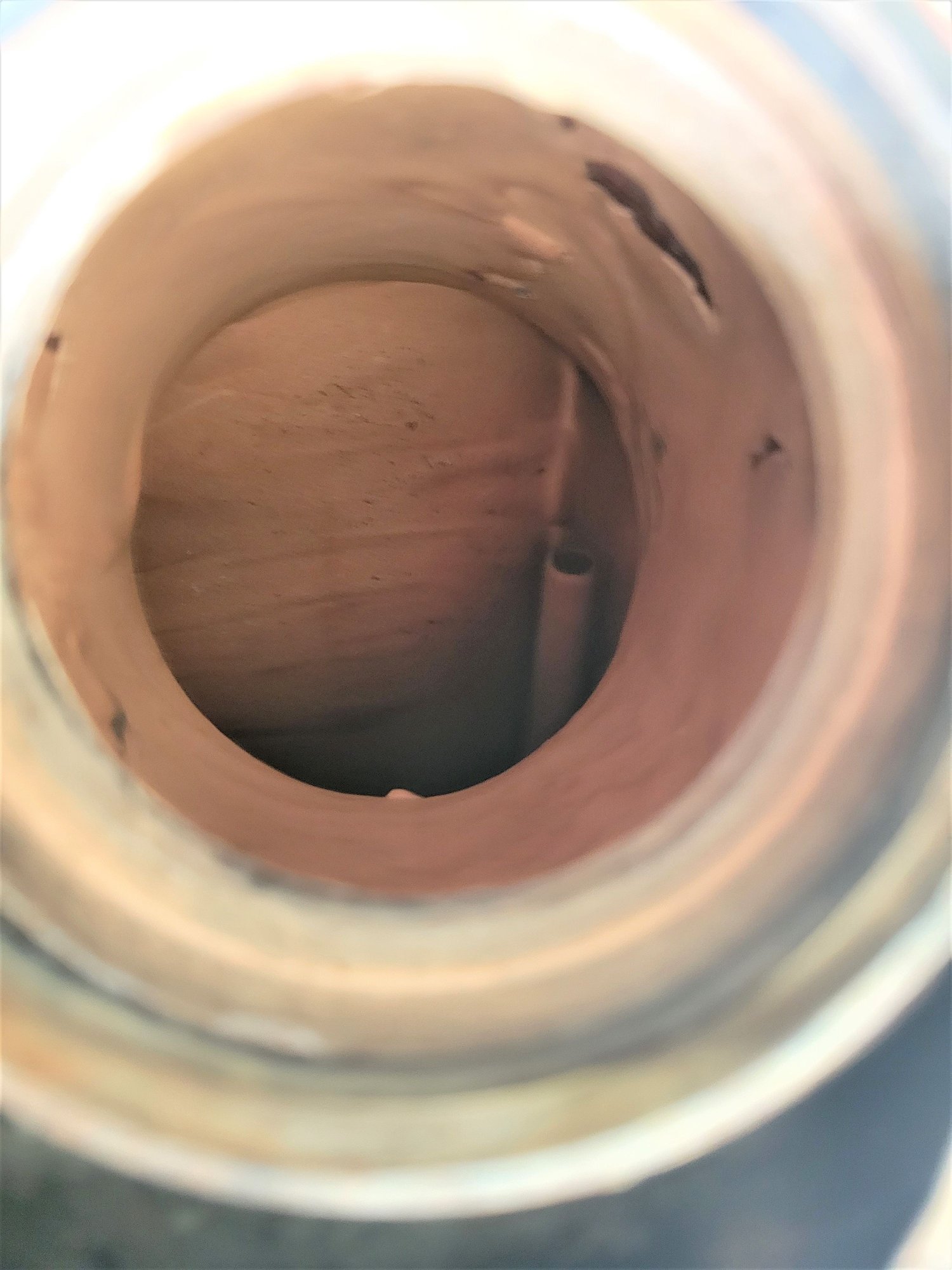

My driver's side (left) gas tank starting leaking after a fill-up the other day. Then stopped when it reached a certain level. Not known what that level is yet. I pulled the gas cap assembly, renewed the gasket and pulled and lubricated the O-ring. I know that didn't cure the problem, I'm sure. I did notice (see pics) that it appears the tank received some sort of tan coating on the inside because it's starting to flake near the top. I don't think this coating is OEM? But my real question is: What is the tube I see about six inches down in the opening?

I'm going to take a wild guess and say it's the fuel return for fuel injected XJ's.

Interesting! As mine is carbureted. But that doesn't mean I don't have a replacement tank in there from a previous owner. I wonder where the other end goes to??

Hello Bill, Assuming that we are talking about the left tank, remove the carpet panel from left side of trunk. About in the dead center of the side of the trunk could be a piece of the pipe work that returns fuel from the fuel cooler attached to the low side line of the A/C system. Doubt if it leaks though. That connects to the pipe inside the tank you see.
