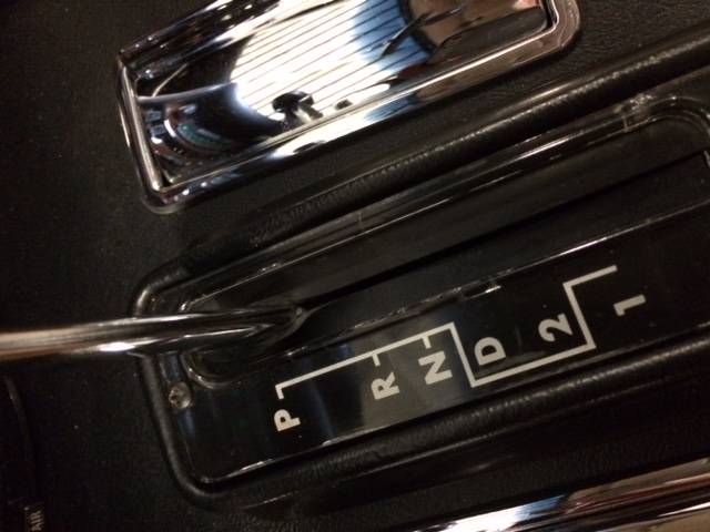

An alternative to the original CAC2864 brushes (I call 'em 'whiskers') is some ordinary sheet rubber glued into place.
You can still buy new brushes. In fact, that's what I did. Then, in a not-so-uncommon-for-me moment of ham-handedness, ruined them with an inadvertent blurp of crazy glue. Grrrr !
Knowing I had a roll of thin sheet rubber on hand I decided to make up a substitute. A couple strips cut and glued into place.....this time without making a mess of things.
Sheet rubber is readily available online; inexpensive; good to have on hand for 1001 uses.
DD

I call them horse-mane hairs.Ask me if I hate them. The emergency brake arm cover in my ford minivan uses the same principle, one piece of thin rubber sliced in the center, and in no time ends up as two pieces of thin rubber. Typical Ford's "better ideas" ?

Will be interesting to hear how they fare. I replaced the bristles on mine a few years back and because the lever is mostly in 'P' it doesn't take long for a permanent gap to appear there as the bristles deform. I would assume the rubber would go that way too after some time.
I agree.
Offhand I can't think of any commonly available material that wouldn't eventually deform
DD

I actually got a boar hair brush and took that apart, arranged on tape, then glued to the strip to refinish mine. It seems the factory ones were either dyed or synthetic, since I recall them being black. It matches the factory boar's hair on the seat belt track though, so I think it looks good.
