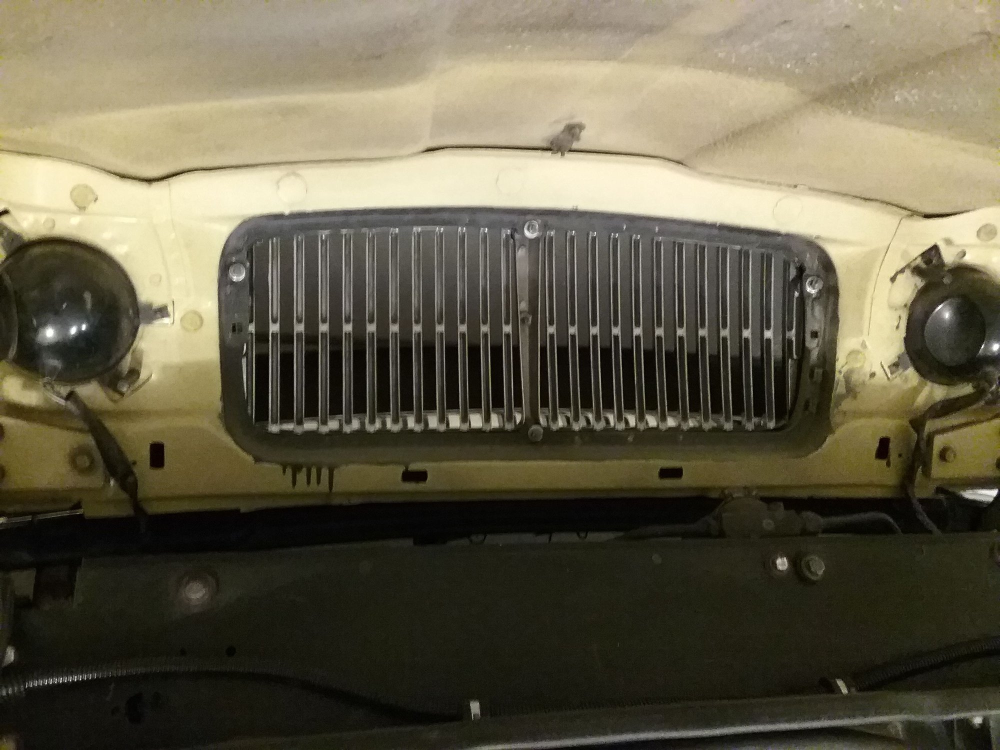

Carl is right. It makes it easier when reinstalling to remove the grill (just 4 easy to reach bolts) and then you can reach through the grill opening to make the final tighten on the bonnet hinge bolts.

Elinor, interested in your not being able to access the studs to remove the grill. I know yours is a series 2 and mine is a series 3. I just went out to the garage, opened the hood, and snapped a photo of the back of the grill. You can clearly see the four little nuts on the studs. Top, bottom, left and right. I had someone kneel down in front by the license plate to catch the grill when it came out, socket wrench to remove the nuts, tap with the heel of my hand and it came right out. How is yours different, Elinor?
I have a S2 and I believe it is nearly identical. I read Elinors post as that she didnt have enough room to make the adjustments after reaching in through the removed grill. Not that she had trouble removing the grill, although I could have misinterpreted.
Mad Hatter is correct.
I can easily remove the grill, but once the hood is down there is no room for my hands, let alone tools to adjust the bolts in that manner.

Makes sense now. I have a Chevy truck radiator, AC condenser and that's it. I have lots of room in there.
