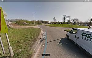

I wasnt too sure I'd hit the right detent on the lock at the time as the lock was a bit floppy on the column, if I'd got it wrong I would have gone straight through the mobile home site on the other side of the roundabout. See grab from Google of the site.
