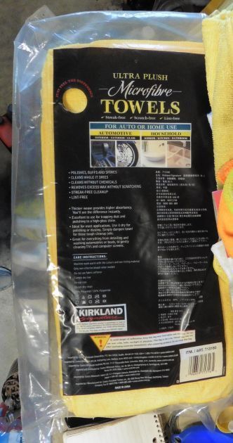

Jeff,
I fold the cloth into quarters; half, and half again.
Then I merely turn the cloth Very often, and I use a Lot of them! (Costco sells them in Bales)
One section Never touches more than 1/2 of a panel.
Roof is divided into 4 sections, trunk into 2 sections, Not including tops of rear fenders which get their own new section.
Hood is 4 sections, Doors are 2 sections each, upper and lower.
Rocker panels and rear quarters under bumper extensions are done with Windex first, and only when cloth comes up relatively clean do they get Meguiar's.
Rims also get Windex first, and again, only when the cloth is clean, they get Meguiar's.
And then I have a load of laundry!
