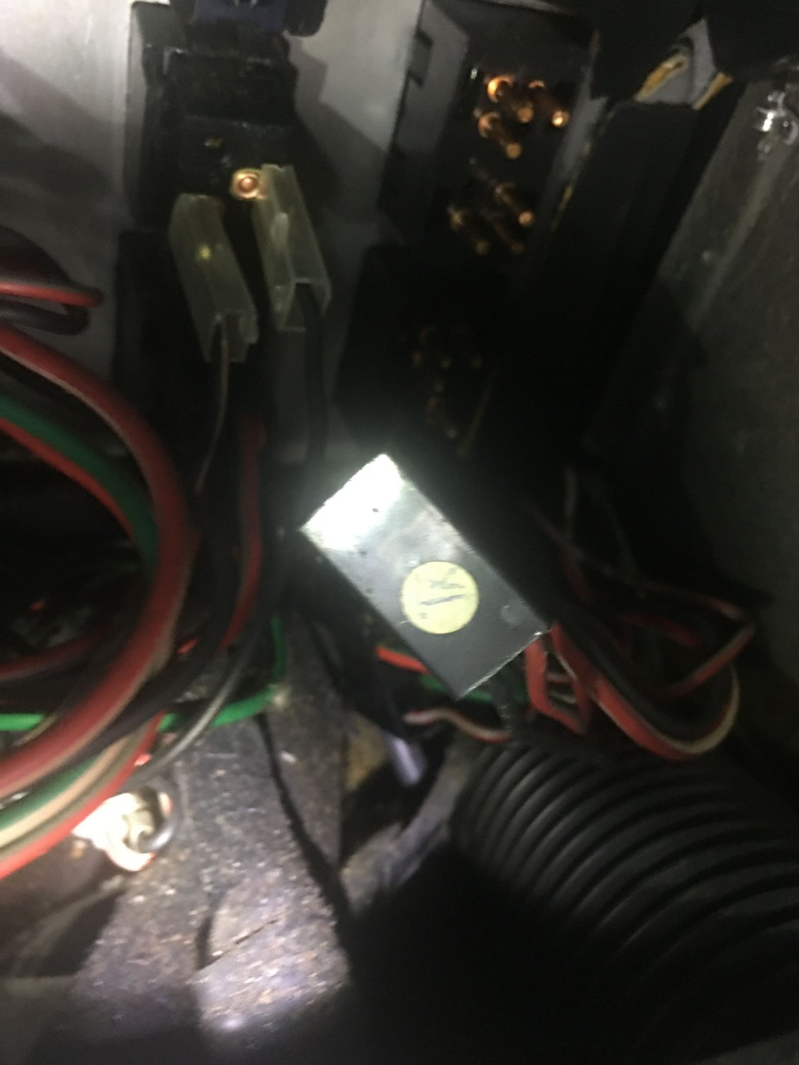

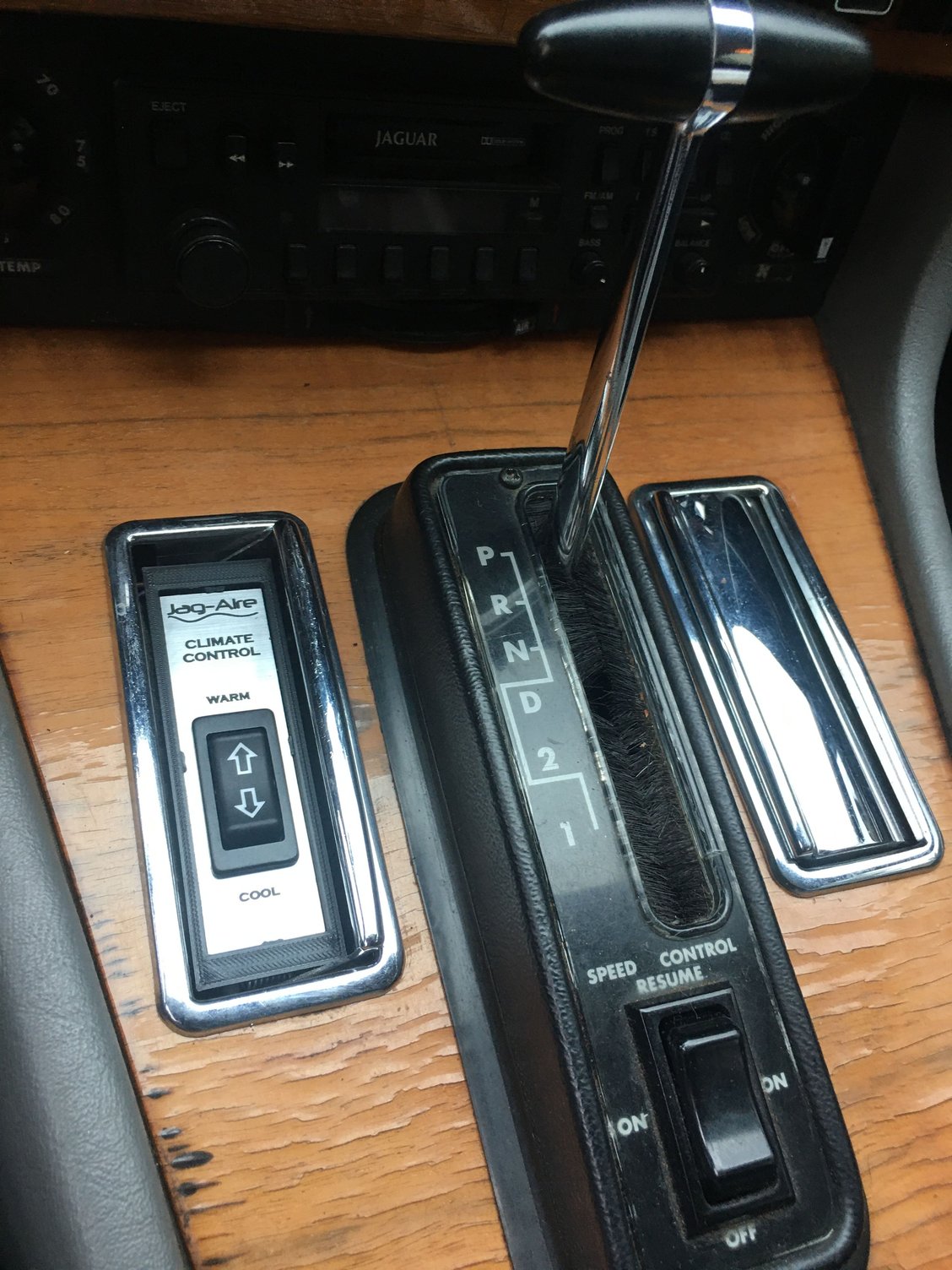

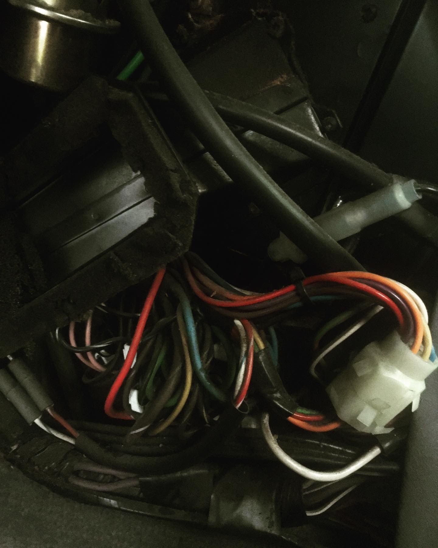

The last time I drove the S3 I nearly froze my *** off. I managed to figure out that my Delanair amplifier had gone kaput, so I ordered the Jag-Aire rocker switch, and installed it a week later. Today it was cold, but Im extremely happy to report that I was able to switch from cold to hot with the touch of a button. Tearing everything apart allowed me to clean up a bunch of hidden areas too. I will say that I kept holding the button in 5 sec intervals until I heard servos stop. The travel was pretty long and I kept thinking that something was going to break. But once I heard it stop and I was able to go back in the opposite direction with no issues I stopped worrying. I did also manage to figure out why my rear window had quit working. The harness had been unplugged at some point. The window works just fine.
