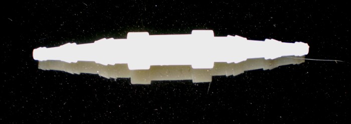

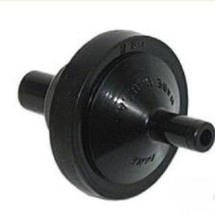

Picture of the pressure-release check valve used in the Series 3 XJ, and the replacement two-different-diameter-hoses connector I use in my XJ-6:
Attached Thumbnails Just bought an 86, drove it 2 days, and ... hello, fuel system failure.-tank-pressure-release-valve.jpg   Just bought an 86, drove it 2 days, and ... hello, fuel system failure.-hose-hose-connector.jpg
