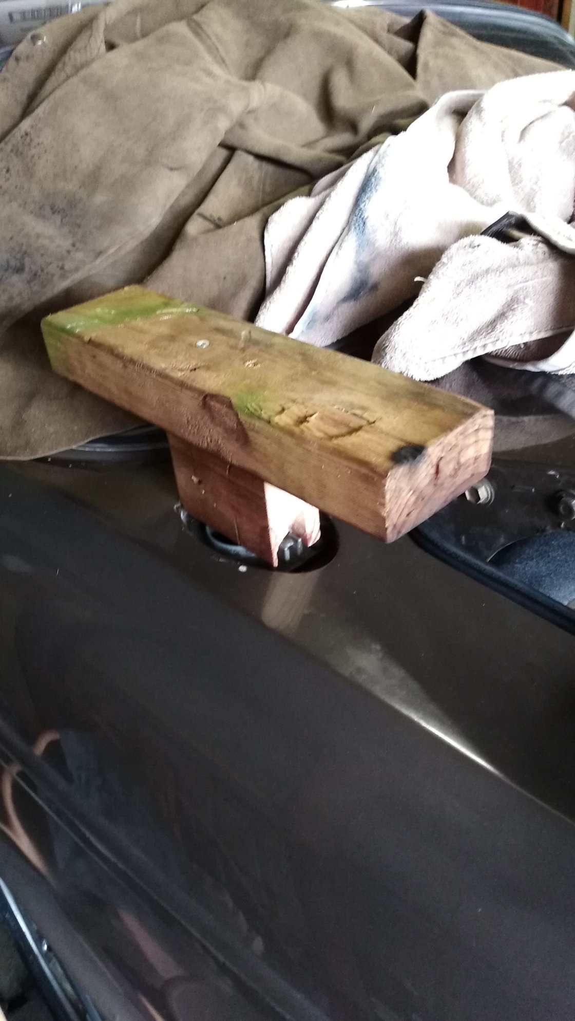

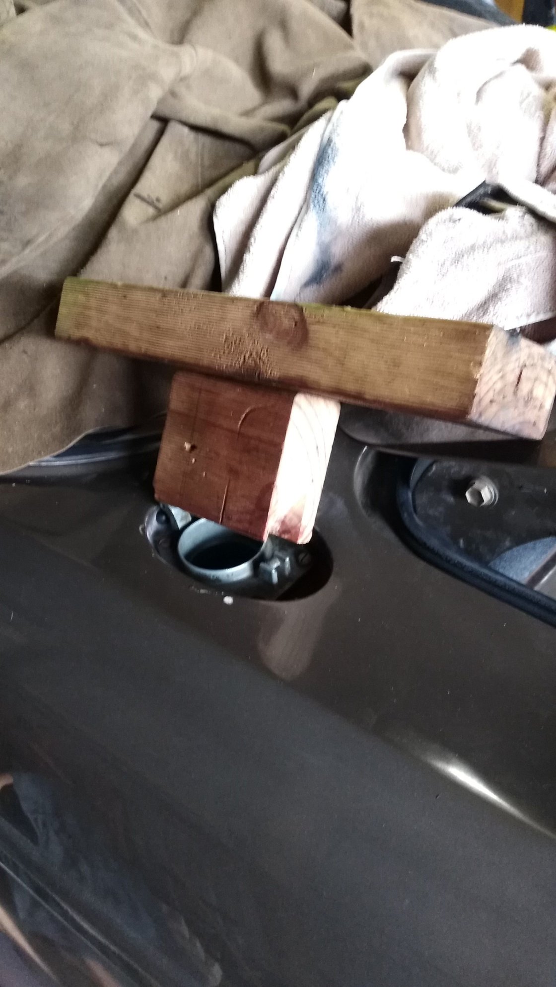

What a mission!
More chamfering, freezing and a dedicated Jaguar tool!
My second dedicated Jaguar tool.
After standing on top of filler neck with my whole body weight and still no joy, I had to think again
This gave me the ability to push down and twist side to side at the same time.
Finally. Success. Now to repeat the whole process on the RHS.

I though exactly the same thing.
I removed the oring and everything fell into place, beautifully. I concluded that it was just the oring causing the issue.
I have encountered captive oring fitment before, mostly on motorbikes, where you have the ability to push and twist at the same time. This method promotes fitment.
The Series One filler neck assembly being recessed does not allow much twisting as you try to push the assembly into the oring. The design of the casting only really allows thumb and forefinger of each hand to apply the pressure during fitting.
This combination of limitations adds up to make it no easy task.
With the aid of the tool, it was nowhere near as challenging.
