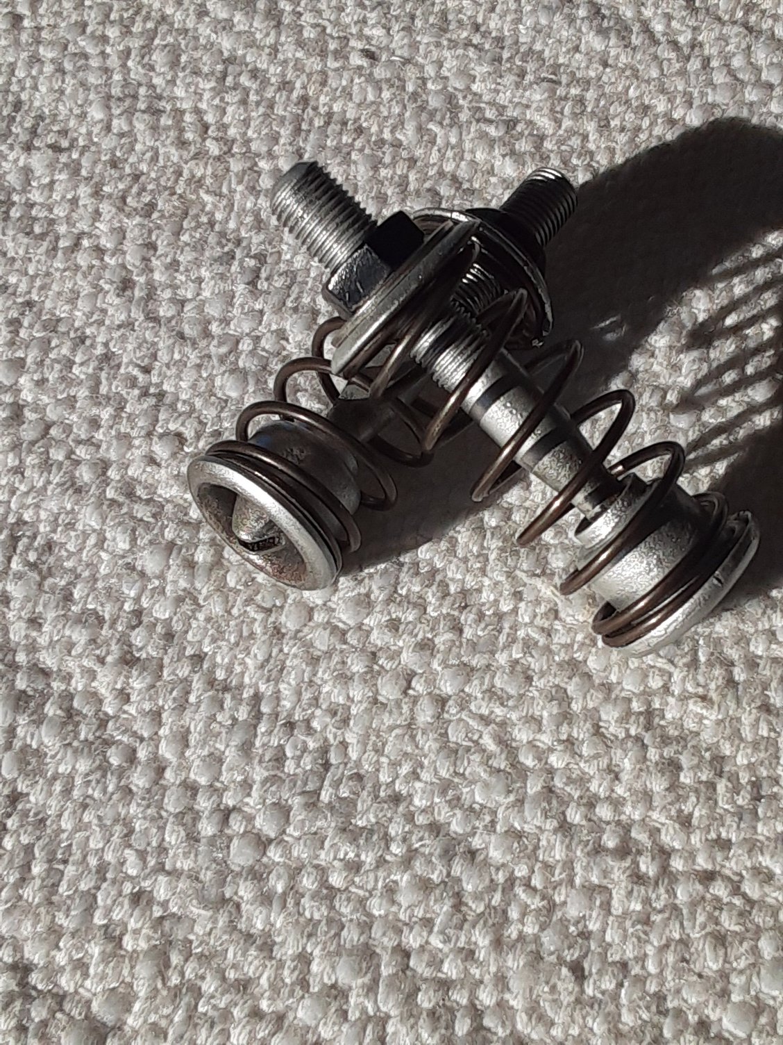

I wanted to document this and make it easily searchable because every time I open or close my hood it's so satisfying. Thanks go to Jeff Chandler (Yellowseries3) for originating the mod in the first place and sending me a pair (prev pt #) of springs gratis, and Thorsen for finding the correct substitute part number that is the identical spring to Jeffs. The McMaster-Carr part number is 9657K521 compression spring, 2.5" long, .975"od, .827" id, pack of 6. It makes opening the hood so much less dramatic with the hood clanging up against the stops, and closing the hood is so much more civilized, it just drops down uneventful like a refined jag should. It's such an inexpensive gratifying mod that I think it should be shared. Thank you to both Jag friends.

I can confirm these springs work great. I put them on my car yesterday and it makes closing the hood - and keeping it closed when driving - so much easier!
The original spring on the left, Slofut's spring on the right.
