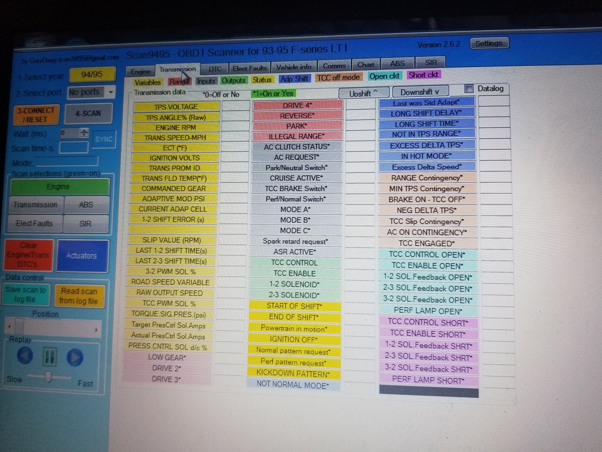

Everything is rebuilt including the converter, new cooler installed as well. The reason for doing a higher speed run is the pcm was retuned and transmission files.were altered as well, i can hook laptop to car as it is obd1, and can watch commanded gears, at 45 mph it atill hadnt commanded 4th, and you are correct what i was feeling was the tcc, therefore i need to drive it at a higher speed to see if 4th ever gets commanded.
i have a spare pcm that has a stock tune on it, so if i cannot get 4th gear commanded i can swap the comouter out, but would have to go in and disable the vats first.
i dont have any trouble.codes, but i do get an error on the scan software when trying to read it saying tps raw value incorrect, however tps is working correctly as i can also watch it, i can watch the sweep and the voltage.

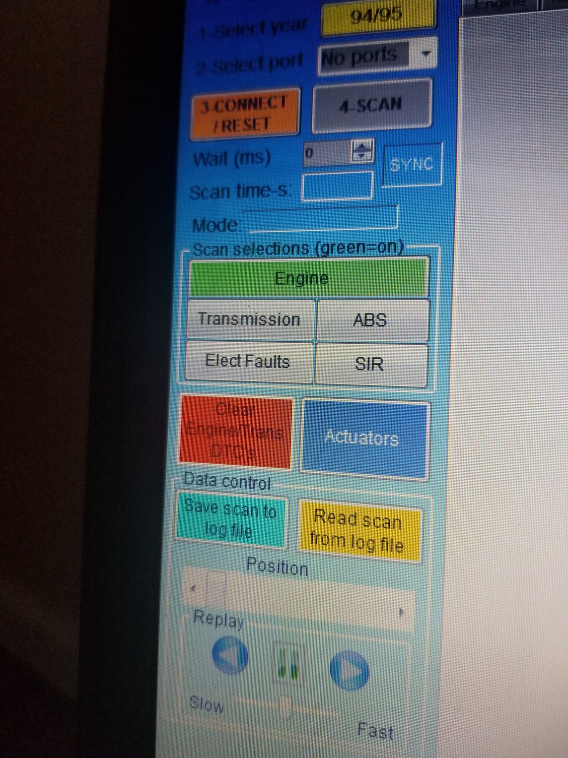

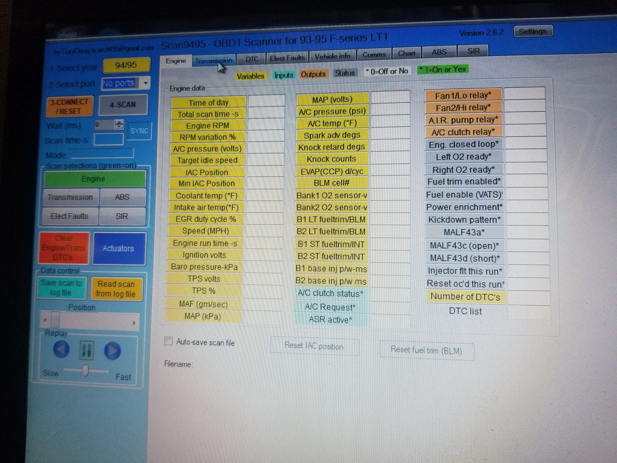

The reason for not going with a stock tune is the engine isnt running optimally with the cam.and rockers etc, i wanted to make sure everything was optimal before sending back to shop... i am using scan9495 for code retrieval and to watch everything, i can also create logs and watch them playback later, its a fantastic program and free to boot, just just need a laptop and in my case an ob1 to usb cord attached are a couple of screen shots... of course car isnt here so i cant show it hooked up...
