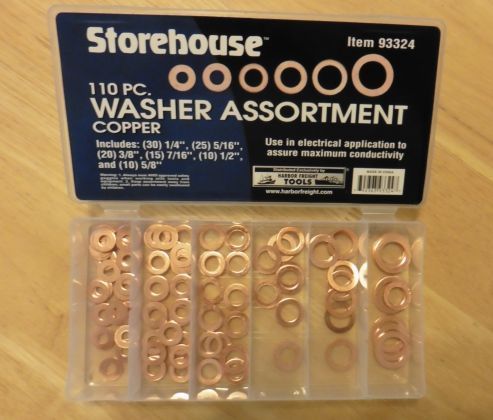

The first time I reinstalled my PS pump in 2015 I had to put copper washers under the high pressure fitting (I don't remember how many but more than one), and then put a LOT of torque on that fitting (at one point I was afraid I'd break something) to Finally make it stop leaking all over the floor just as Randy describes.
It's so tight right now that I went to Great lengths NOT to loosen that fitting (and therefore the pump) when replacing the crossmember recently.
It's doubtless a Kludge way of doing it, but ya can't argue with success, and the pump/fitting does not leak to this very day.
