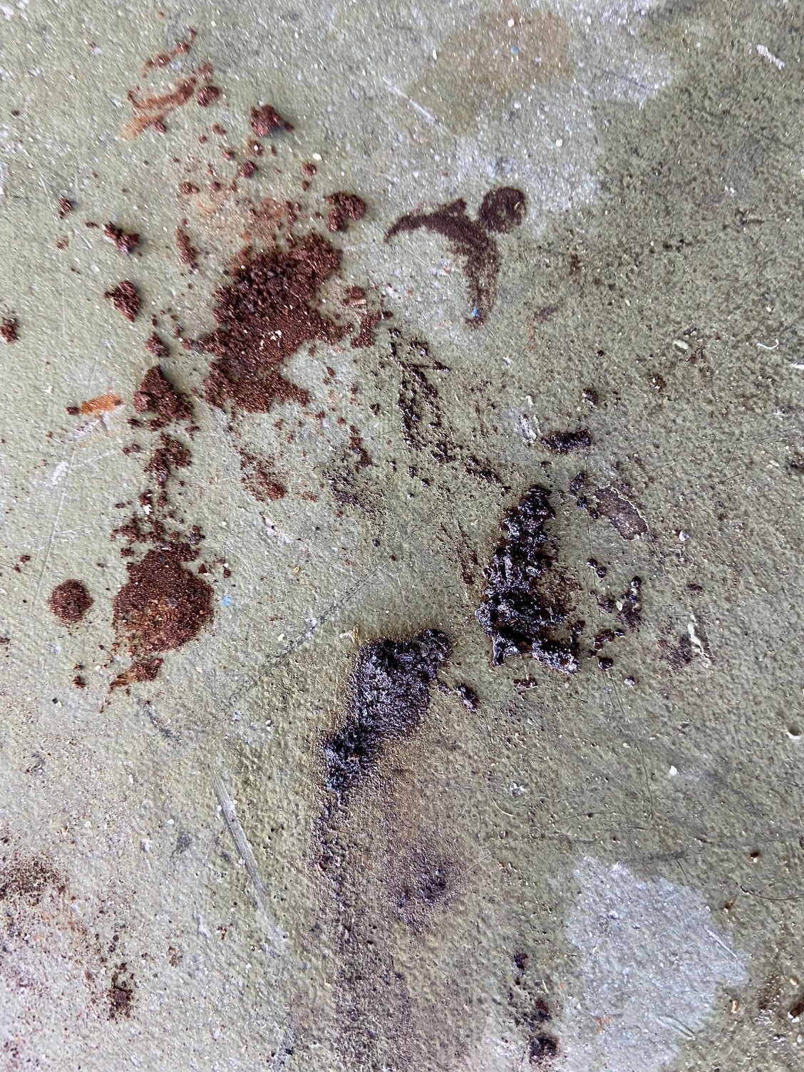

I have the cleanable filters, so that’s not a big hassle, I have cleaned the filters out, pumped the gas out of right tank into fuel Jugs and have just shot a pressure washer wand up I. From tail light, the amount of crud that came out is unbelievable!, it’s currently airing out and I amusing my compressor to force air in too! If this works, I will move to the left tank,
Crud from pre filters
Crud from tank( not the leaves) lol
In tank filter/sock

Tanks are original to car, so 38 years old, the odd part is, when I looked inside gas tank, it was only cruddy on the bottom, side walls looked quite nice, just a goldy looking tarnish ( for lack of a better description) if new tanks are in my future, so be it, it’s just nuts and bolts, probably the only ones I haven’t touched yet! Lol
