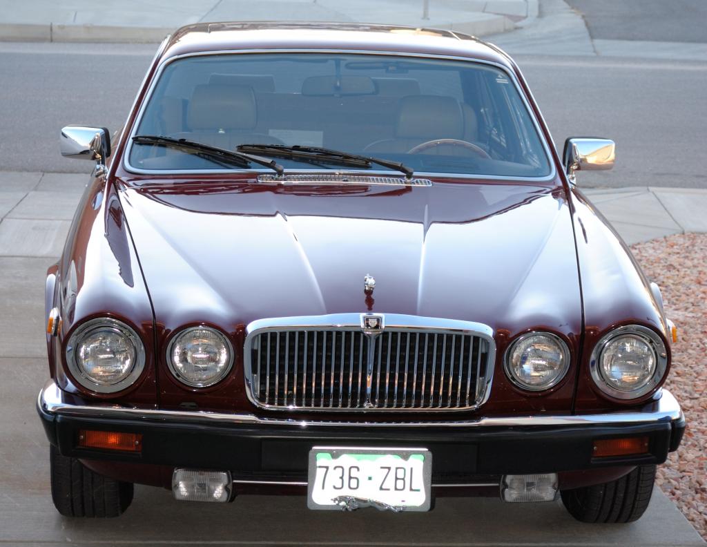

On Ser III cars the UK/Euro/ROW were basically the same in appearance except the black rubber part sticks out only about 1" rather the 3.5" (or so) on the USA/North American bumpers. A much nicer look :-)
Some have nearly duplicated the Euro look by collpasing the engery absorbers (drilling a hole to let to goo run out) and simply pushing the bumper all the way inwards.
I'd try this first before attempting to retrofit the actual UK bumpers. The parts and mountings are entirely different. Would probably be quite a project....even after you've sourced all the parts and had 'em shipped from overseas.

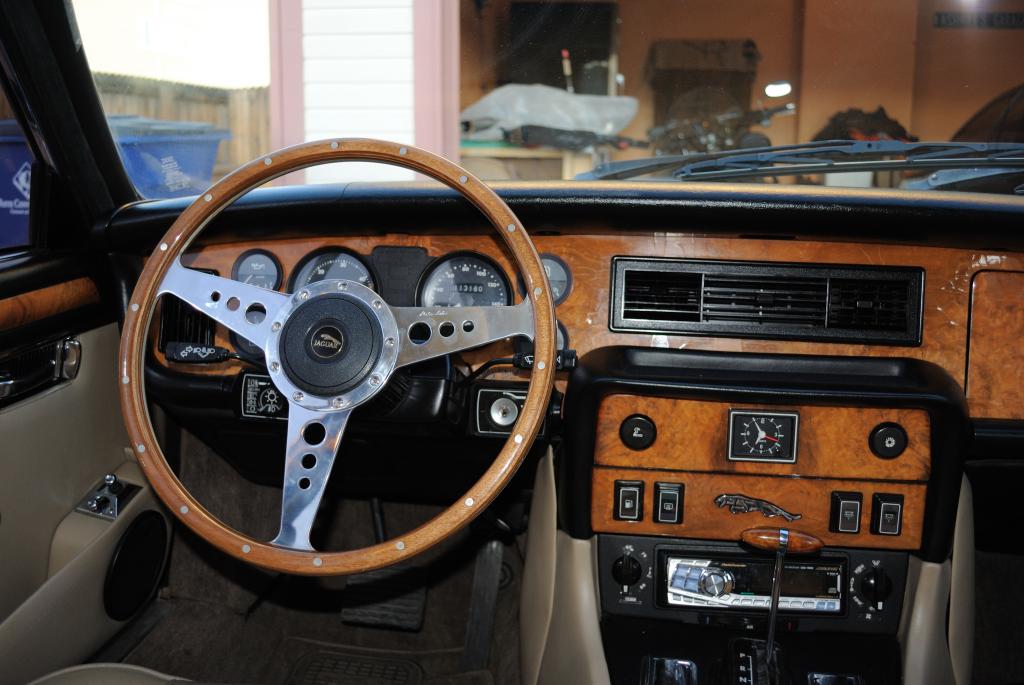

Mine is a Sovereign and I think has all the UK bits as it was imported from Mexico

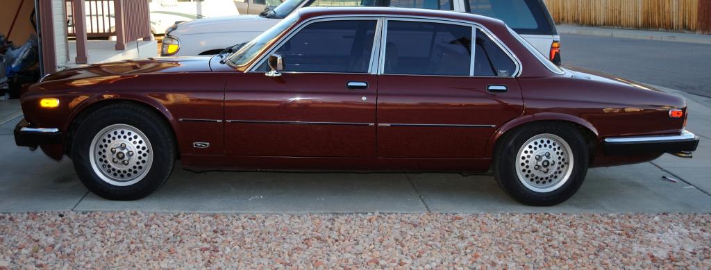

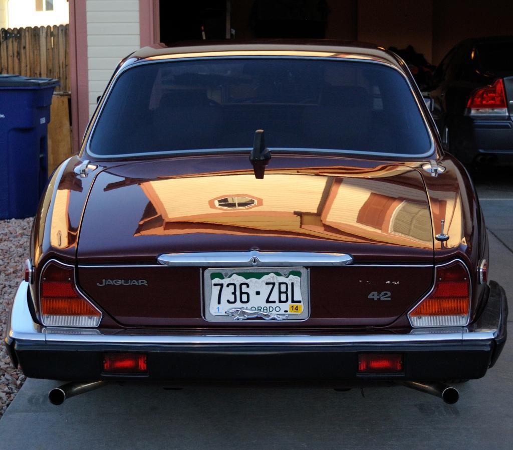

A very nice car. The bumpers look just like the ones on my 83 US version. I thought that the US light switch was equal to the Uk version except for a circlip to prevent it moving to the fog position. One of these days, i may open mine and make that change. The wires for the fogs are dangling in the rront of the radiator!! I have a pair of Hella lamps that are period correct.
And, well, well, my license plate frames are like yours. I chose gold for one end and silver for the other. Just to be different.
Shame, my car needs a wash, polish and wax to approach the sheen on yours!!
Nice steering wheel. oh yeah,

Some of the notable things about Vaughn's Sovereign vs the US base are:
The front and rear bumpers...The front has a wider license plate area, to accommodate the long UK plate, and the rubber is narrower. It's only a couple of inches wide vs like 4" or so on the US... The rear bumper has the fog lamps in the back.
The superior Pepper pot rims ... (Just noting that in case a friend who opposes Pepper Pots reads this)
The clock in place of the trip computer.
The seats and door cards that resemble VDP models. The rear seat is specific to the Sovereign (Not like the VDP)
His car has rear opera lights.
Recessed gauges in the dash, and burled veneer.
Some later Sovereigns and VDPs were equipped with wipers on the front headlamps
Sovereigns and VDP models had a cigar lighter and astray for the rear passengers
On the Sovereign, both the driver and passenger seats had the power tilt option.

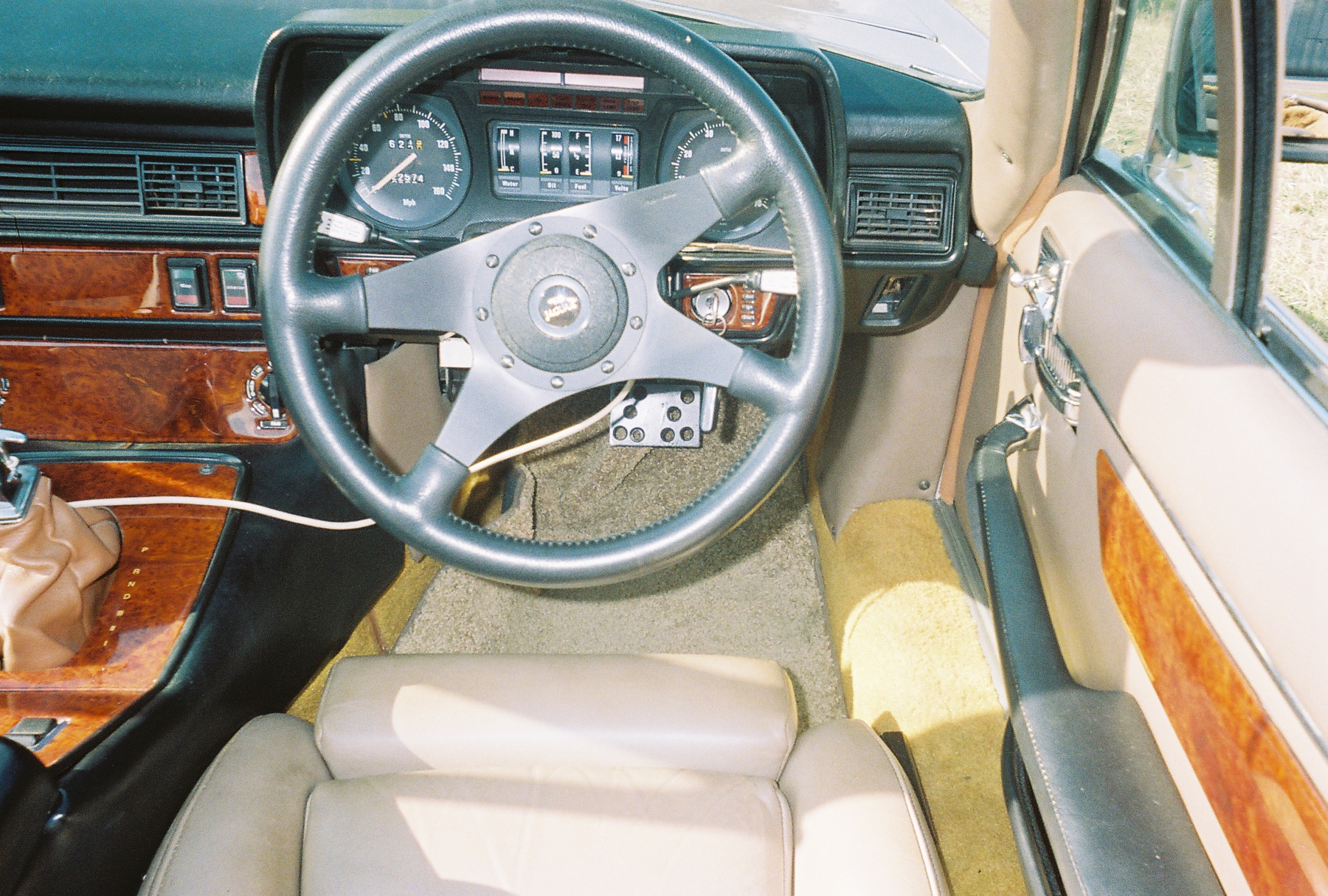

a genuine UK version would be RHD, right hand drive!
