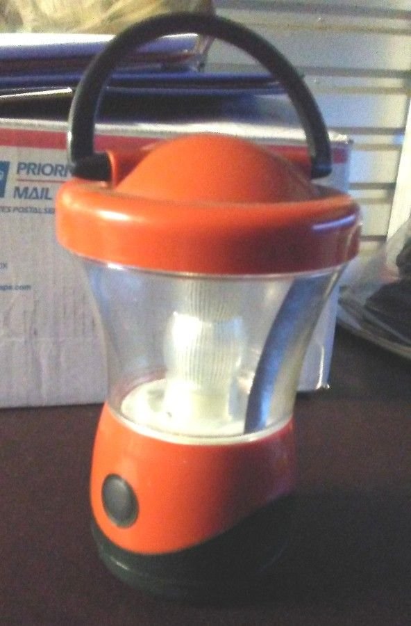

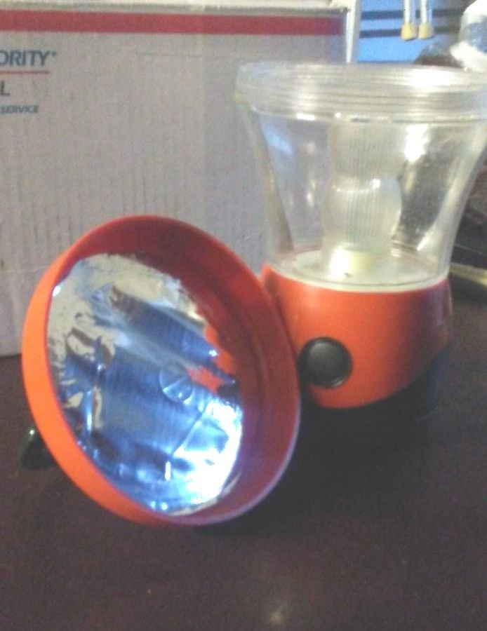

here's an example:
a camp lamp. As lame as it can be.
I added aluminum foil to the inside of the lid and light output increased by about 25%.

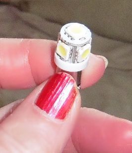

Dave,
One of the most useful upgrades I made in my car was an LED in the Opticell.
Has 5 elements. I can even see the light switch with this.
