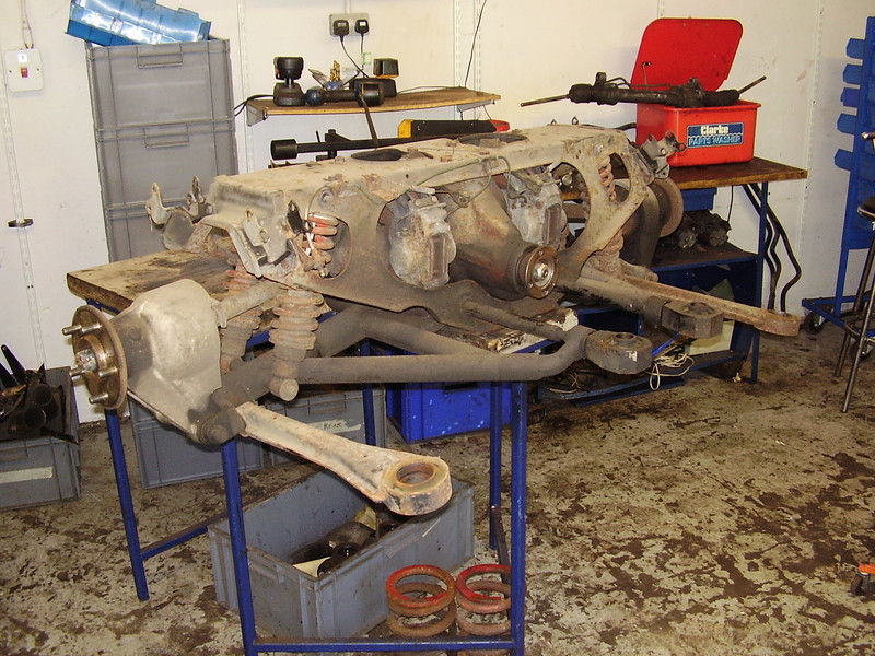

I have attached a picture of a Lister XJS rear end, these were fitted with additional A arms and chassis rail mounts to strengthen the rear end.

If you google XJS Lister KWE in the UK have a one restored and a great photo gallery. The rear end needs to be braced from under the diff to the chassis. Best way is to brace from the inner fulcrum points to the chassis rails just behind the gearbox.
I have had a good look around a Twin Turbo XJS V12 race car and this brace runs under the diff to the boot floor, the floor of the boot is rippled from the movement of the cage. This car does have 300mm slicks and enough torque to break 2 Jerico race boxes.
