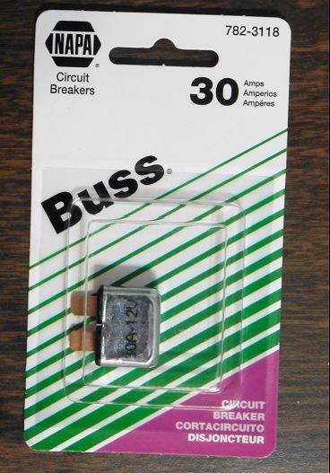

I was skulking over in Another Jag forum, and one of their Gurus posted the part number of a replacement thermal breaker he says, from NAPA!
BK 7823118
30A blade circuit breaker for windows and locks.
I plan to pick up a couple of these, cuz even if they require modification they'll be better than what I have now.

Wow & thanks. I paid $10 & UPS shipping for used. I'm grabbing the dogs & rushing down to our favorite NAPA to pick one up. Might have to tie wrap it in place.

Ok, I've lost the used one I bought, momentarily. The napa 30Amp is smaller in size, spades are shorter, but spacing appears to be the same per memory. More as search continues.

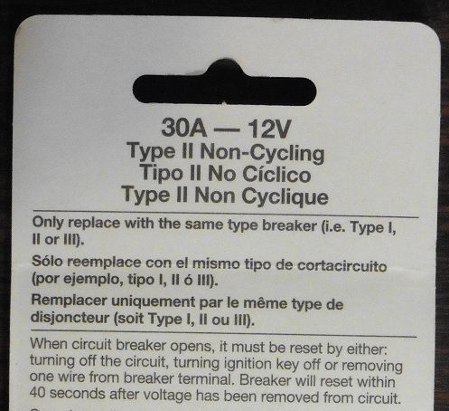

I picked up one from the local NAPA store.
Cost me a hair over $5.
It's quite a lot smaller than I thought it would be.
Also, requires power be cut before healing itself. But turning off the key is said to do that.
As Central Locking in Series 2 is 'hot' and operable at all times, key on or not, if I manage to trip this one I'll have to pull the ground strap to reset it. But it would doubtless work very well as a window circuit breaker since that circuit is key controlled.
