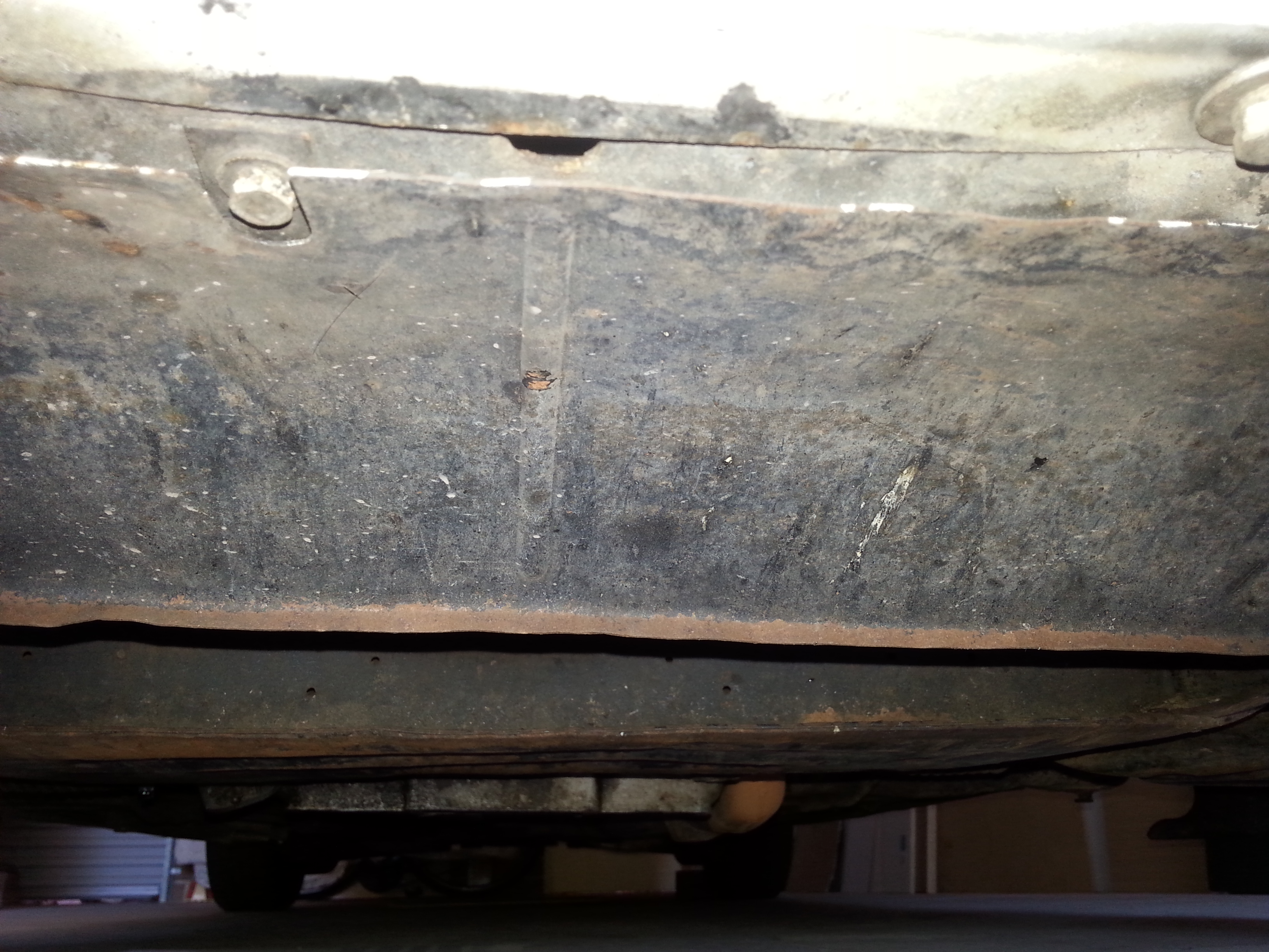

Steve, there is a metal stone guard fitted, extending from the front valance, but it's only about 8" deep. If this isn't on yours, and since the mounting points/bolts should be there, it may not be too difficult to fab up a homemade under tray?

The pic:
BTW, I have the electric fans as you know, but I haven't experienced the standard cooling fan on this car to compare. The electrics definitely keep the temp where it should be.
