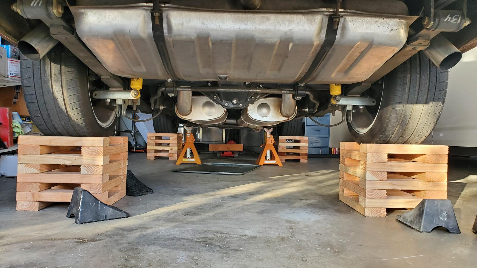

Really depends on what you're doing. For me a quality jack and 4 six ton jack stands is the safest and quickest way, I do lots of engine out work were I need lots of side access. Lots of pinch points on these small and mid rise lifts too. I had a mid rise... Basically useless for anything but wheels off jobs so I sold it for a small loss and went back to jack stands.
You can make you own custom height wheel cribs for about 50$ even at today's inflated lumber prices.
Why have I never thought of that? We've got a joiner building a new dormer on our home at the moment. Loads of spare wood and I bet he'd do this for me in an hour...
