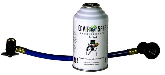

Enviro-Safe Proseal Kit for 134a Auto Systems #9830
Stop Leak & Sealants
You need to use about 80% capacity of R134a in an R12 system. Overcharging will lose efficiency quickly.
