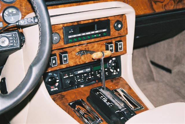

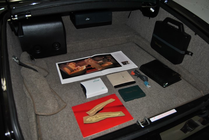

Doug is correct - it is quite straightforward but I always had the stereo shop where I bought the CD unit do the installation. I used one of the ashtrays to hold the CD controller (the wire coming up through the bottom); it fit perfectly so that with the ashtray closed there was absolutely no indicatation in the cabin of any alteration. Since the CD modulation unit uses the FM function of the radio (on an unused frequency) it also uses the existing aerial.
No matter how "low key" a modern radio unit is, it is out of sync with the Series III interior, in my opinion. One note, though. The very last Series III V12 cars used a remote CD changer and an upgraded FM head unit in the dash - everything was controlled there - this system was also an Alpine system, factory installed. The first photo below shows a 1987 V12 VDP with the FM modulation CD changer in the trunk. You can see that there is no sign of it in the cabin. The second photo shows the trunk of a 1992 V12 VDP and the mounting location for the CD unit - whether factory installed or an aftermarket FM modulation unit. The third shows the 1992 Alpine head unit that controls the CD changer in the trunk as well as all radio functions.
Attached Thumbnails Radio upgrade-f1160013.jpg   Radio upgrade-1992-v12-vdp-001-small-2-.jpg   Radio upgrade-1992-v12-vdp-006-small-.jpg
