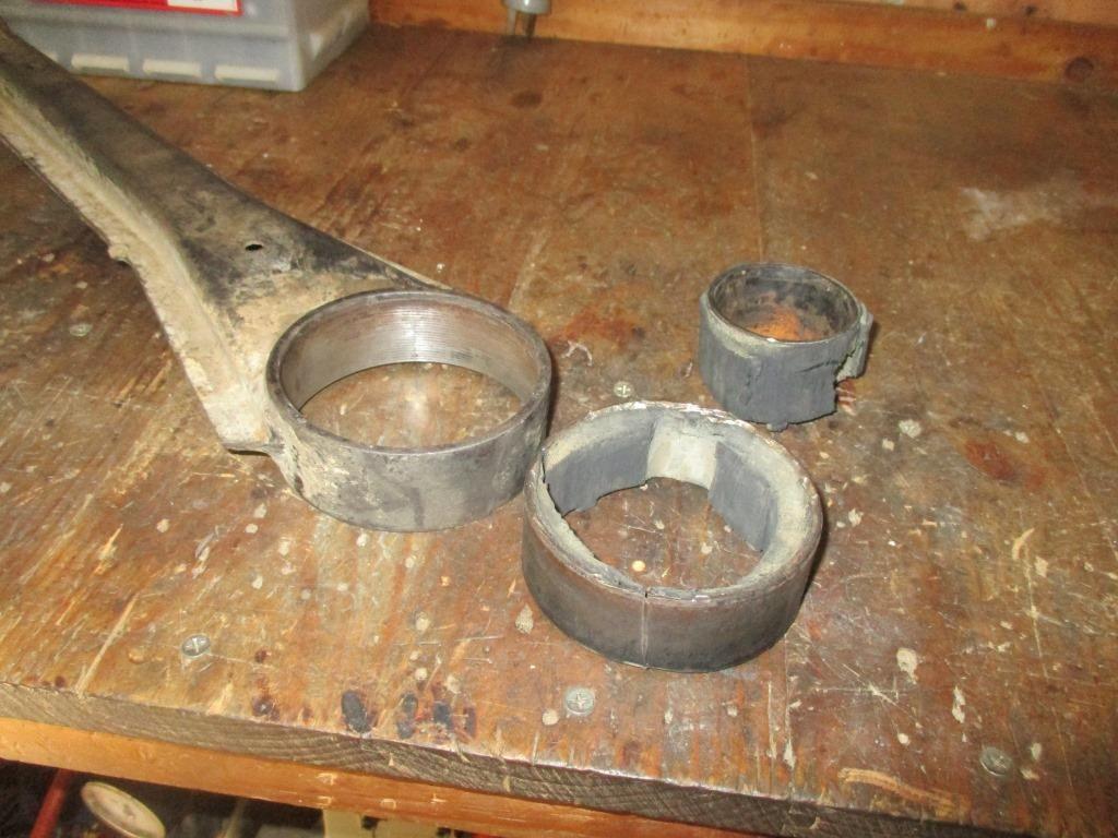

My car is almost 48 years old, and one of the few rubber parts that have not been renewed are the rear suspension radius arm bushes. Some months back I purchased a new set of metalstik bushes. Now I am looking at installing them
I pulled one of the arms off my spare car and proceeded to remove the bushes. I found the best way to do so was to use a jigsaw to cut the center out, and then hacksaw a groove in the bushing case. I found you can do this with minimal damage to the arm itself, the bush can then be worked out with a cold chisel. The lip on the arm housing is on the car floor side. It's purpose seems to be to locate the bush in the correct position.
I measured the inner diameter of the sleeve and found it to be 88.7mm. The new bush is 89,0mm! Clearly a large press is needed to expand the sleeve to push the new bush in.
Now all my research seems to call for a 30t press to install these bushes. But how about the old method used for fitting tyres to wheels - heating up the sleeve and then pushing in the new bush. Has any one tried this method ?
