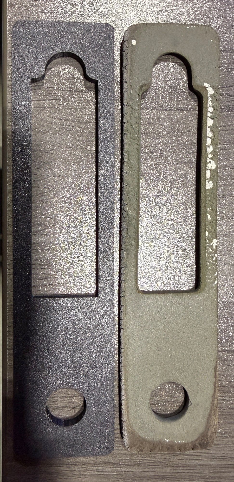

Hello,
While I do not have any help for you with that info. However, I was having the same issue as you only for my 1976 Jaguar xj6L.
Luckily I was able to produce a design that is pretty accurate and 3d print it out of TPU material which is pretty flexible. You could
Check into something like that for your series possibly. I for sure am not a design expert, and my husband says I've bit off to much trying to repair my car myself.
However, I couldn't find anyone around here to work on it, and this ole girl wants her car driving again.
Just my first go at 76xj6 reverse light bezel gasket out of TPU 95A  on a 3d printer.

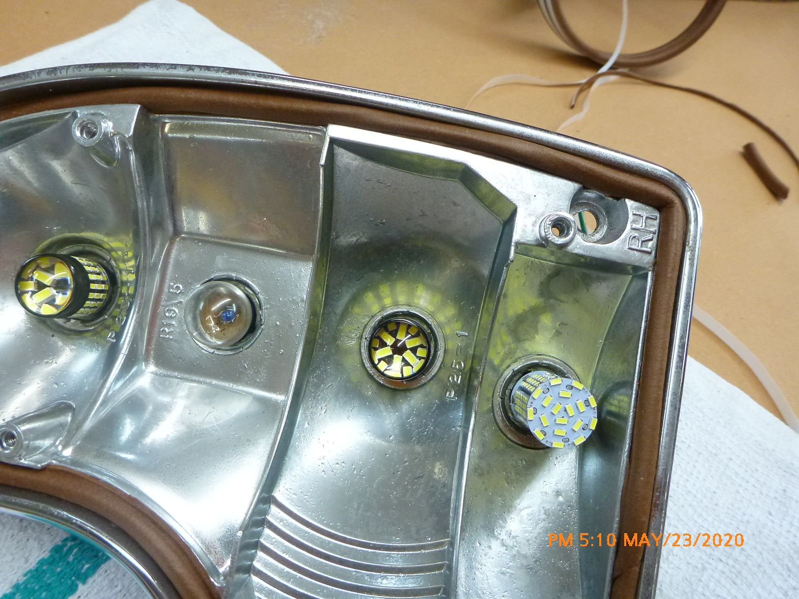

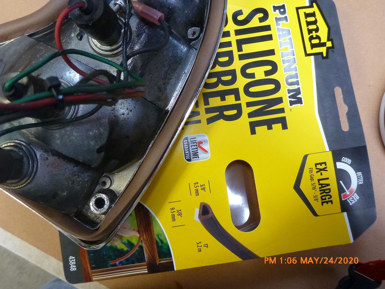

All good suggestions. Here's what I used.
Dave
