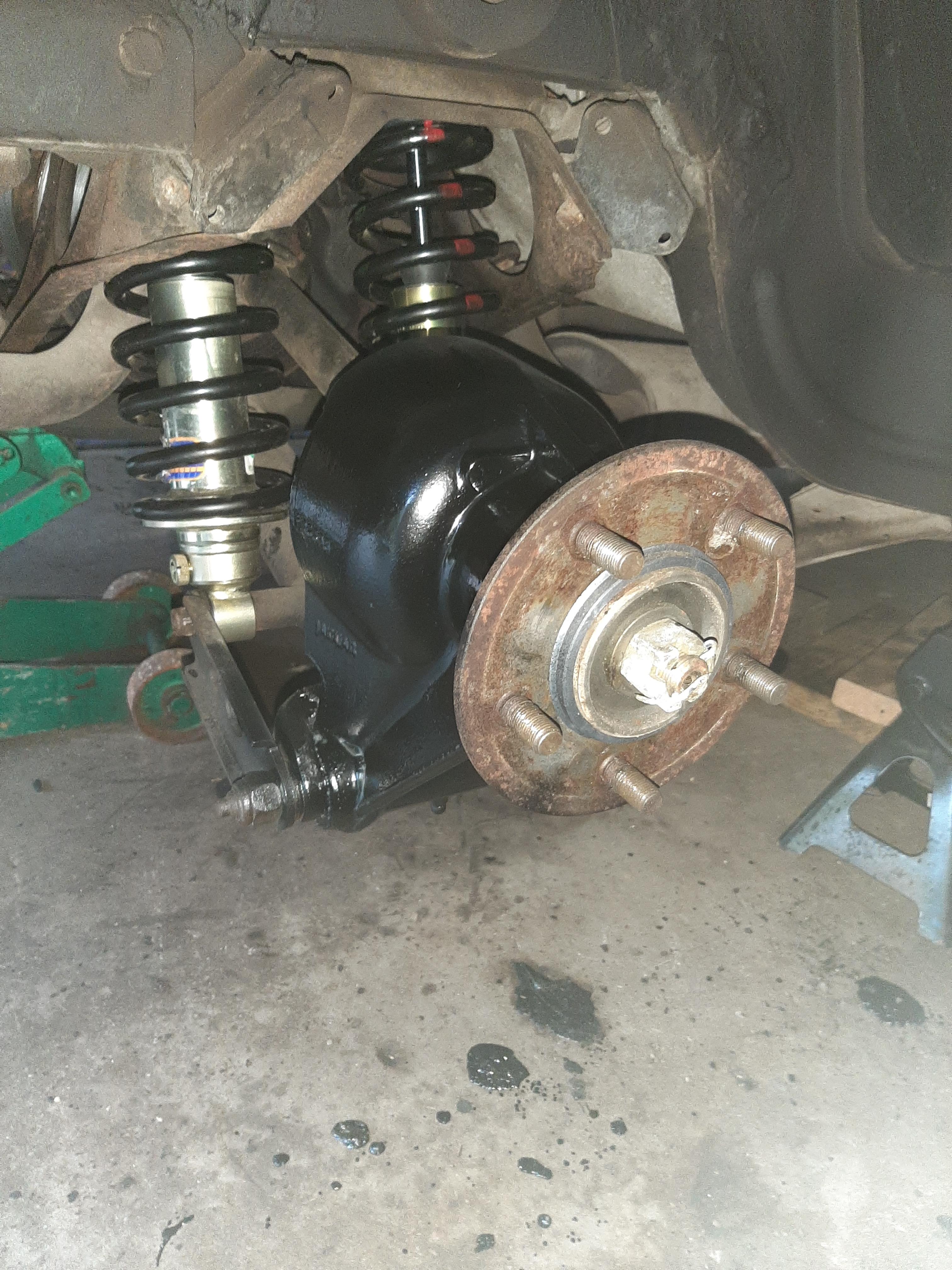

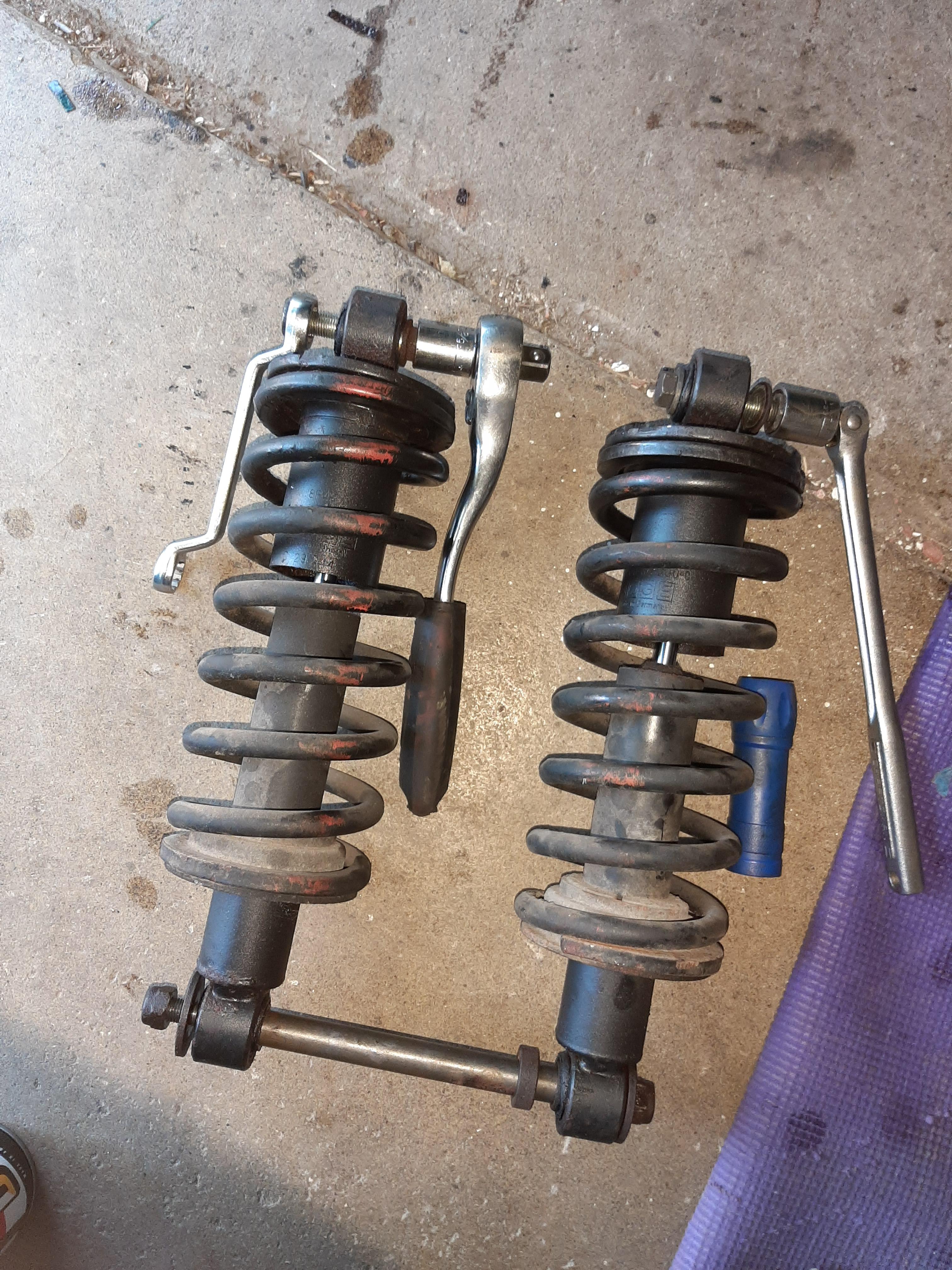

Hi: I just finished mounting new springs onto adjustable GAZ shocks and installing the 4 assemblies. Here's a few photos that might be helpful to members that might want to tackle this using whatever shocks one chooses.
Like any job, apply rust buster many times before and remember where the washers and spacers came from so assembly will be correct.

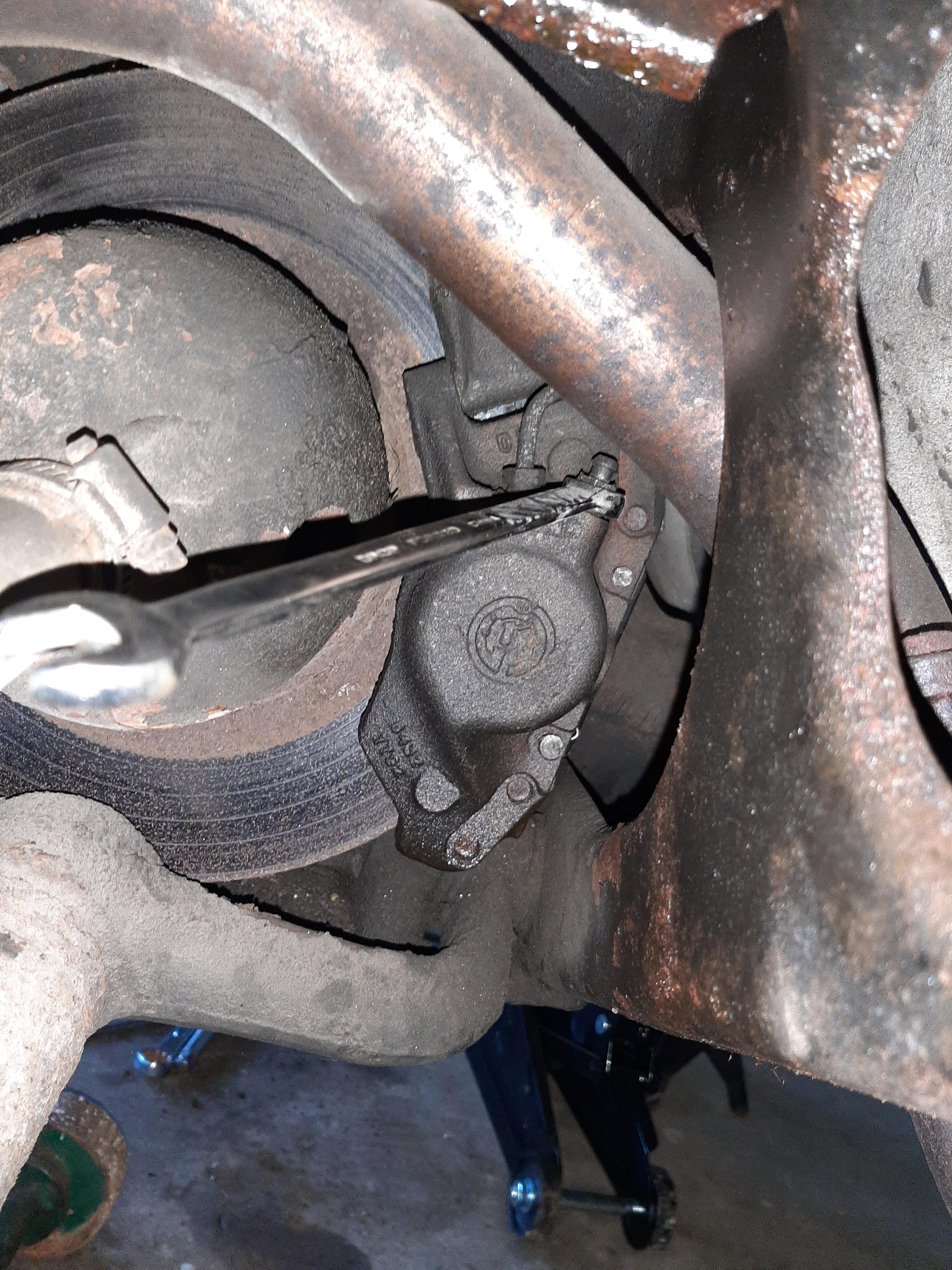

Also, you get a straight shot at the rear caliper bleeder valve when the inboard shock assembly is removed and the cross over exhaust pipe is gently raised an inch or so using a block of wood and a floor jack. It wasn't to bad a job. Hope this helps.

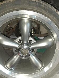

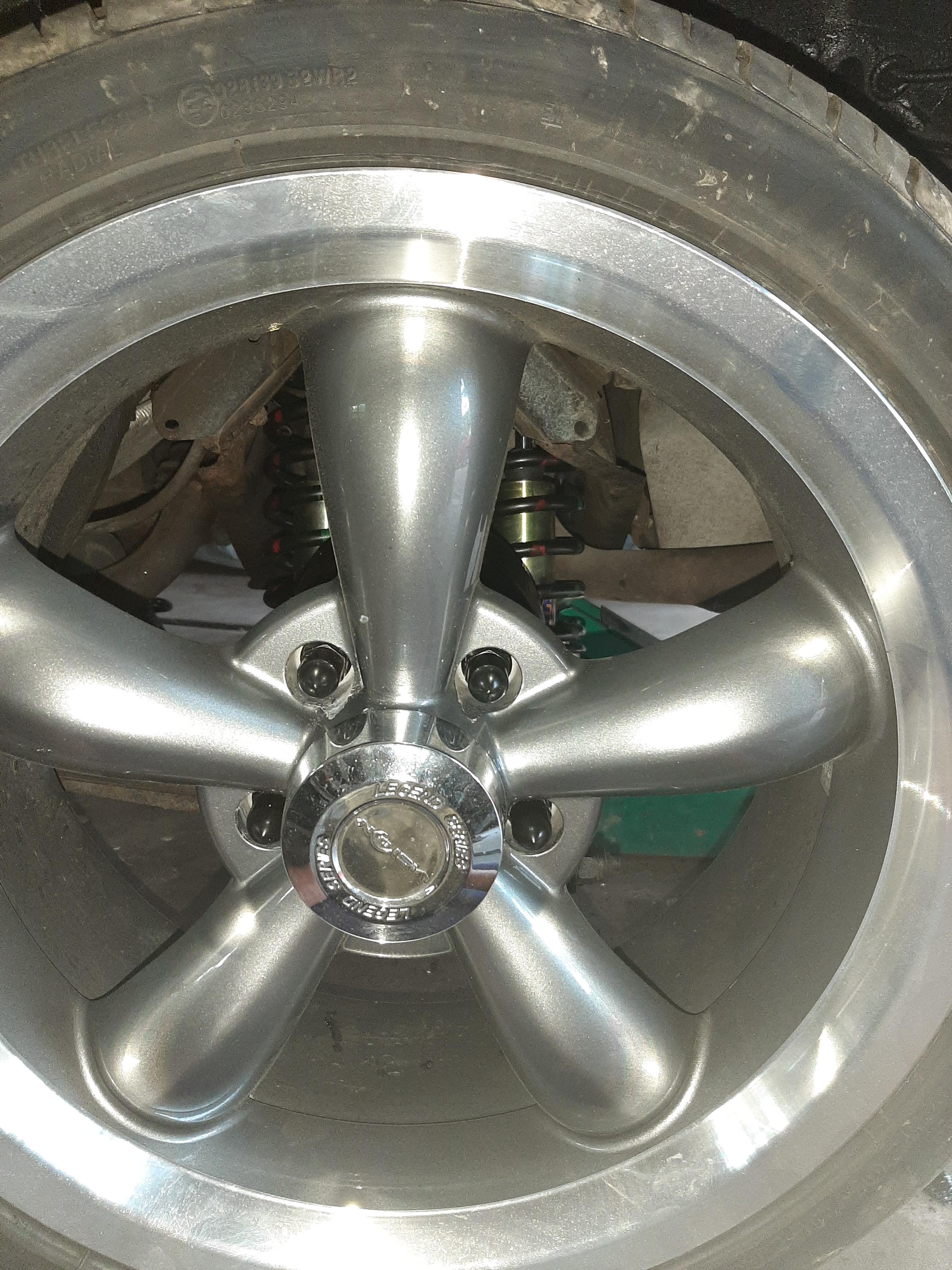

springs/shocks in. even painted the hubs to match the front calipers. also wire brushed the inner wheel well and fender lip, coated the fender lip with por15 then sprayed the entire wheel well with undercoating. at least it looks cleaner and maybe even ward off the evil rust monster:}
looks better through the 5 spoke wheels. it's hard to see but i went with the black bullet nosed lug nuts to the old girl a little more attitude.

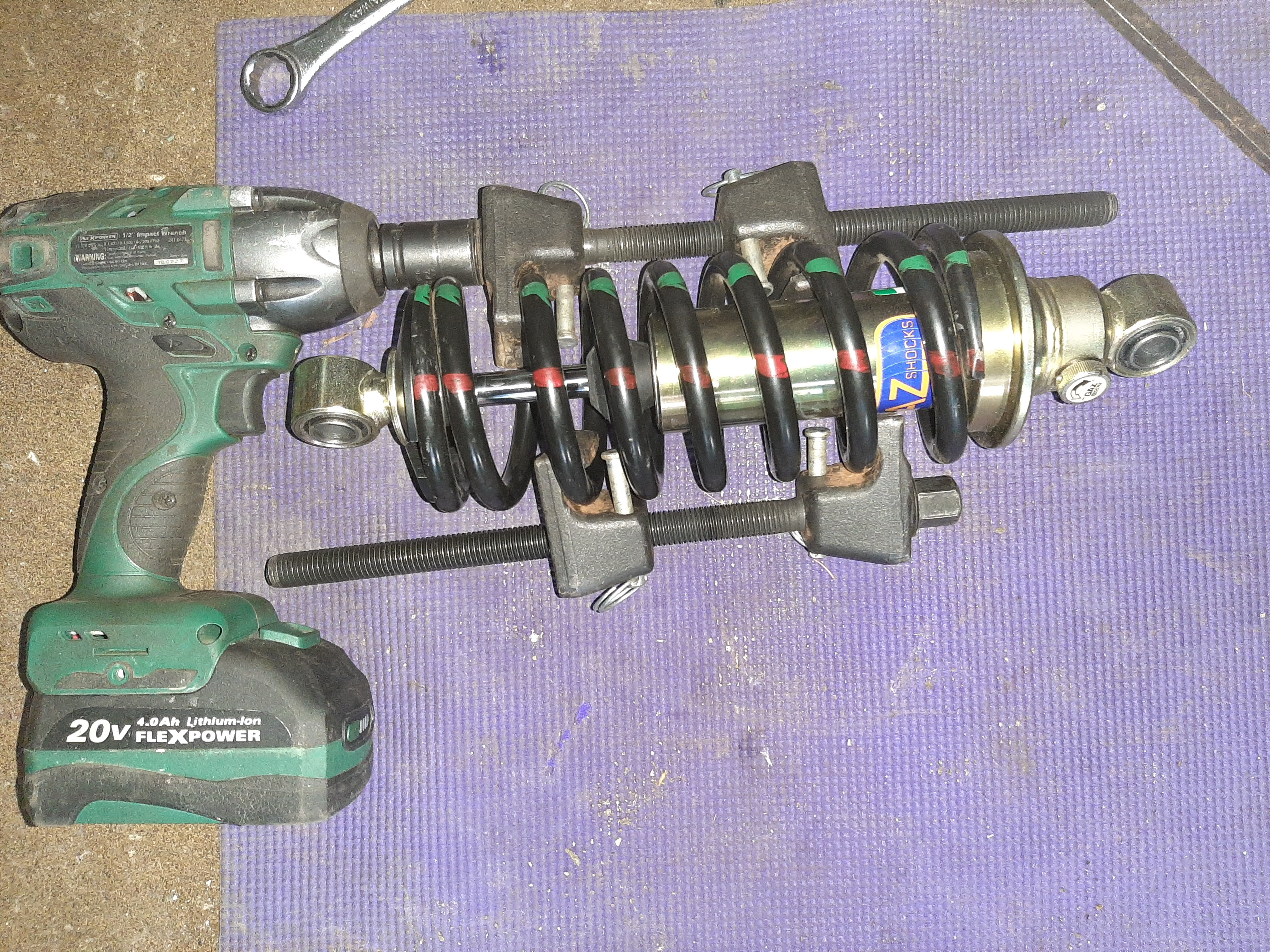

Despite the fact that it sure makes it look easier, Using a impact on a spring compressor is not recommended by any manufacturer. Think about it.
Thank you.
Larry Louton
Old Jul 8, 2021 | 06:26 PM
retroren's Avatar
Joined: Sep 2018
Posts: 482
Likes: 245
From: Metro Detroit
Yup, maybe not the safest if used incorrectly. I constantly rotated the wrench slowly compressing the spring and only compressed just enough to slide the collar. I experienced no issues but to each his own.

I too agree on the spring compressor. We used it to change tires on the race car between sessions. That and a low profile jack really eased the job.
