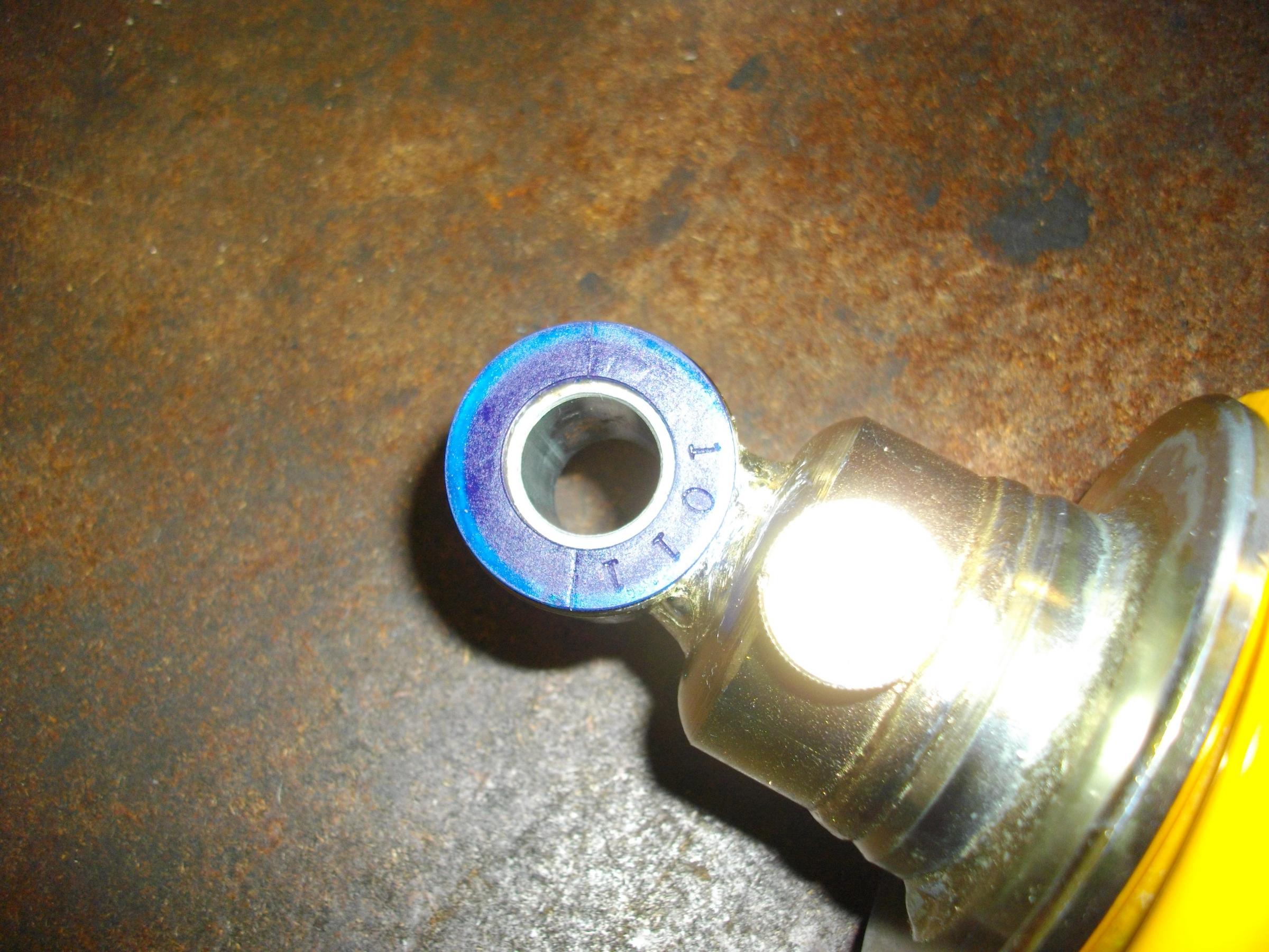

Default Bit the bullet

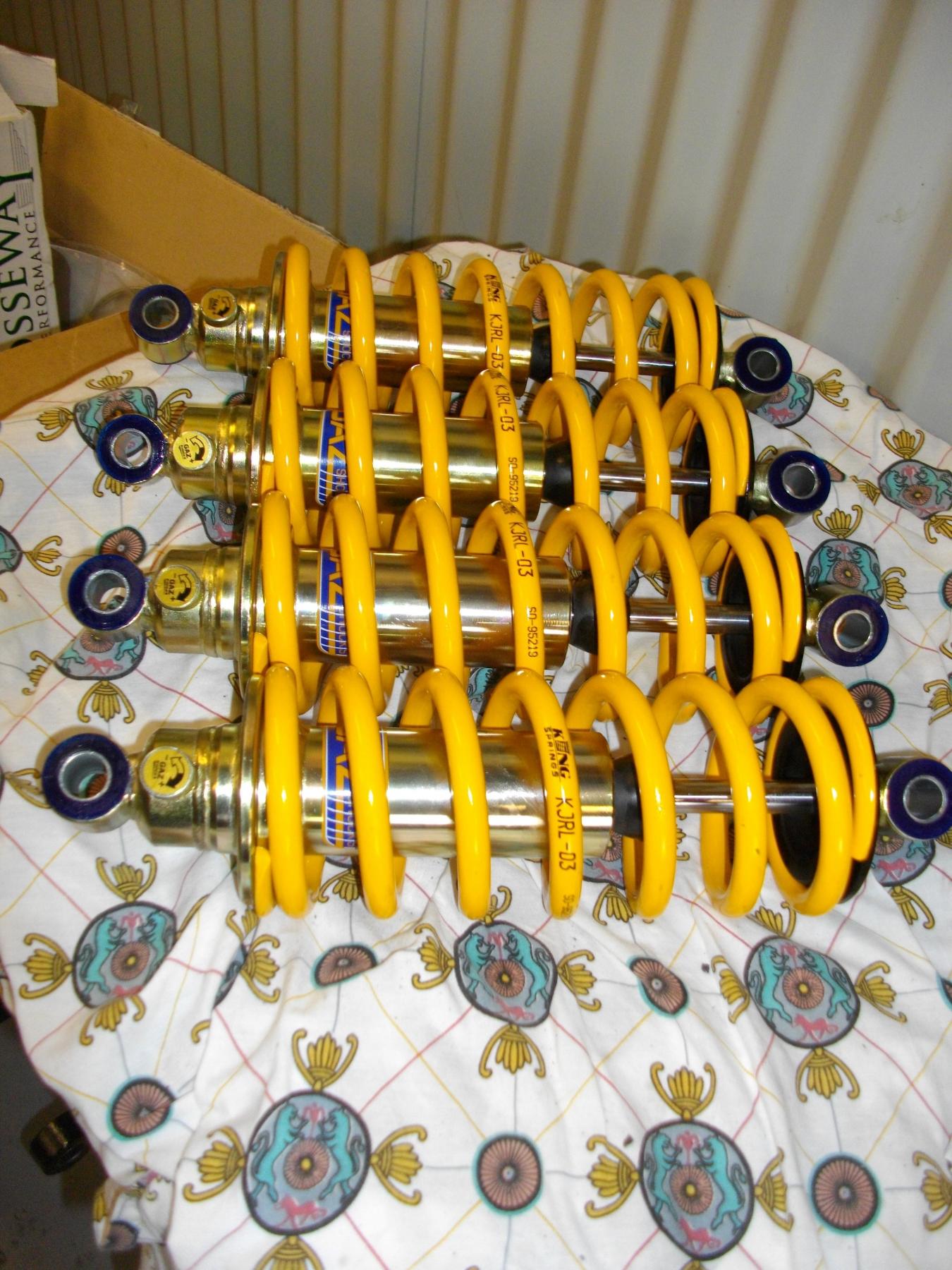

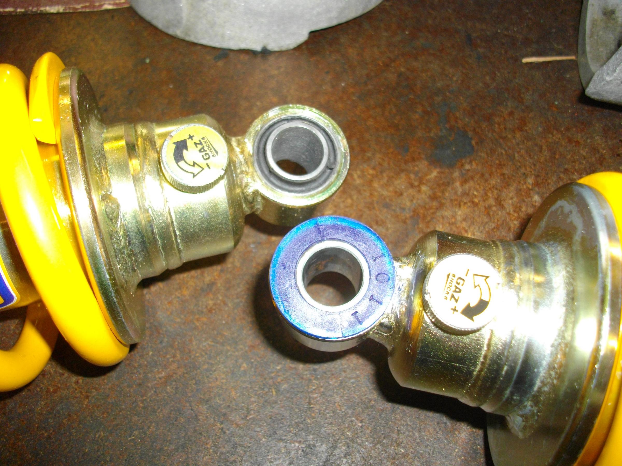

Originally Posted by philg64

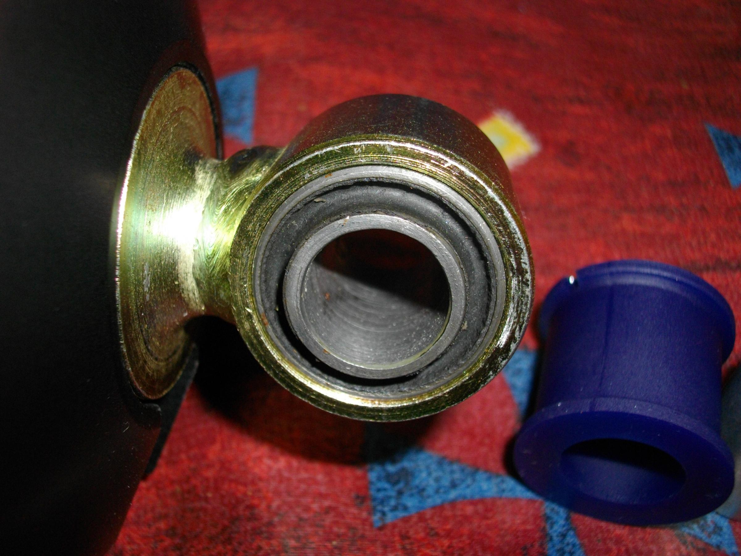

A few months back I purchased new GAZ shocks for my rebuild, prior to that I purchased a set of polyurethane bushes to replace the existing rubbers bushes on the original shocks.
As you can see the GAZ springs came complete with metallastic rubber bushes.
So..my dilemma is - do I replace the rubber with the polyurethane bushes or will it be a waste of time and effort?
Would be appreciated if anyone has had the same dilemma and what did you do and why?
Phil
Well in the end the polyurethane bushes won out. No one gave me a for or against argument for either so yesterday as I was looking for a no brainer task lo and behold the springs and bushes were just there and so i pressed out the old and put in the new.
You watch - now someone will come out and tell me it was the worst thing to do
Attached Thumbnails Rebuilding a Series 1 rear end-imgp4180.jpg   Rebuilding a Series 1 rear end-imgp4181.jpg   Rebuilding a Series 1 rear end-imgp4183.jpg   Rebuilding a Series 1 rear end-imgp4184.jpg

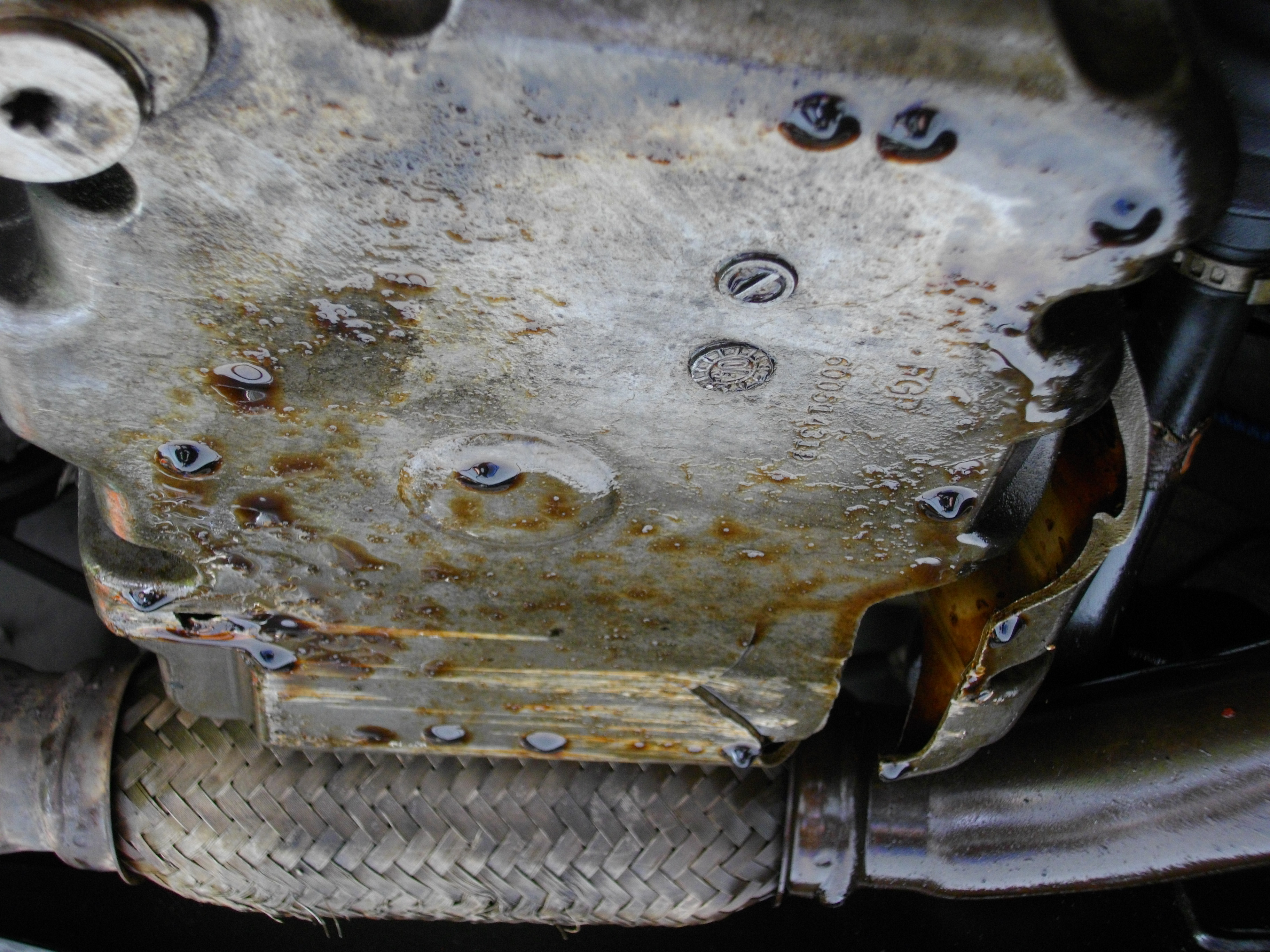

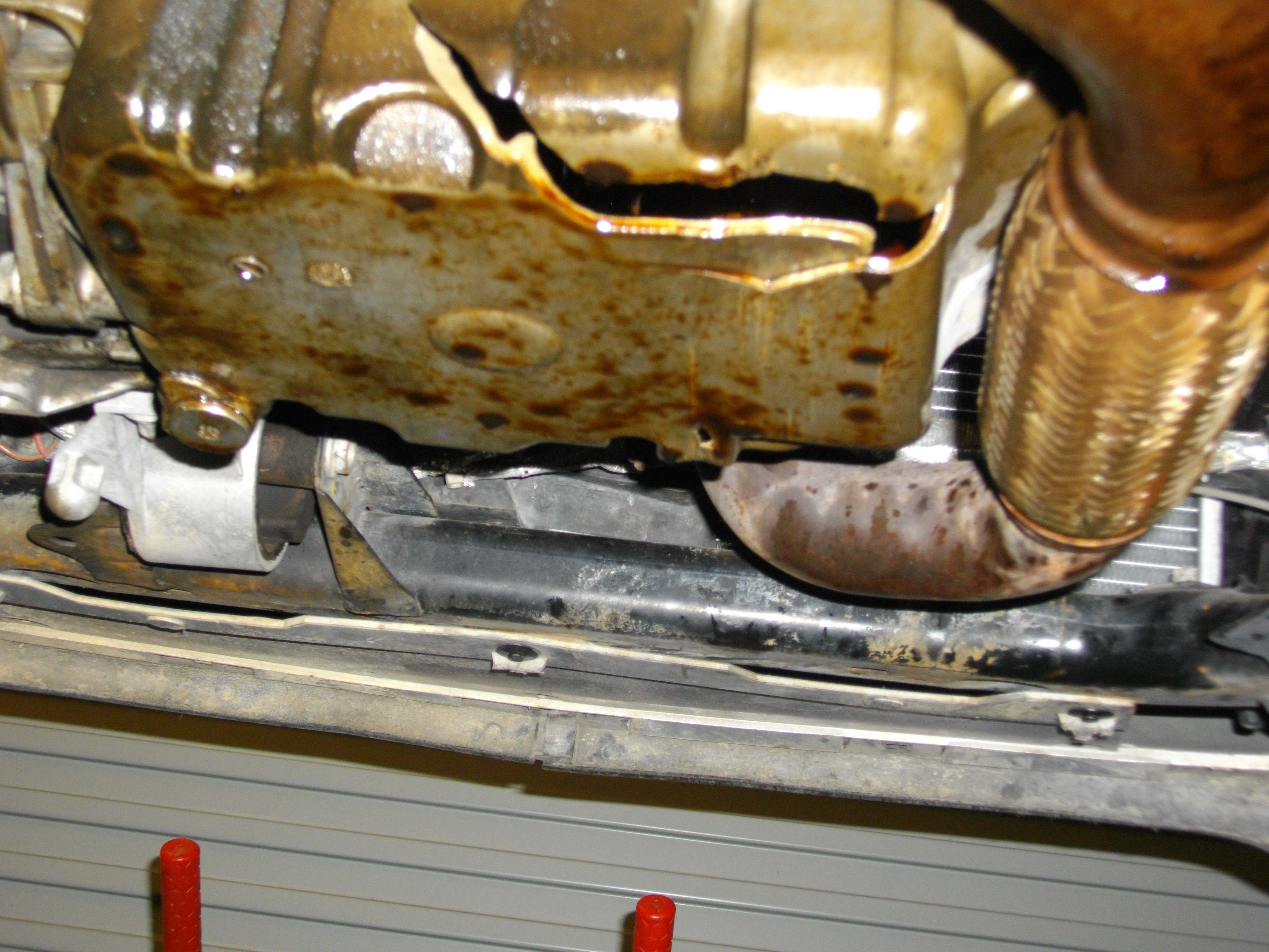

The hoist is in use - my daughter's Holden Astra sump after an altercation with a concrete block on the Eastern Distributor in Sydney.
Currently it is in the shed taking up my workspace.
Attached Thumbnails Rebuilding a Series 1 rear end-af30xg-sump-rear-view-2.jpg   Rebuilding a Series 1 rear end-af30xg-sump-passenger-side.jpg   Rebuilding a Series 1 rear end-af30xg-home.jpg   Rebuilding a Series 1 rear end-af30xg-front-drivers.jpg

Originally Posted by Daf11e
Geez Phil she's hit hard......
Yes, definitely a reasonable hit. Doing about 70ks an hour following a car that swerved into another lane to avoid. But she had a car next to her and a wall on the other side so didn't have anytime to stop or avoid. Luckily she didn't panic in traffic as it could have been worse.
She had to drive about a kilometre before a safety area, so who knows what lies inside? Have lodged a claim with insurance company.
At present getting a quote from the mechanics, with the car not being worth much, I expect written off. The mechanic can't guarantee replacing the sump and then filling up with oil is all that is needed. The cost of a pulldown and inspect would cost more than a replacement engine. So the quote for repair will be for an replacement engine.

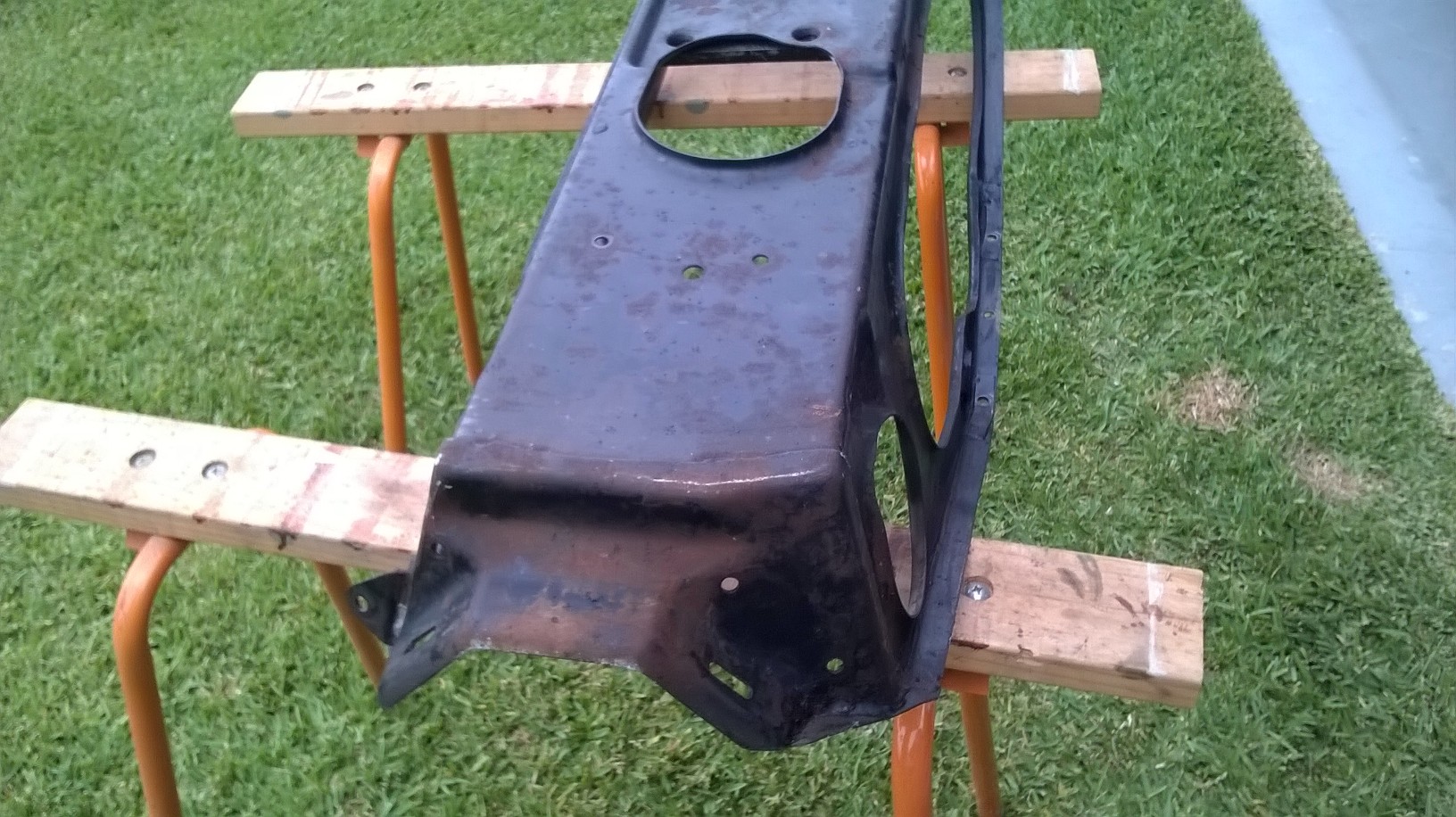

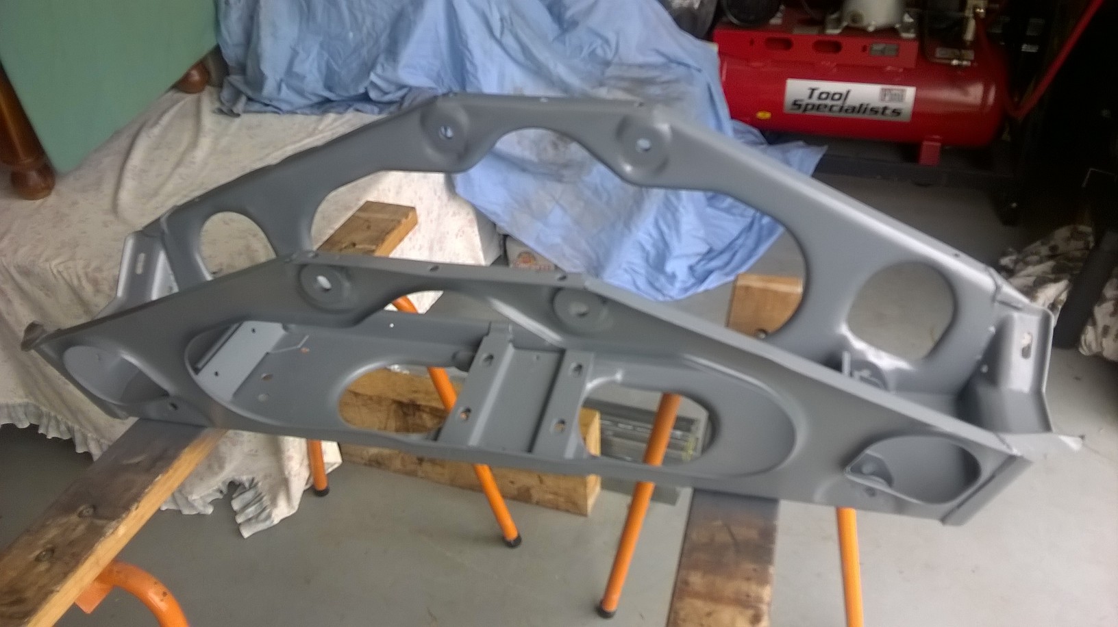

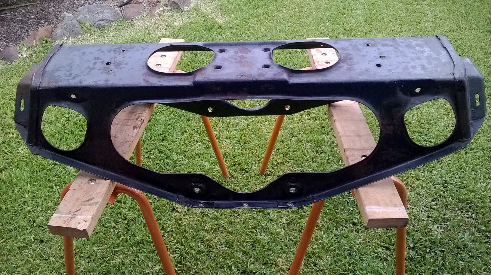

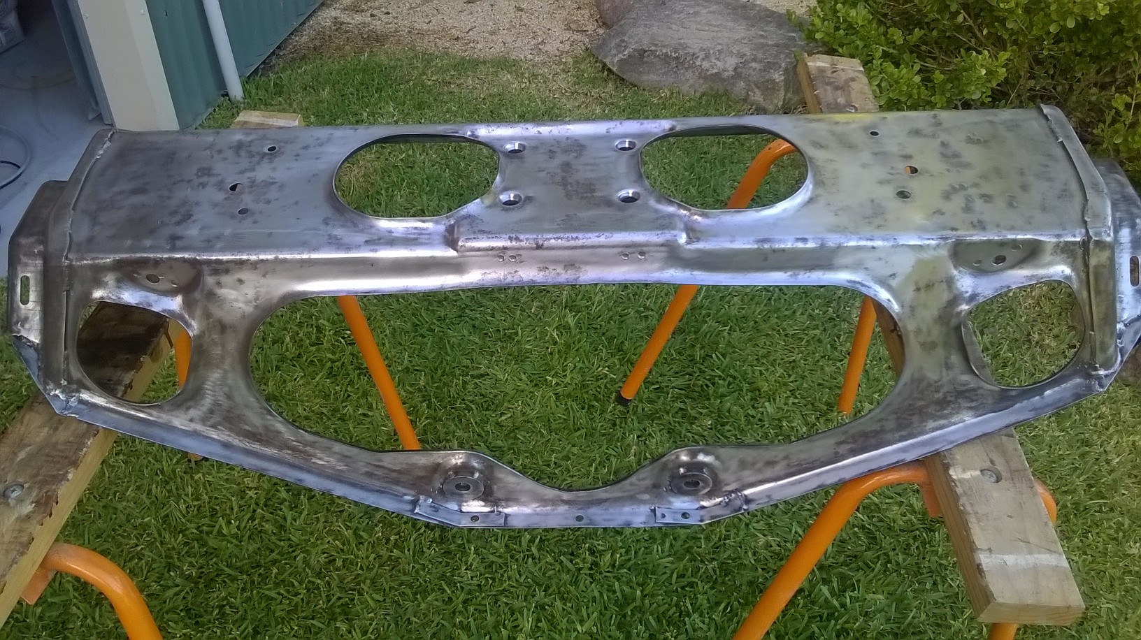

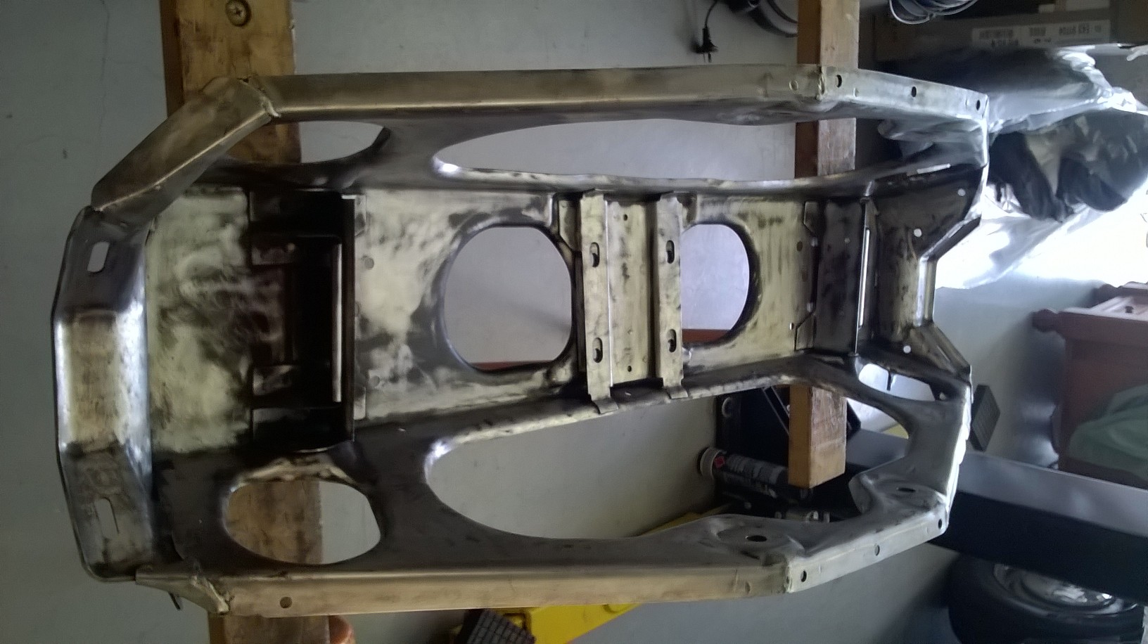

Default Refurbishing the rear crossbeam

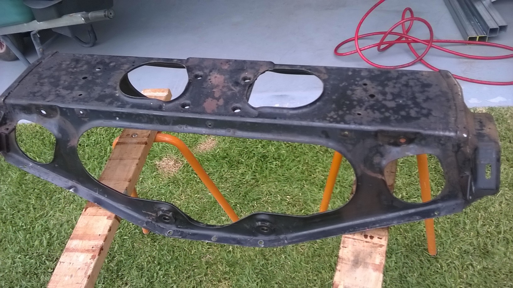

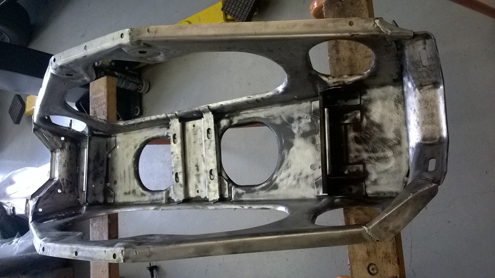

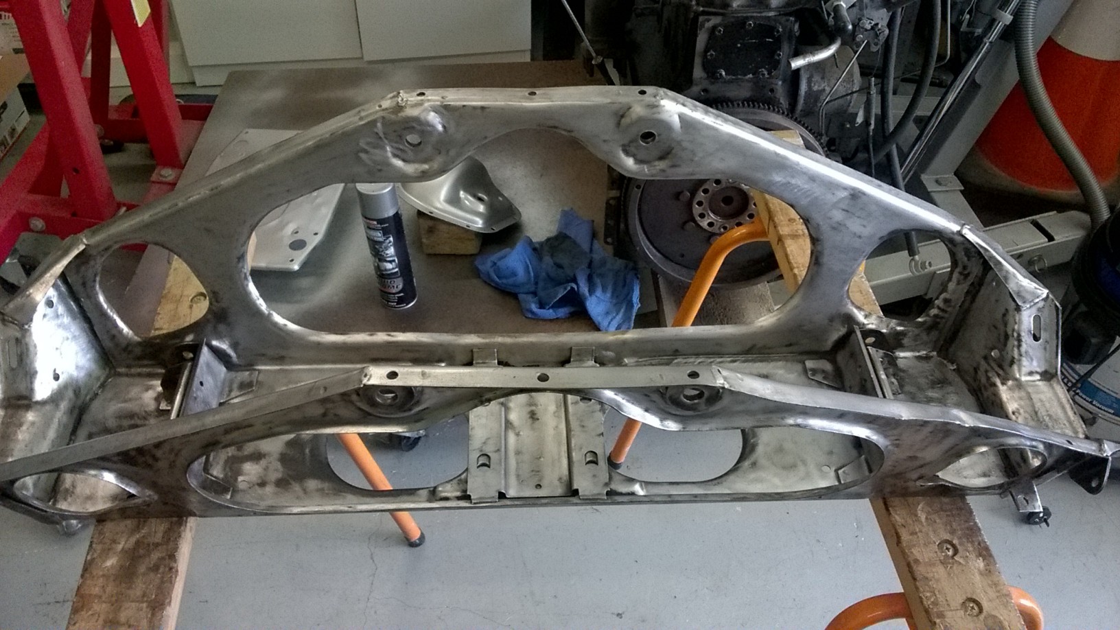

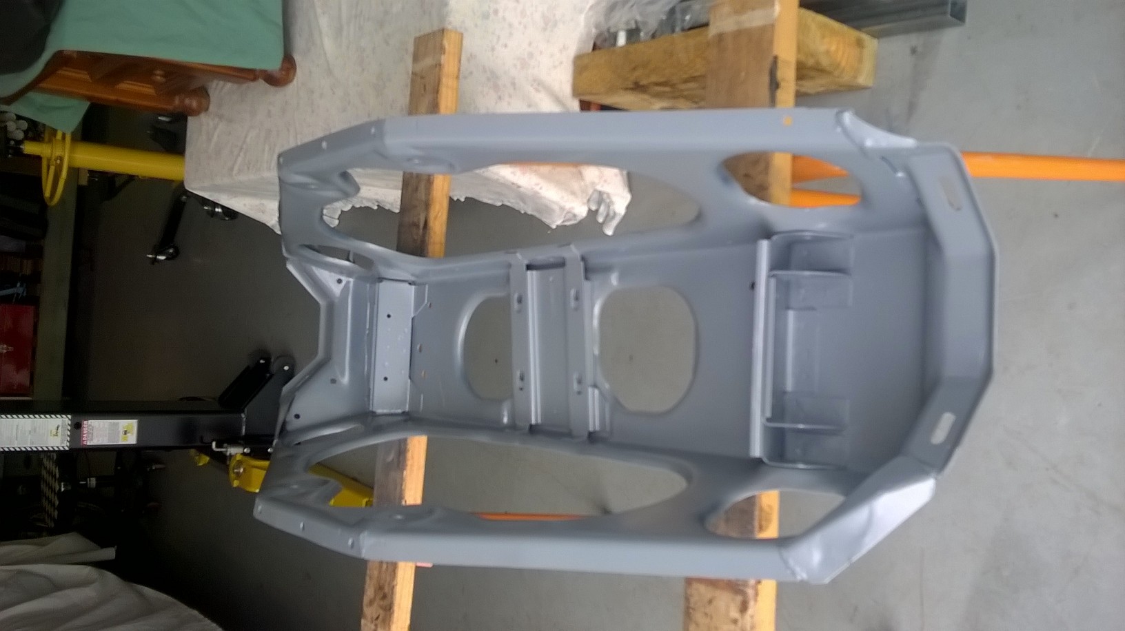

Having some days off at Christmas has seen me in the shed tidying up a few bits and pieces.
1. Stripped the paint and the loose surface rust off the rear crossmember (crossbeam or cage - depending on what you like to call it)
2. Used Killrust Epoxy Gloss Enamel (in black) to prime the surface using a brush making sure I got into all the nooks and crannies (this stage I forgot to take photos). Basically used the Killrust as my base protective coat.
3. I then used a rattle can of grey primer - 2 reasons really, the first to ensure there that there is coverage on all the metal and secondly I plan on using a gloss black rattle can to finish it all off.
the pics you see are before stripping, after stripping and after the grey primer (remembering there is a Killrust black epoxy enamel under it.
Maybe tomorrow I will get to finish with the gloss black rattle can.
Attached Thumbnails Rebuilding a Series 1 rear end-wp_20151226_001.jpg   Rebuilding a Series 1 rear end-wp_20151226_002.jpg   Rebuilding a Series 1 rear end-wp_20151226_003.jpg   Rebuilding a Series 1 rear end-wp_20151226_004.jpg   Rebuilding a Series 1 rear end-wp_20151229_004.jpg
Rebuilding a Series 1 rear end-wp_20160101_002.jpg   Rebuilding a Series 1 rear end-wp_20160101_005.jpg   Rebuilding a Series 1 rear end-wp_20160101_004.jpg   Rebuilding a Series 1 rear end-wp_20160103_004.jpg   Rebuilding a Series 1 rear end-wp_20160103_005.jpg

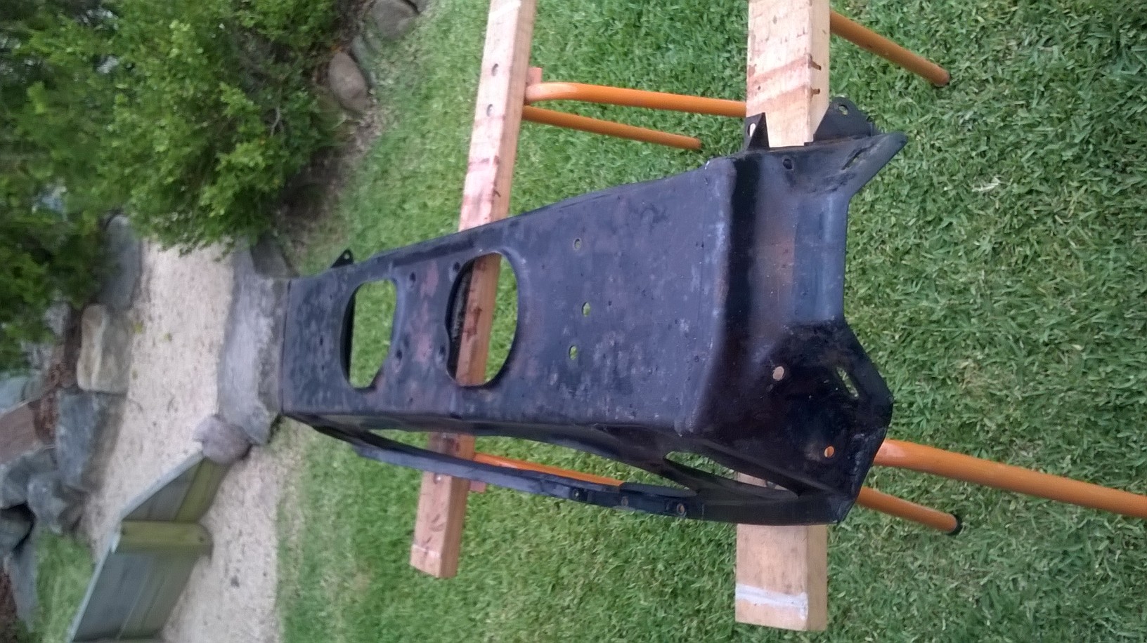

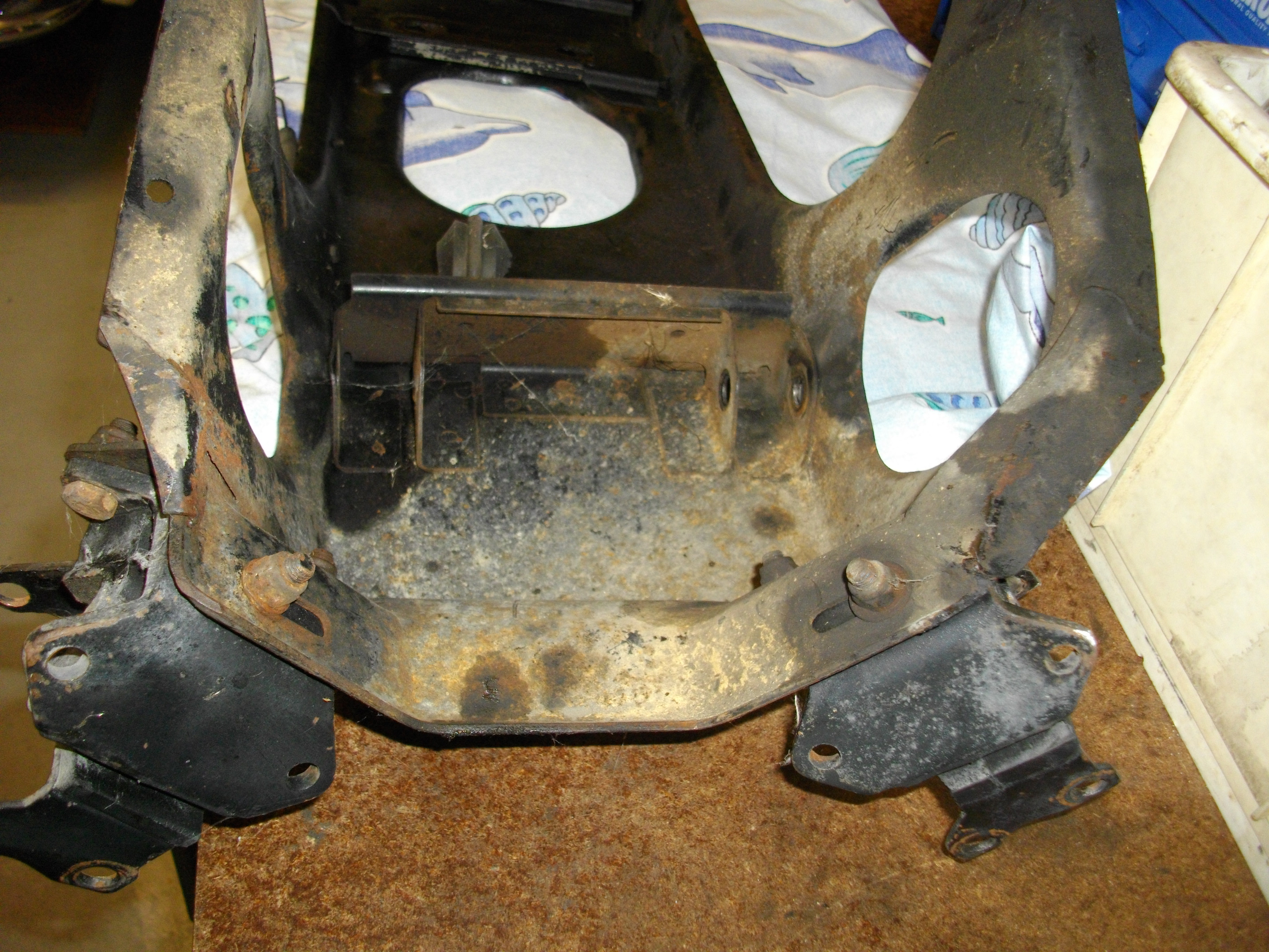

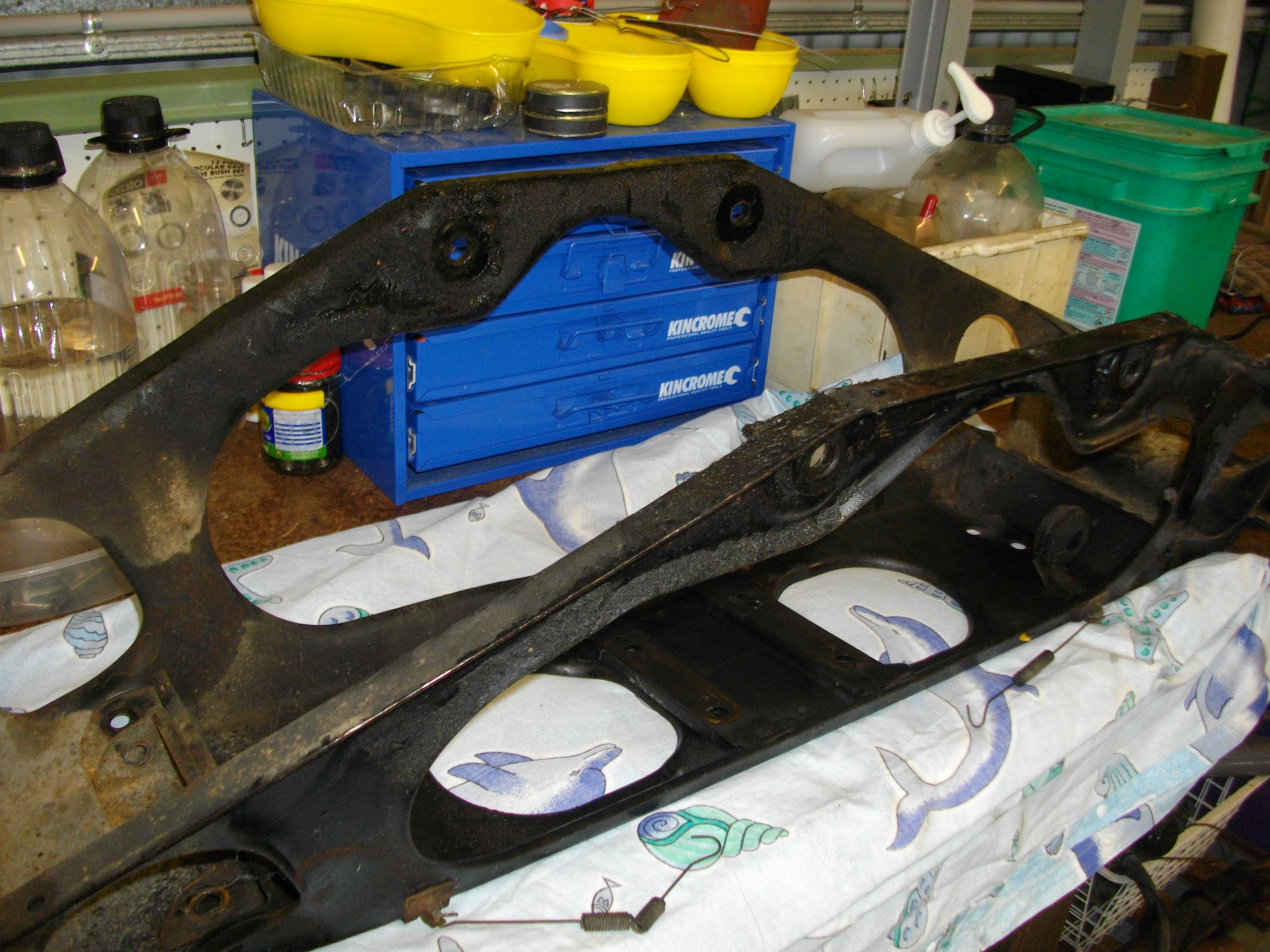

Default pics of the rear crossmember before initial cleanup
Must have been after I pulled most things off
Attached Thumbnails Rebuilding a Series 1 rear end-imgp4328.jpg   Rebuilding a Series 1 rear end-imgp4329.jpg   Rebuilding a Series 1 rear end-imgp4332.jpg   Rebuilding a Series 1 rear end-imgp4333.jpg
