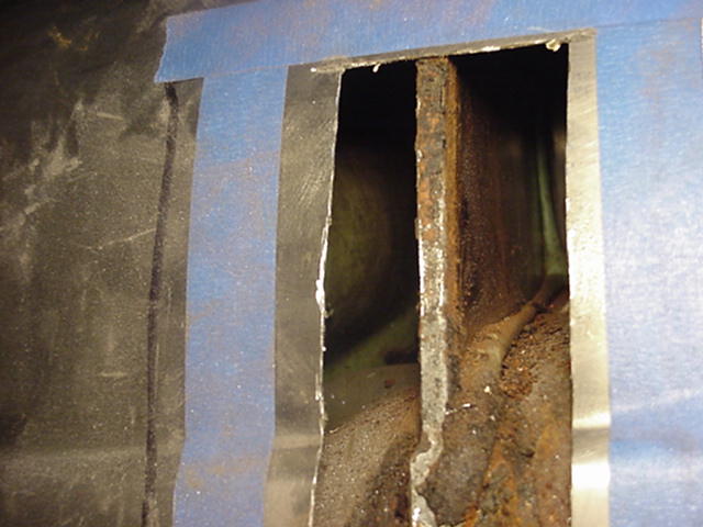

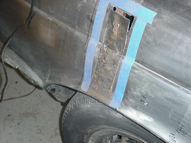

I would recommend (if you have had rear windscreen water leaks - parcel shelf wet etc....) and now you have the tanks out, that you shine a light up into the cavity where the tank was, and see if there is any corrosion on the inside of the outer wing.
Water that has entered from the windscreen corners will run down into the area over the rear wheel and dribble into the spot under the rear seat. Given a long enough time rust perforations will show on the outer surface of the rear wing at a spot below the fuel filler cap and over the top of the rear wheel arch. Having the tanks out make inspection for rust very easy...just look with a light. Replace the short lengths of hose at the filler neck on each tank or you may get fuel smells if they are cracked or not positioned right.
