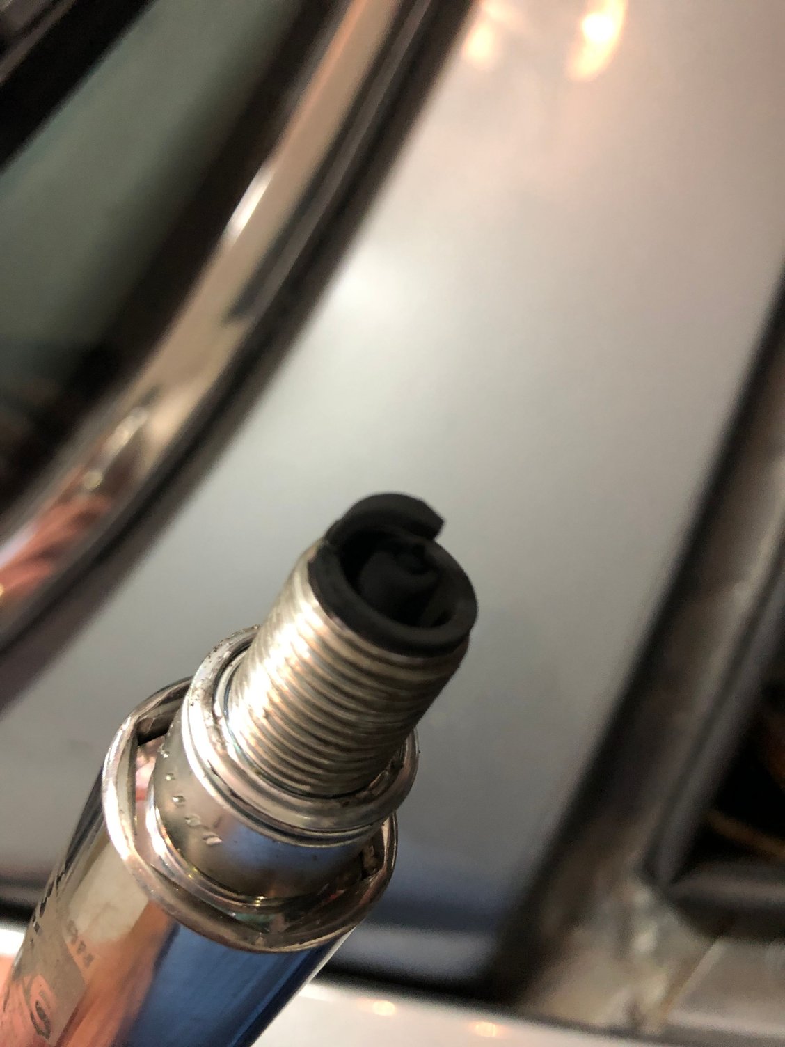

I have a 1987 xj6. It was running beautifully for the last year. Then, the cold start injector failed and was leaking. After I replaced it, the car has been running rich to the extent that it stalls. At speed it does. It stumble, but the exhaust is dark and the plugs foul in a matter of minutes. It seemed that the injectors were also pouring fuel into the motor (open) at all times. Here is what I have done to trouble shoot:
replaced:
All 6 injectors
MAF
ECU
coolant temp sensor (3rd on rail)
fuel pressure regulator
exhaust o2 sensor
cold start injectors
plugs
checked timing
bypasses fuel temp sensor
so far I am stumped. I’ve read so many posts so am open to any ideas. Perhaps it’s not in the injection system?
thanks! Robbo

Old Aug 31, 2019 | 11:00 AM
Robbo9's Avatar
Joined: Feb 2019
Posts: 17
so I changed the thermotime switch and disconnected the cold start injector...no luck. Going to check the fuel pressure next and if not the problem, tear into the air intake and throttle body. Continue to be baffled!

Update - an adjustment and cleaning of throttle body has it idling albeit rich but running. Updated symptom - When I was cleaning the throttle body, there was fuel in the base of it. So - I suspect I will need to get a good check of the fuel pressure. Any other ideas?
