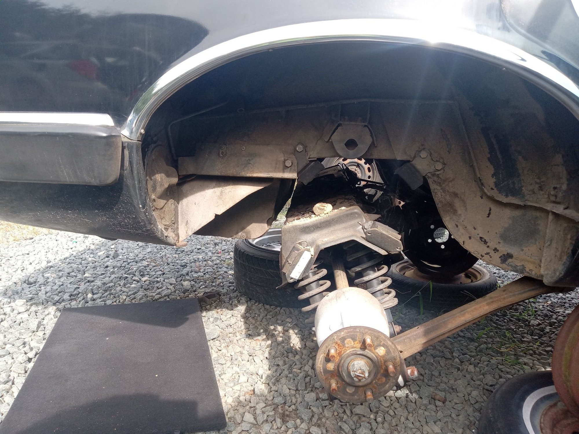

Here's a picture of one "in the wild" after I pull the exhaust system at a U-pull yard. the only thing holding it now are the radius arms and drive shaft ( the brake hose is still hooked up but I wouldn't count on it to hold anything ).
Just keep this in mind when jacking the car but especially using a lift or grabbing parts at a yard like this. Could get trapped or crushed without anyone to help !
